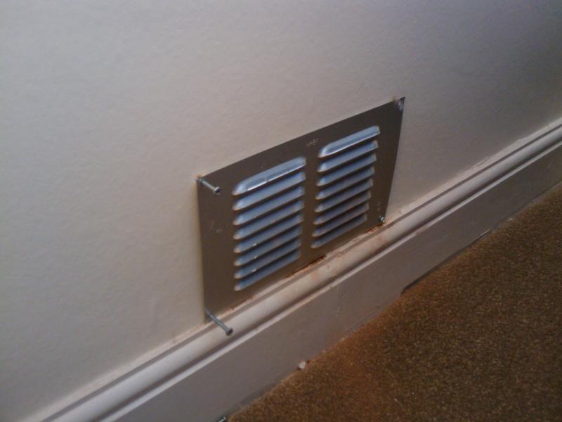

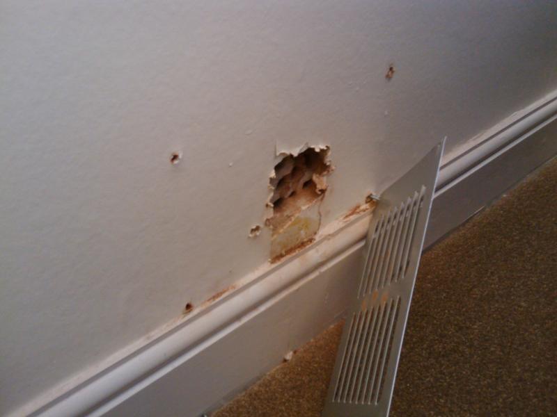

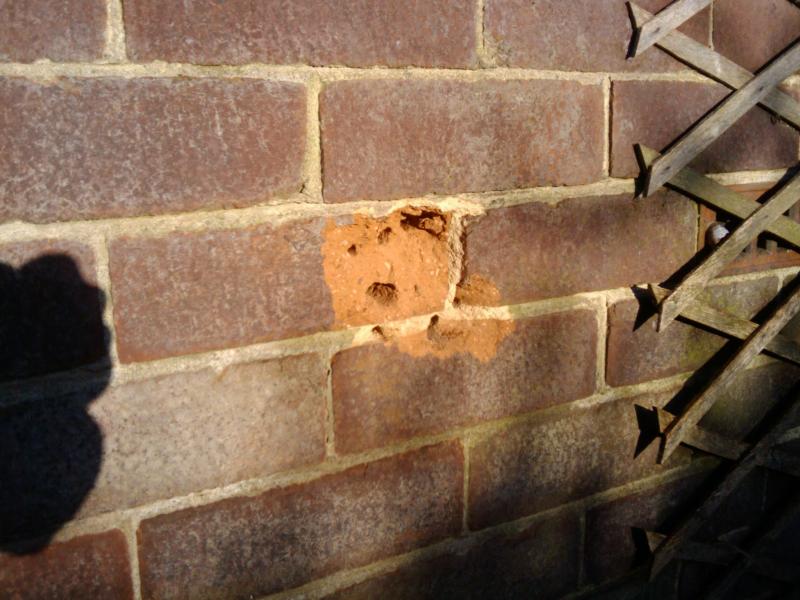

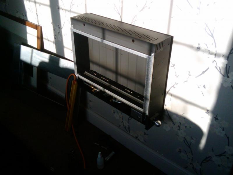

I've done 8 landlord gas inspections on flueless gas fires and each one has had to be capped for one reason or another.
Main faults:
Permanent vent not big enough
Permanent vent wrong type of vent
One was producing stupid amounts of co
And this is one the customer fitted themselves.
Enjoy.
Nice vent. Looks roughlY like the minimum 100cm2.
And the gas leak was approximately 20mb in 5seconds.

Thank you-- just goes to show that people did not follow manufacturers instructions .
Conclusion is- if instructions are followed and pressures etc are checked-- everything will be ok.
So- maybe time people stopped knocking flueless fires and concentrated on knocking some of the monkeys who fitted them.
Hey- a car can be perfect-- but if a monkey is driving it- it can/will be a lethal weapon.
