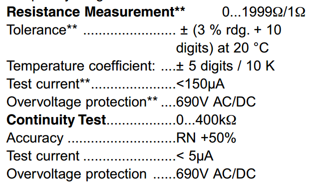

Someone asked me about an issue he had had with testing for 'continuity' using a Fluke T50 Voltage/Continuity tester. In essence, he was getting an indication of 'continuity' when he wasn't expecting it, and it seemed probable that the explanation was that there were probably some 'connected loads' whose resistance was being measured/detected by the tester.
This led me to wonder how low the resistance had to be for this device (which apparently has a 'bleeper' and just one 'continuity LED') to declare 'continuity'. The user manual is not all that clear, merely indicating that the 'resistance range' for continuity testing is 0 - 200 kΩ. If that means that it will indicate 'continuity' (bleeping and lighting up its LED) with a resistance as high as 200 kΩ, that would seem to be verging on the ridiculous, and rather limiting its value as a useful 'continuity tester'.
I wonder if any of you have, or know about, the T50 - and, if so, if you know what is the maximum resistance that it will interpret as 'continuity'?
Kind Regards, John

Other things unclear.
This is from the fluke 100 range:
Why the difference in upper limits between Resistance and Continuity?
Remember this is not a switchable device; it auto-detects and not all of the range has an lcd display just an led ladder..
Also, the accuracy is 'RN+50%'

Actually the devices with resistance measurement (**) and lcd do have a button to press.

Hmmm - well, if it means what one might think it means, than 400 kΩ for 'continuity' is even worse (IMO, 'even more ridiculous')than 200 kΩ!
You tell me! Is 1,999Ω perhaps the highest quantitative figure that can be displayed on the LCD, after which one just has the LED ladder?
Whatever that might mean!!

What happens when you 'press the button'? I see that 'Test Current' and 'Overvoltage Protection' also have "**" !
Kind Regards, John
Bizarrely it stays on resistance measurement and display for twenty seconds.
The ** relates to the models which include the resistance measurement facility and 'The 'Test Current' and 'Overvoltage Protection' apply when on resistance measurement.

Fair enough. Do I take it that this means that my previous suspicion is correct and that 1,999Ω is the highest resistance that the LCD can display?

Do you have one of these? If so, are you in a position to determine, roughly, how high the resistance can be for the thing to still report "Continuity=Yes"? Is it really anything like as high as 400,000Ω ? (As I've said, from my viewpoint, even 40Ω would really be too high!).
