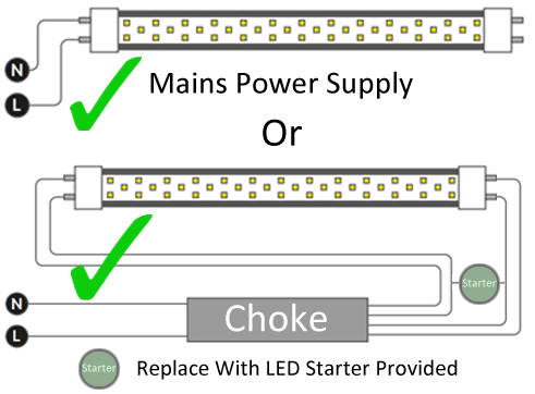

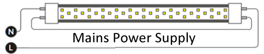

I found this picture.
It does not take much to see the problem with the top picture, yes it will work, but with the tube I got the other end of the tube has the two contacts short circuit, so put the tube in wrong way around and you have a direct short. It needs to be wired this way
So it does not matter which way around the tube is inserted where the second diagram comes from I don't know as wire wound ballast normally only have two connections, and HF ballast would not have a starter this was the advert and it worries me that they put up diagrams like this which to be fair may be correct for their special tubes, but there seems to be no universal method of fitting LED tubes in fluorescent fittings.
