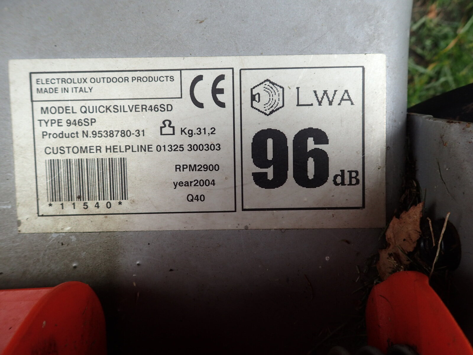

Fylmo Quicksilver 46 SD Briggs and stratton engine, unable to see engine number.
Just picked one of these very neglected !
Air filter blocked completely wash with petrol but it's beyond keeping
the mower runs but hunts black smoke at times,
would this need a Diaphragm ??
Looked on web and they all look the same Briggs And Stratton Diaphragm.
Would this be correct or is there a difference .
Thanks for any help.

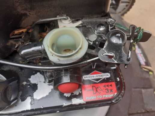

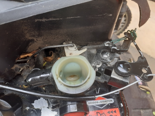

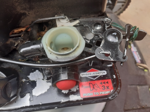

Info sticker.JPG Carb.JPG Tab Should this bent down.JPG Please see attached photos
Should the throttle auto adjuster have a bend to stop it going the full way ?
Pic of carb ( now it's had a gunk wash to remove soil and grass )
Pic of info plate.
Dose the wheel drive need any oil / grease ?
Looks like a Grandad shed project to keep me busy.
Thanking you for your help
The engine looks like its a fixed speed variety, rather than one that is fitted with a throttle cable - therefore once the machine is running you can lock its run speed by bending the lower of the two brackets you can see.....in real life this may not be necessary so get the machine starting and running well first.
Another couple of things to watch....
You see the rubber elbow on the crankcase breather pipe? That also works the fuel pumping system and needs to be air tight - a cable tie or two works fine here.
Once the carb has been repaired with a new diaphragm etc, watch for the jet of fuel (air cleaner off) when you push the red primer bulb. The engine will start after one or two pulls on the starter.
It's a good move to remove the top fan cover as you'll find the fins caked in dirt, more than likely and this can cause local over heating. You'll also see the wind vane governor lever which should be free to swing.....that connects to the throttle linkage.

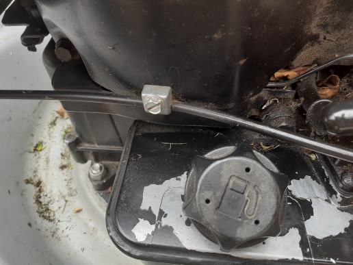

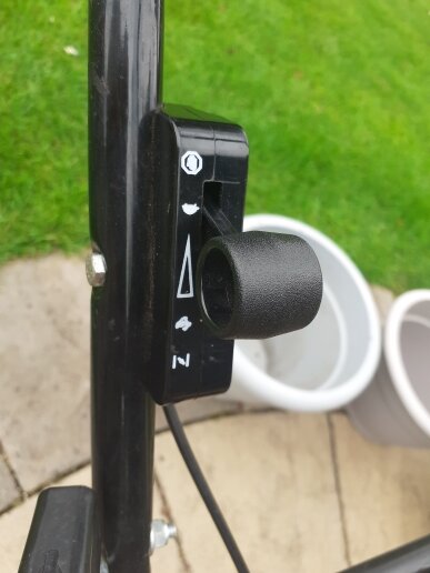

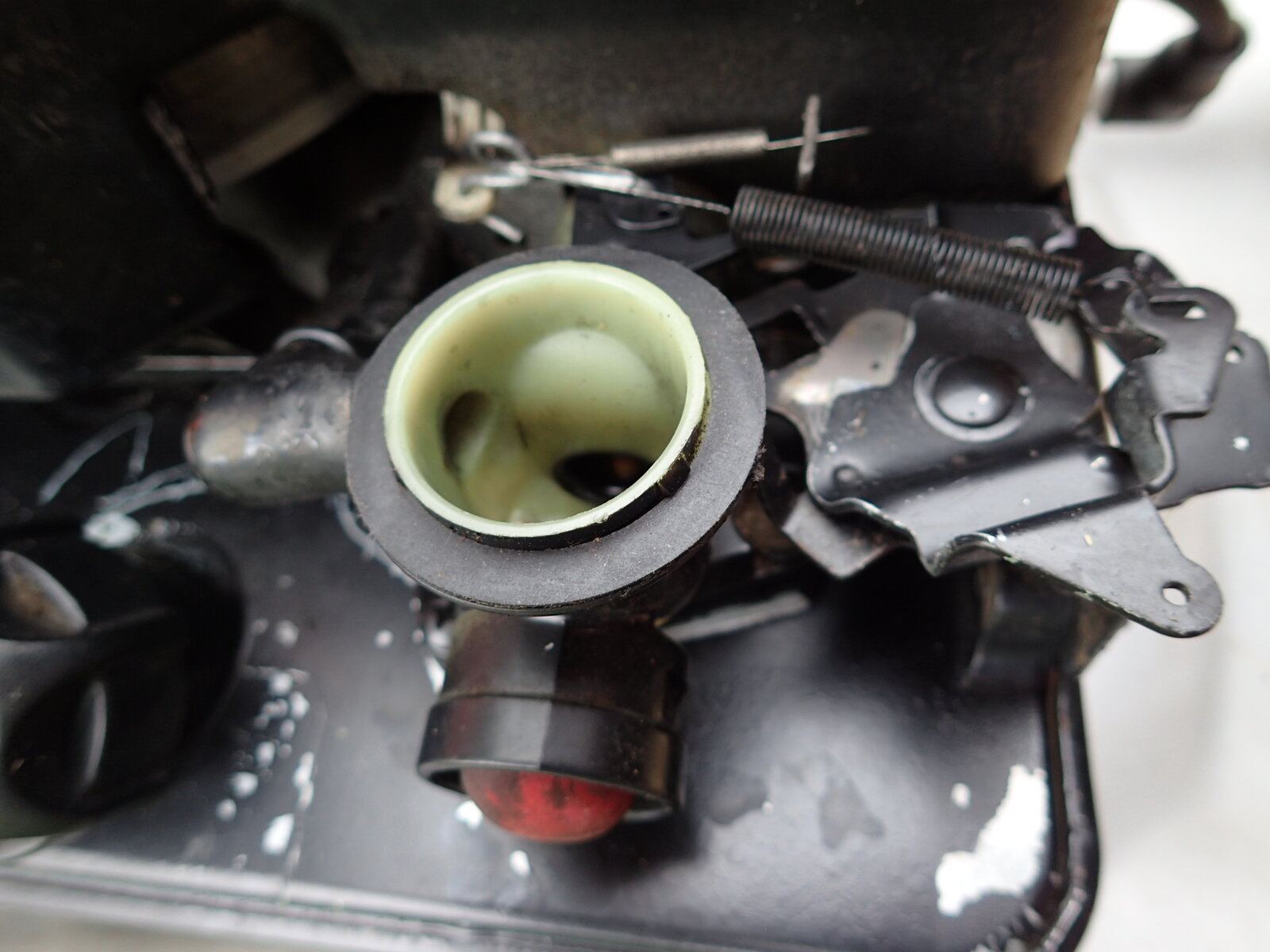

Don't know if it helps, but the carb looks like the one on my Sealy lawnmower, with a Briggs & Stratton 500 engine.
It's a fixed speed machine. But I tweaked it to variable speed (with a limited range) by adding a universal throttle cable and control from eBay several years ago. See pictures. I worked out which lever on the carb altered the speed, all the required fixing holes etc were already on the machine. Great little engine, 3 pumps on the primer, 3 pulls on the starter rope and off if goes. Restarts on a warm engine just takes one leisurely pull on the rope handle.
