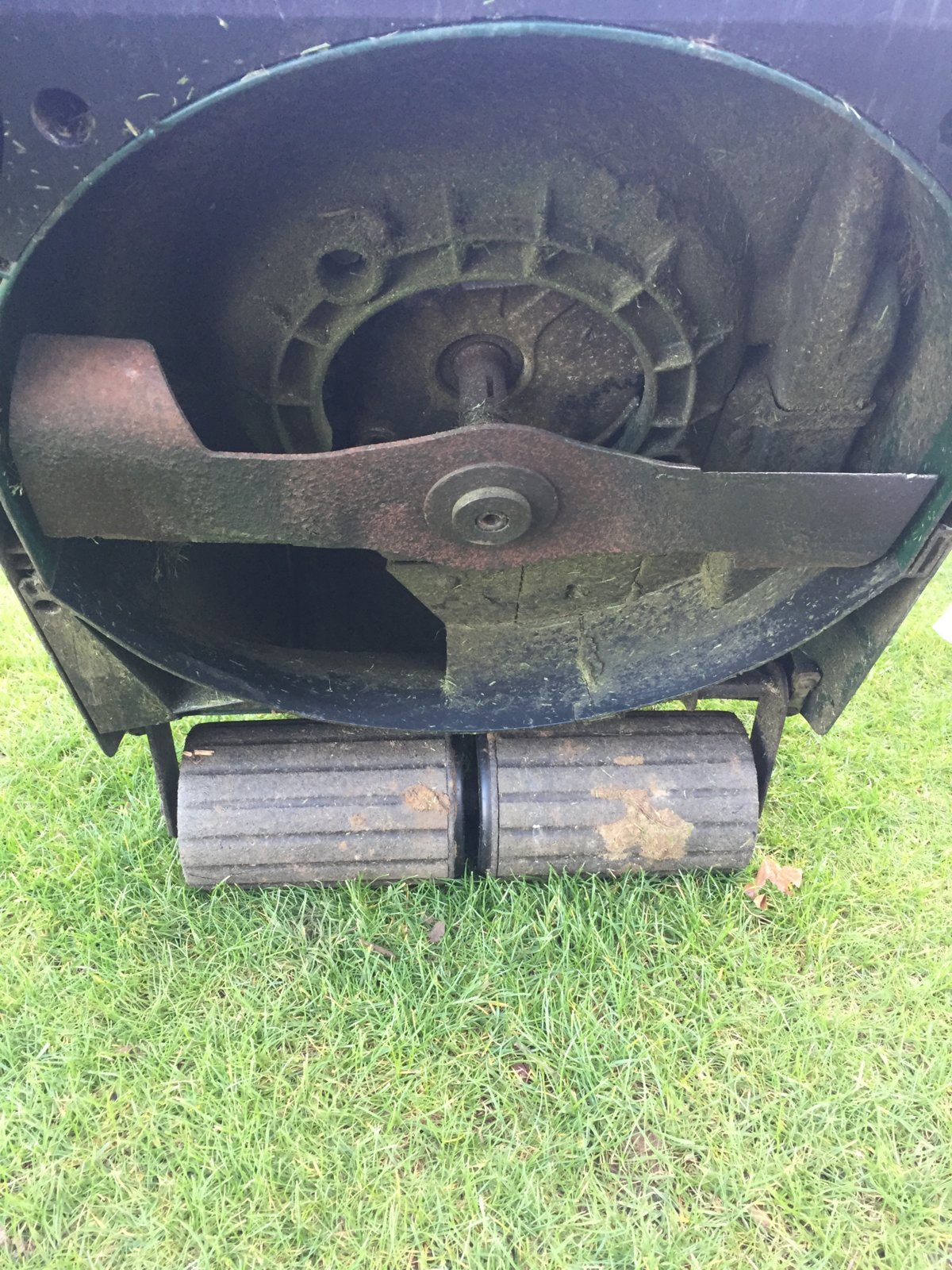

Which direction does the Allen bolt open in please?
The same direction that the blade spins in
Edit: I would advise against using a bent type key and get yourself a proper socket type that you can hit straight on to drive it well into the bolt head. if you use the former type,its easy to damage it.
Thanks so much for the prompt response. That’s anti-clockwise in my case but it’s not shifting at all. I applied some lubricating oil and hammer taps on Allen key - no avail.
Do I need to use a bit with my impact driver?

The hex bit arrived and I could only use with my Makita drill/driver (not impact driver). This wont shift it either. I am at a loss with this...
Any suggestions gratefully received.

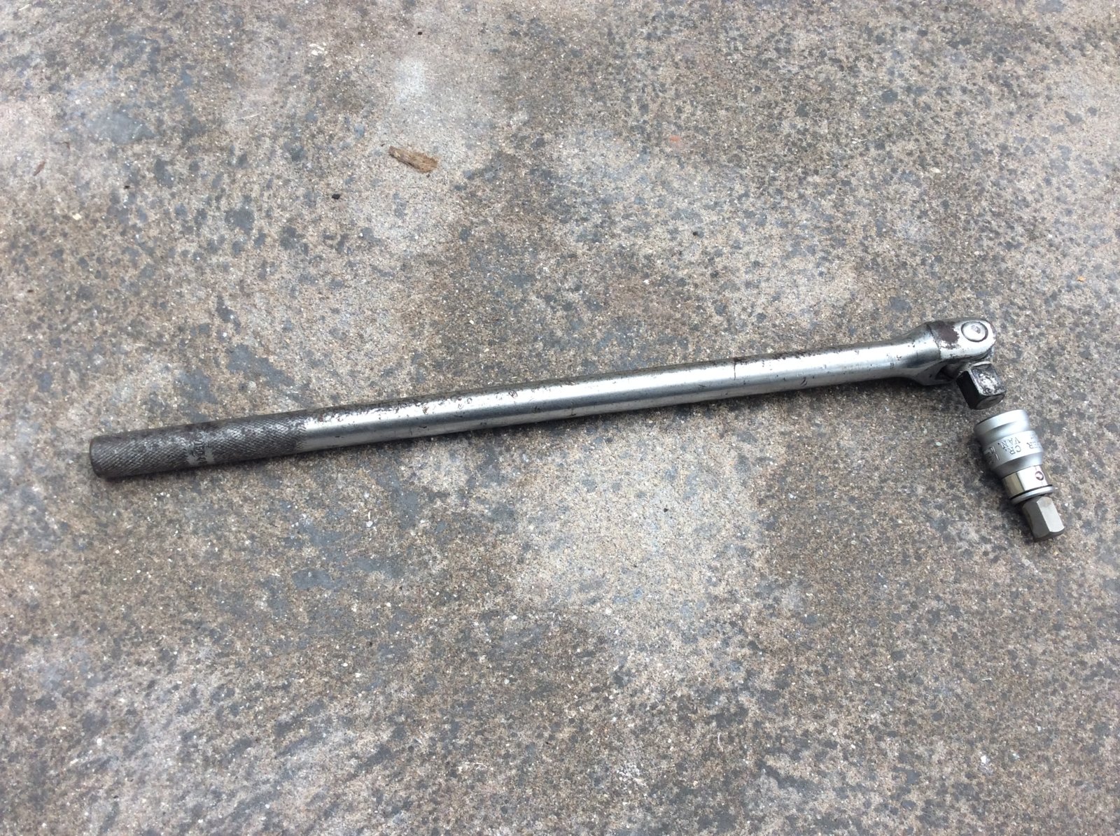

Dig out all of the grot thats in the bolt head, tap in the tool above into the screw head.
Secure the blade with a chunk of timber and have someone support the deck as you use two hands to turn the bar.

Thanks guys. A couple of questions please:
- I assume the above requires me to purchase a ratchet? And there’s are no fittings that can work with my existing drill/driver or impact driver?
- I don’t understand how the ratchet method would exert more torque than my drill/driver (albeit with the wrong bit!) is currently. For clarity, even when my Makita is on high speed and full torque, the bit isn’t spinning freely - it just isn’t shifting the Allen bolt.
Hope that makes sense and appreciate your help
You'll need a bar of some description or a ratchet bar will be fine.
The electric tool just doesn't have the oomph to shift the bolt.
John :)
