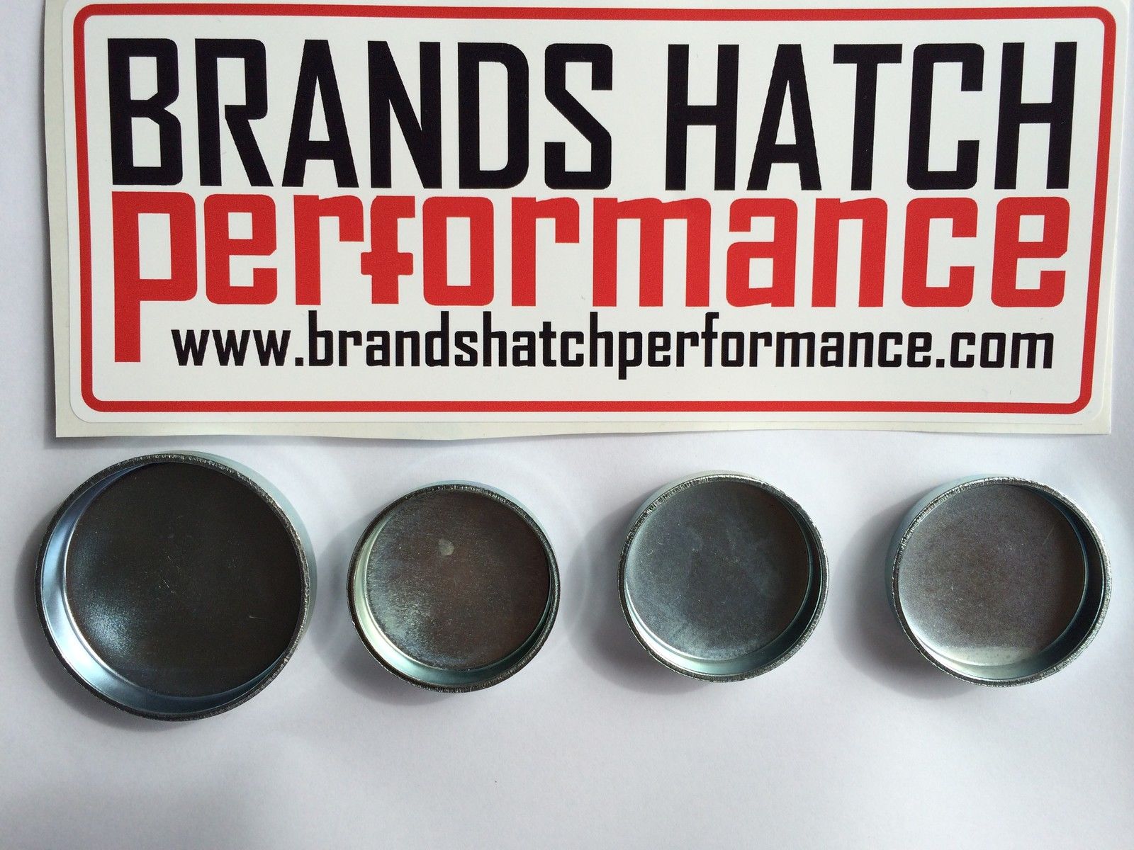

I have a leak on the ford fiesta v reg, coming from the right side of the engine, A little circle hole, some rust in there pics are below, Had the thermostat removed not so long ago.

John (Burnerman),Looking at the OP's photo it looks like a core plug to me. What do you think?
Just looking at this on a larger screen, and you could well be right - nice one!
It certainly looks like the cast iron block, behind that hose!

Could you advise me on,a step by step way to repair found the partd on ebay for £5
If it is a core plug you wish to replace, then drain the coolant first and then remove everything near the problem area.
To remove the old plug, punch a hole through the centre and lever it out with a screwdriver.
To refit, thoroughly clean the core hole and dry it.....apply some sealant to the hole lip and new plug and carefully tap it home.
If the plug has a slight dome, flattening the dome with a broad punch expands the plug tightly in place.
You need to be able to access the core hole square on so as not to distort the new plug.

Yes, they are core plugs, right enough. As for sealant, Wellseal is great for high temperatures.

Cheers for the advice done the job just gotto hope it holds up, Halfords wanted £60 an hour to it!!
