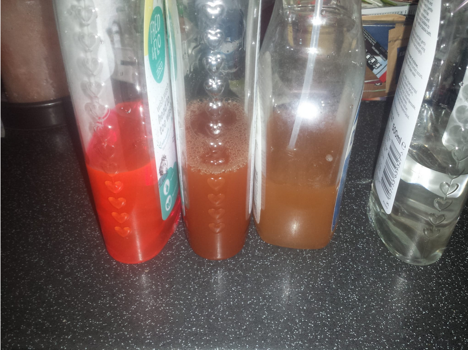

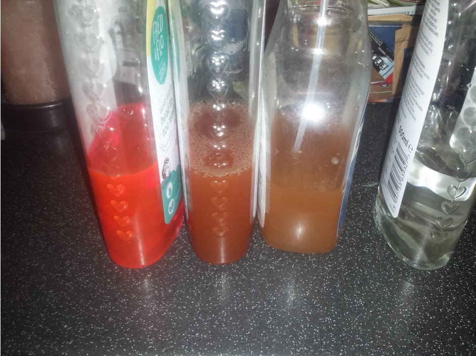

Update:
Flush going well. I emptied the water I filled it with last time after a bit of driving and it came out brown, then decided to do the rad flush with a hose.
I also put the hose in the top hopper and flushed from there, and kept going until the water was coming out clear.
This is the result..
What it should be on the left for reference. Then first flush, second and after a hose through the rad.
I'm still going to do another flush or two after running the engine.
