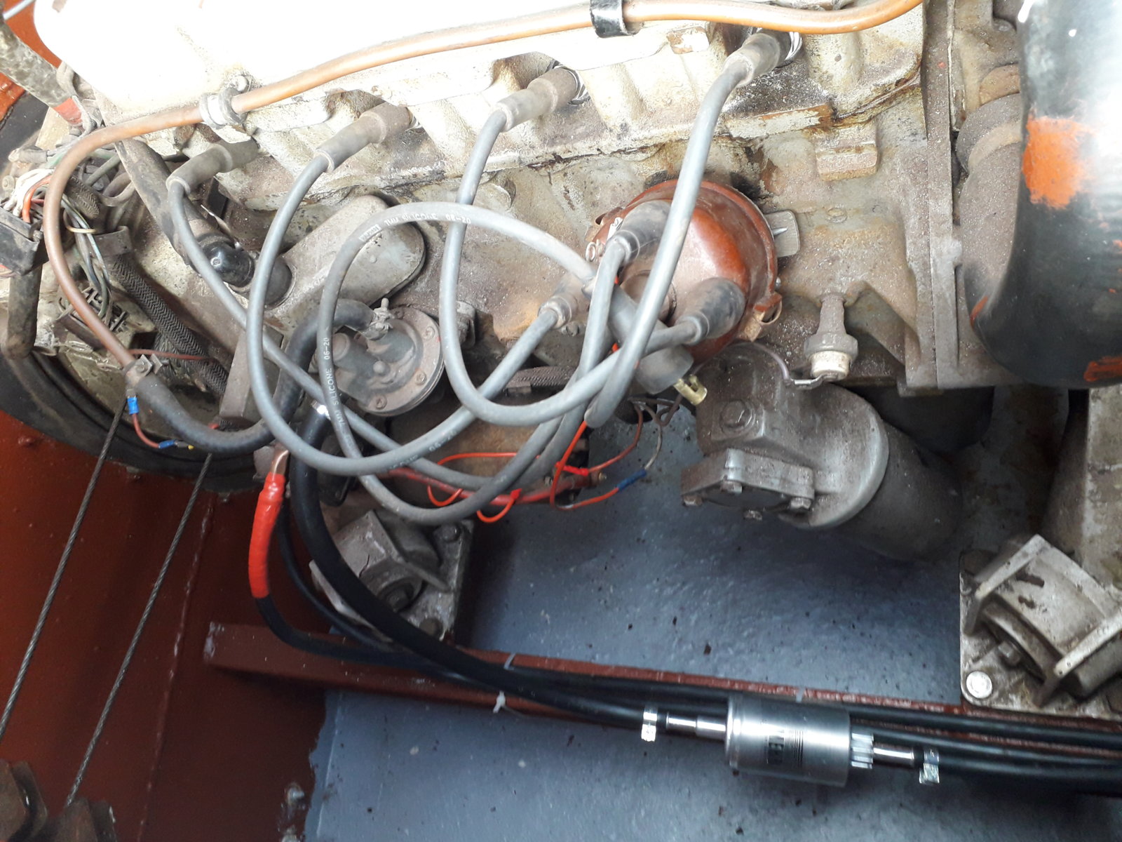

A spark at a plug in the open needs less power than a spark under compression. You'll need the right type condensor, probably Bosch although you could mount one externally. Coils are a bit easier ,depends if you have a ballast resistor or not. People do say modern condensors aren't much good so is there any chance of fitting electronic ignition? Let's see a photo of the engine and distributor.

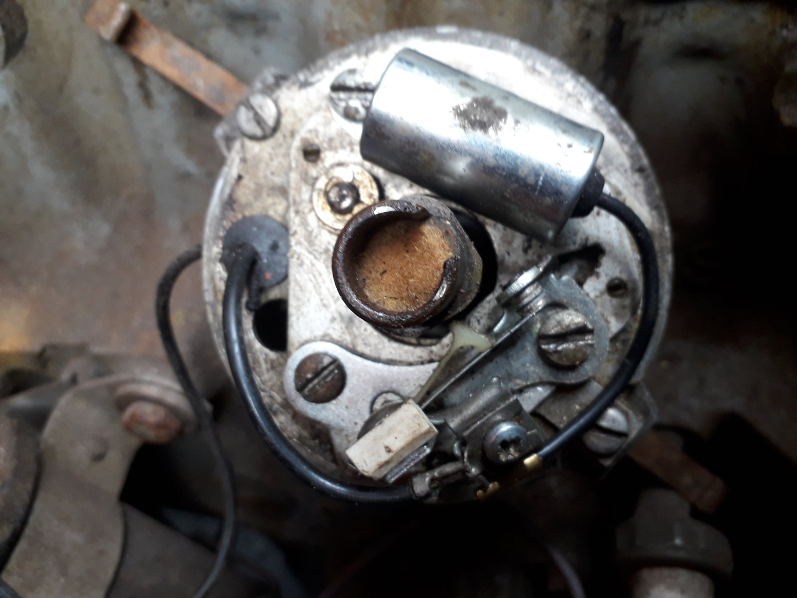

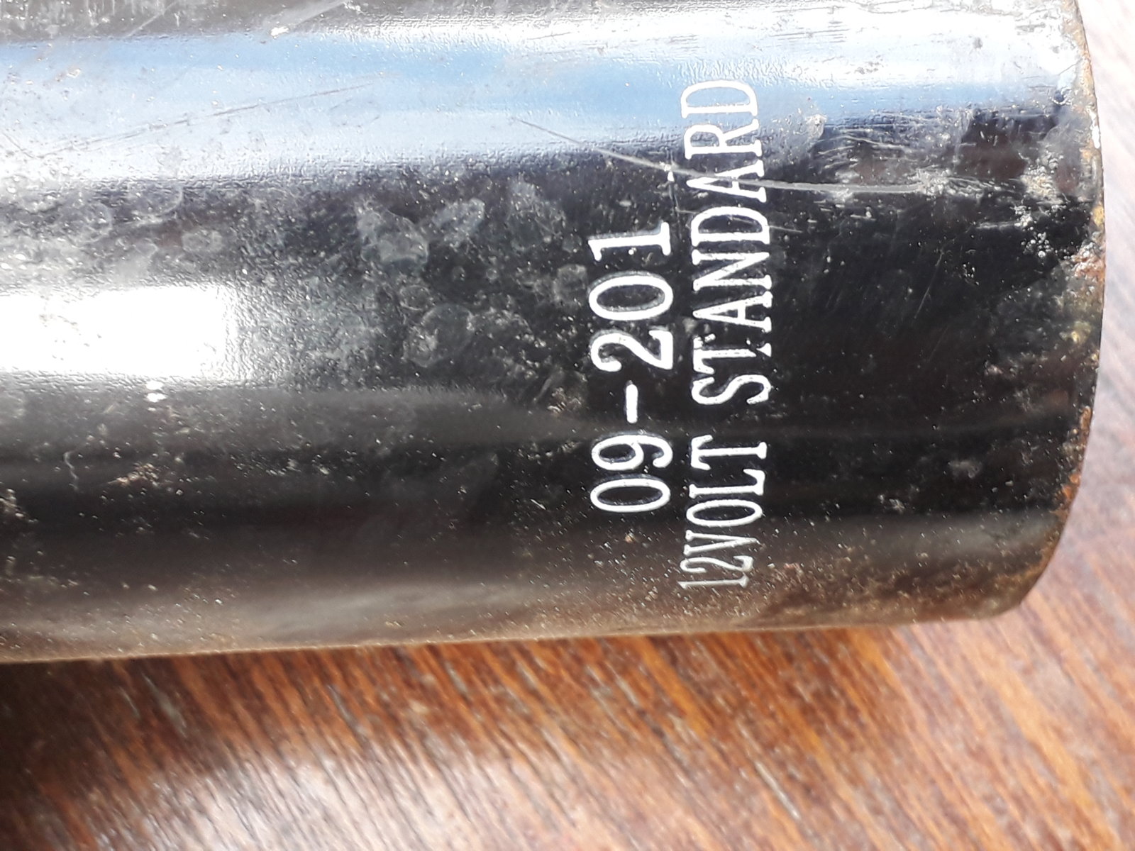

20180612_182517.jpg 20180612_182838.jpg 20180612_181700.jpg 20180612_181714.jpg Just got back from the boat
Anyone have any idea what parts I need ?
Engine looks similar to a Ford pre cross flow and distributor is I think a Motorcraft, Ford's own make, There are 2 types of points , depending on which way the shaft turns . Condenser would be the same. Have a look on EBay for parts for Ford classic cars, Motorcraft points and condensers.
With the new points in, slowly rotate the engine using a spanner on the crank nut or whatever and set the gap to 15 thou. Apply a spot of grease to the cam to keep it that way. With the rotor arm in place you should be able to rotate the cam a few degrees because of the advance / ****** mechanism below. A drop or two of oil on that felt pad lubricates this.

If I remember correctly, there were three different types of distributor in old British Fords. As yours is a German Ford it narrows it down to two; Ford or Bosch. The Bosch points gap on Bosch distributors was 20 thou and if it was a ford distributor the gap was 25 thou.
Generally, Ford distributors had a black cap and Bosch had a red cap. Looking at yours, I'd say that it is a Ford distributor.
Yes, it's one of Ford's own dizzies. Motorcraft was the name they used, previously Autolite. 25 thou gap. I think the different rotations were between OHV and OHC (Pinto) engines.
Do check the rotor arm condition, and check the carbon brush is still in position in the centre of the distributor cap.
