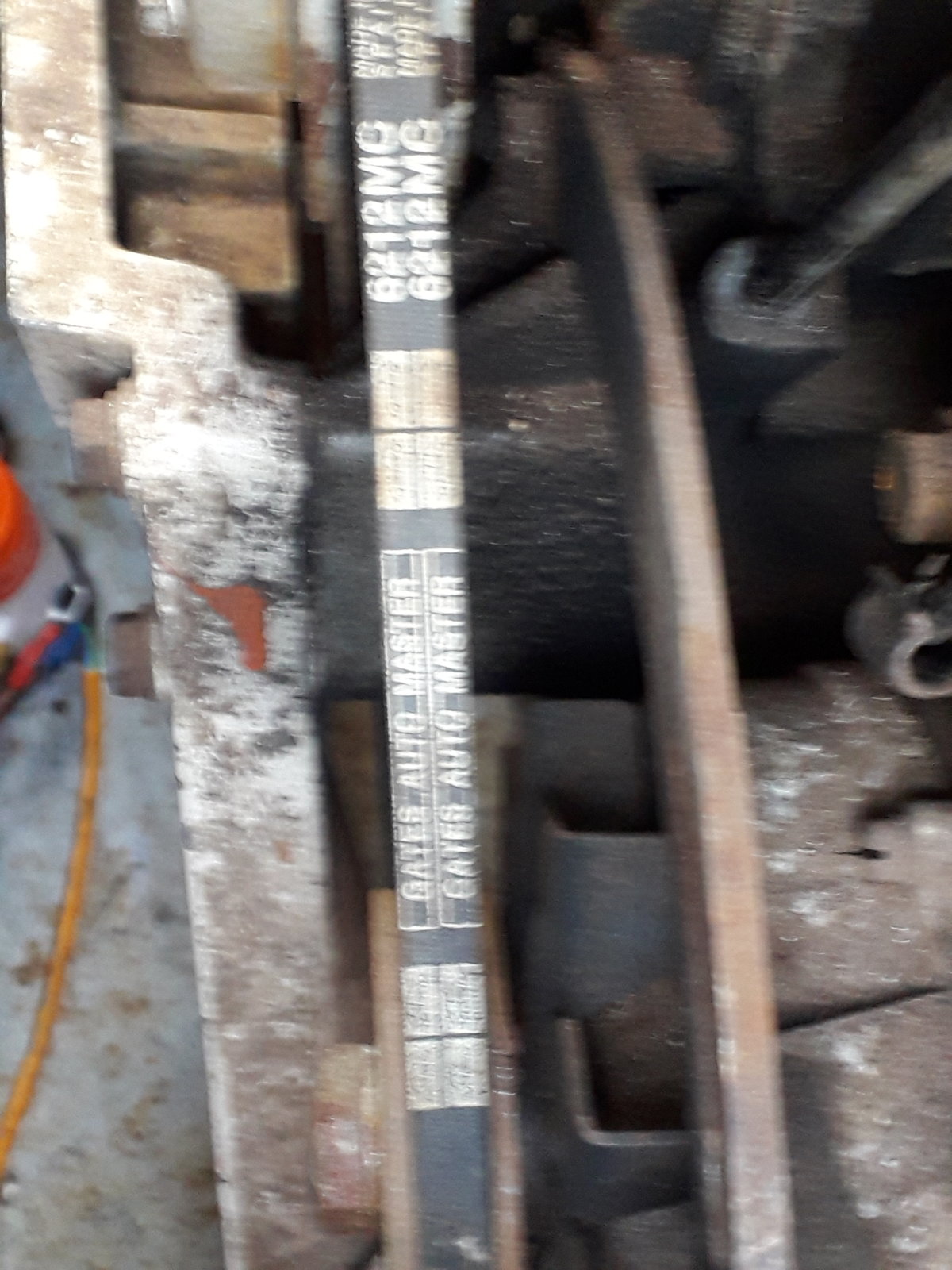

I also need to replace the fan belt but I'm not sure what one to order ?
Any ideas?
Sorry it's not that clear.
Oh and the distributor had a red cap.
Belt here https://www.ebay.co.uk/p/Gates-Fan-V-belt-10-X-800-Mm-MAZDA-RX-7-II-1989-1991-6212MC/1523191718

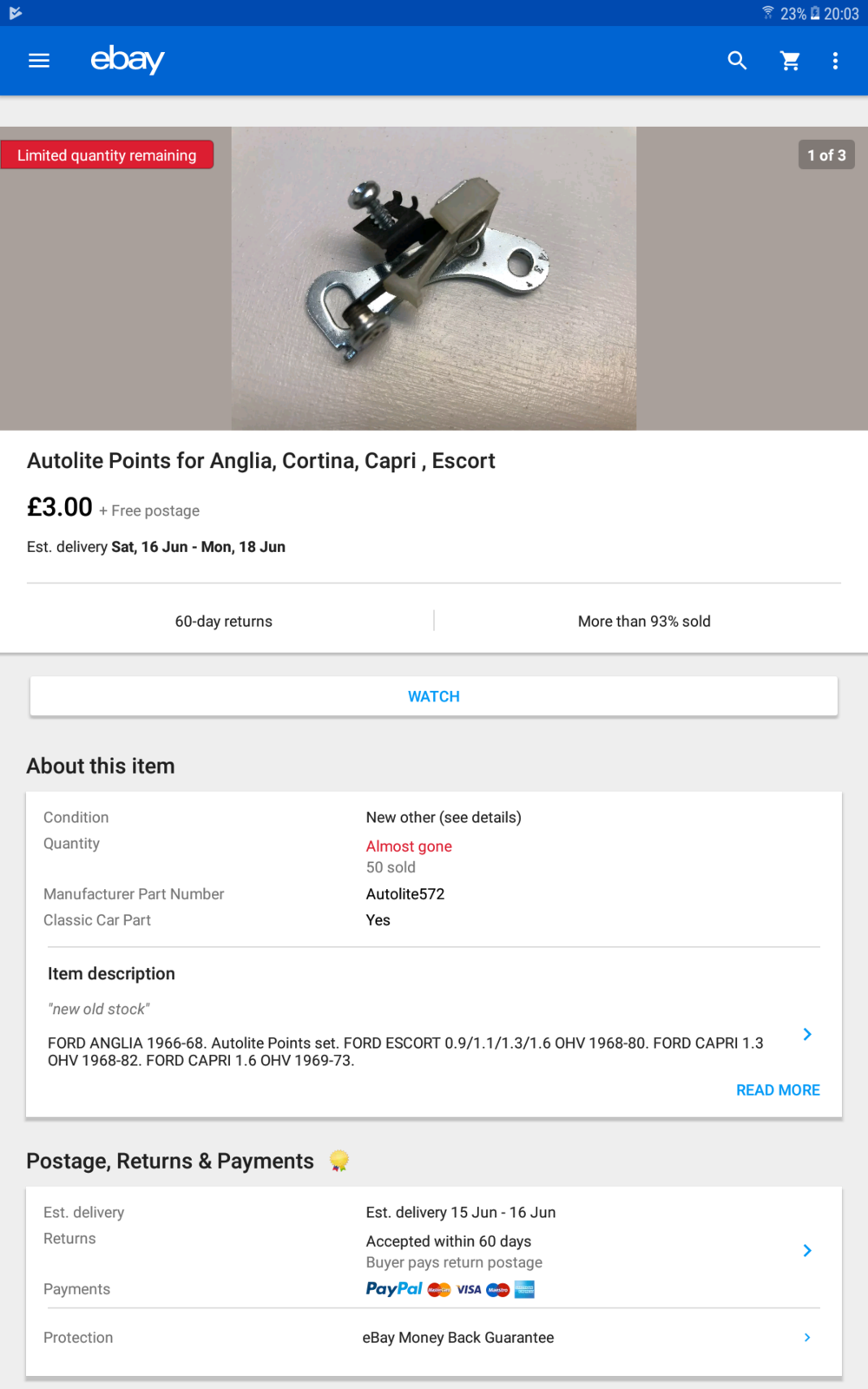

Points are Intermotor 2273 and the condenser 3379 also on eBay.

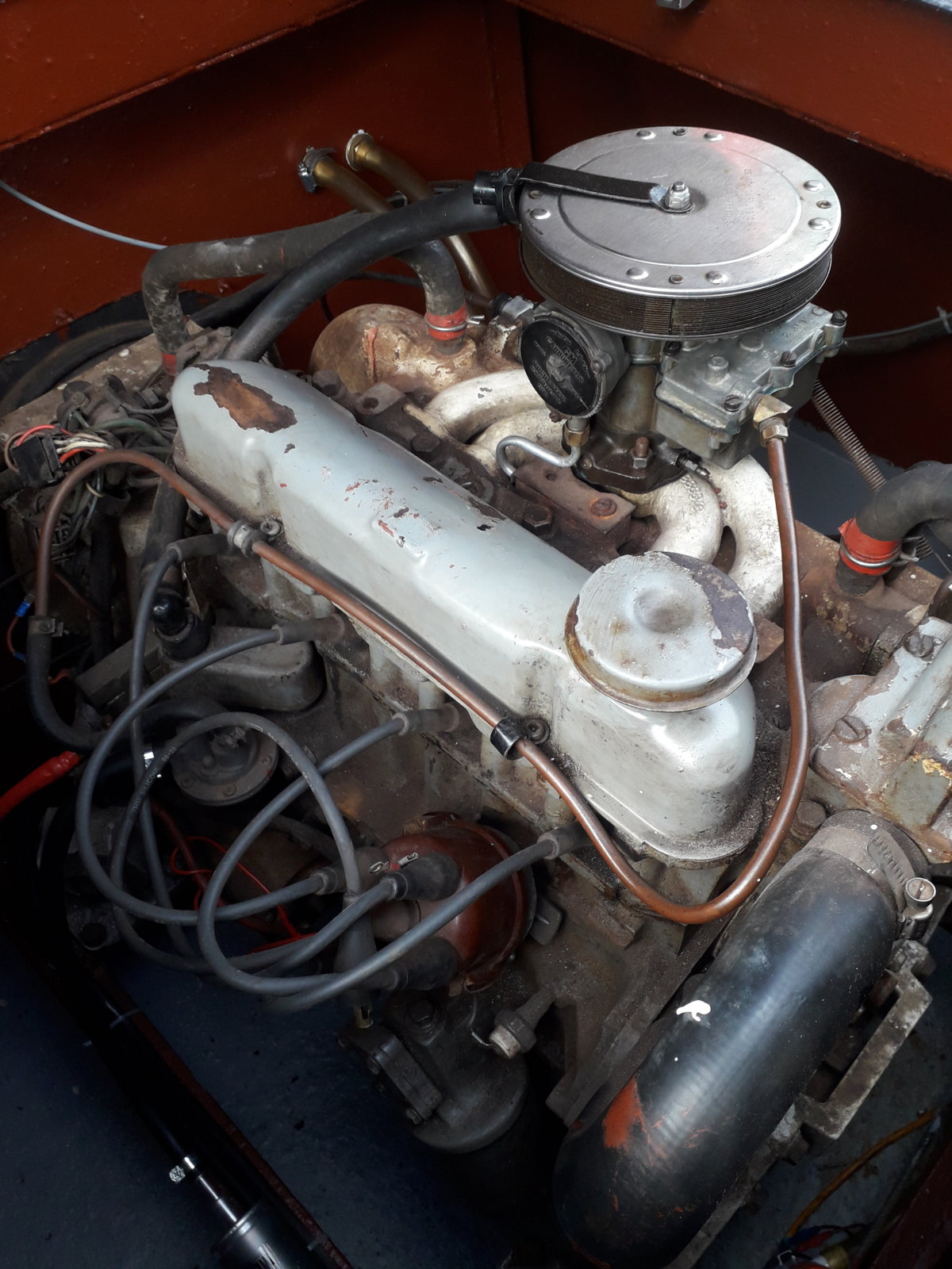

That pre-crossflow engine would have originally had a Lucas distributor but it’s been changed for a later crossflow distributor. Wouldn’t do any harm fitting a later cross flow oil pump and filter either. The red distributor cap confuses me - that’s normally a Bosch distributor but you definately haven’t got one of those. You shouldn’t have a carbon brush on the distributor cap, on that distributor the rotor arm is sprung.

I have also ordered these points
I only ordered because they looked the same and I had no part number

I'm just hoping that all of these replacement parts are compatible with one another.....I remember the Motorcraft distributor well but don't ever seeing a red cap, even as an aftermarket item. I also didn't trust Intermotor parts but that's only my opinion.

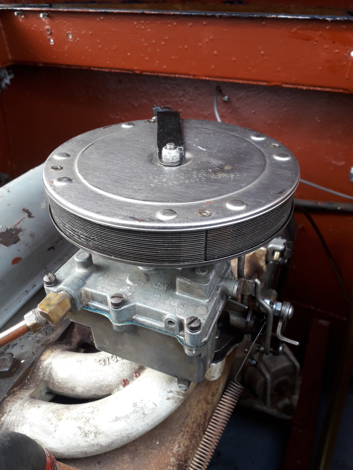

Also give us a shot of the carb if you will - some (Solex) had a drain screw. You can test for any fuel contamination by cranking the engine with the fuel line pumping into a bottle.....any water stays at the bottom.
