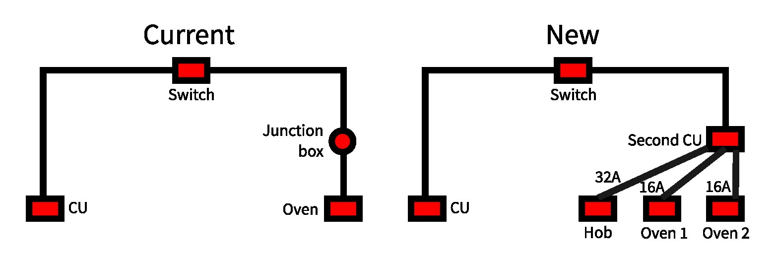

I'm in the process of a kitchen renovation, which will include me doing four electrical jobs. I *think* I know what I need to do but I'd be grateful if you could check my homework before I go any further.
1) I'm replacing an electric range cooker with a separate hob and two ovens. The maximum load of the old range was 16,485W while the three new appliances combined are 13,650W so, as I never had any issues before, I'm planning on sticking with the current 4mm circuit wiring and 32A fuse in the consumer unit. However, the specs for the two ovens note the need for 16A fuses so my plan is to add a second consumer unit after the oven switch and then connect the two ovens to two 16A MCUs and the hob to a 32A one (given it's 7,350W by itself). The diagram below explains the plan. This might be overkill but is it OK? The second consumer unit will be hidden in a cupboard so I'll keep the oven switch on the wall so I can quickly and easily isolate the appliances if needed.

Hum. If you do plan to get a spark to “test” then find them before you do anything as the vast majority of us won’t touch this type of diy work
Good luck finding a 16A fuse that's appropriate for use in a domestic environment.
None of that is required.
Connection plate at the location of each oven and the hob. Cable from the switch goes to the first one, then the second, then the third one.
Hob connected with 4mm² HO7 flex, ovens with 2.5mm² flex.
As the spur is fused, am I right in thinking I can run three sockets off it?
Yes, but it's a poor design as the total load for all of the sockets can't exceed 13A, and in a kitchen that it likely to happen quite often.
