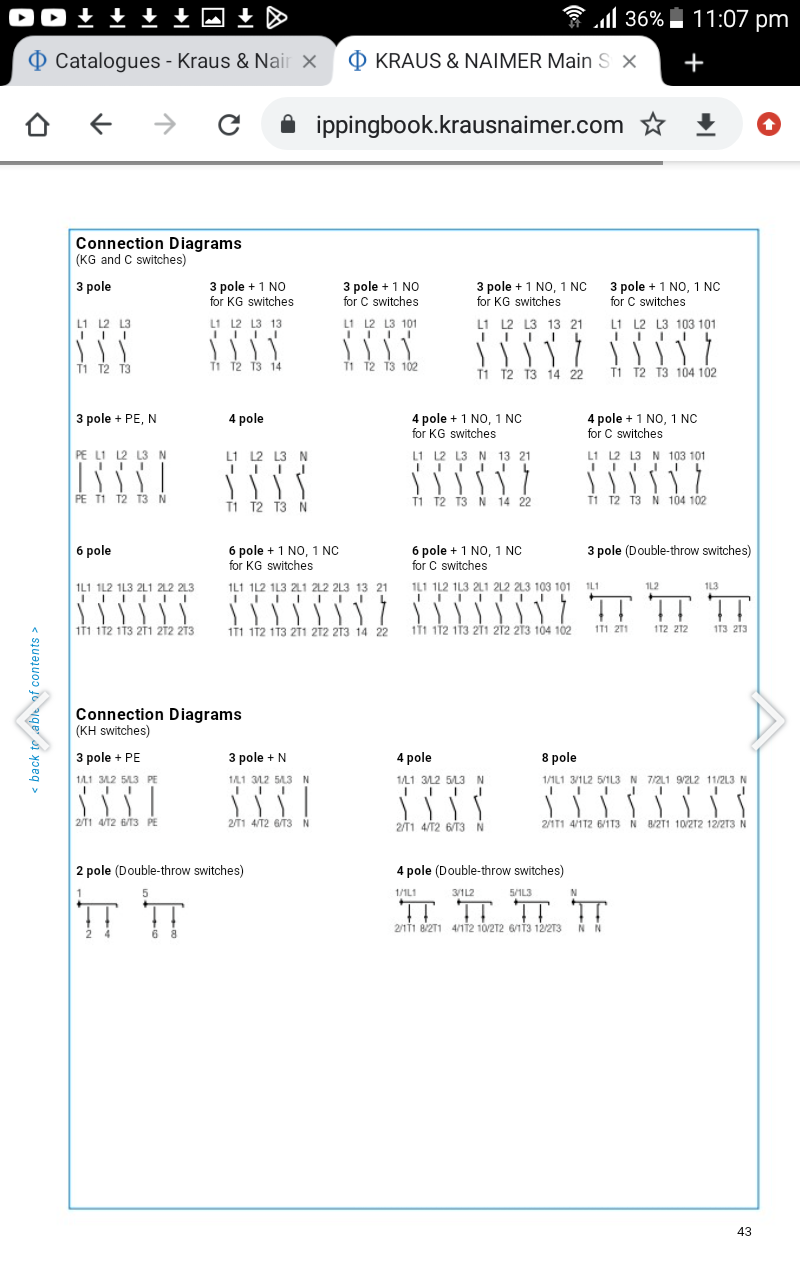

When I looked on kraus and muller website they do 3 pole and N as well as 4 pole ones, the dedicated N ones are marked N

A four pole will open & close all four poles, but without early make/late break. This can cause voltages approaching 400V to appear on equipment. Basically if the neutral is lost then you could potentially have a fireworks display.
Don't know what the symbol is tried years ago, as you say it is a switch, but I'm sure it's meant for a control circuit.
The solid N link on the Ops one is to the left side of the poles it's just a flat bit of metal same as the earth.
The ones I buy don't have that symbol, and are Marked N with a different symbol.
I think the op's one evolved from old days when you linked 1 phase to the 4th pole when feeding a contacter, so then you isolated the 3 phase and the single phase control circuit, to work safely on the contactor or whatever.
As for the 415 I mention, we do fryers with 3 x 240 v elements and 240v electronic controls,, when all 4 poles try to switch together, I feel if the 4th pole in the isolater shown was a bit slow and used as N, loss of neutral can cause two phases to oppose each other via the elements causing up to maybe 415 volt between phase and N
