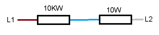

Imagine the scenario of a 10KW load on ph1, 10W halogen bulb on ph2 and nothing on ph3 and the star point loses the neutral:
I won't bother doing the Ohms law calculations but I'm sure it becomes apparent quite quickly the pd across the bulb will be almost the ph to ph voltage, I'll go so far as predicting within 99.9%
Indeed. Thanks.
What I was 'missing' was a scenario such as you depict, with single-phase (phase-N) loads supplied by more than one phase -I was thinking (and hence 'talking about') only of the situation in which there were single-phase loads only supplied by one phase.

The neutrals of the loads may be disconnected from the supply, but they are still connected to each other!
Indeed. As I've just written to Sunray ...

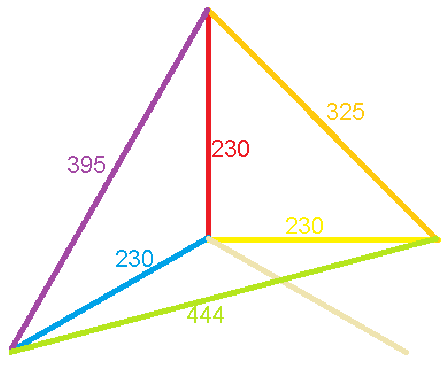

I too have absolutely no idea how how a phase could be in the wrong place but I hope this helps the result.
Not very technical but a quick knock-up on paint:
Drew the 3 phases then added the 3 3 ph-ph lines and did rough calculations from measured coordinates
There will be errors but not too bad.
All 1ph supplies are fine but 2 of the phases are well above and below that expected.
3ph motors ran slow and shaking and pulling much higher current, making the motor overloads trip.

I've had this in my media for nearly a year:
the green is the result of adding black and red together and lags red by 30°, equally it leads blue by 90°. So the phase relationship is available at a push. Again I say I have no idea how such a confusion of the supply could arise.
I too have absolutely no idea how how a phase could be in the wrong place but I hope this helps the result. ... Not very technical but a quick knock-up on paint:
Drew the 3 phases then added the 3 3 ph-ph lines and did rough calculations from measured coordinates .... There will be errors but not too bad. .... All 1ph supplies are fine but 2 of the phases are well above and below that expected. .... 3ph motors ran slow and shaking and pulling much higher current, making the motor overloads trip.
