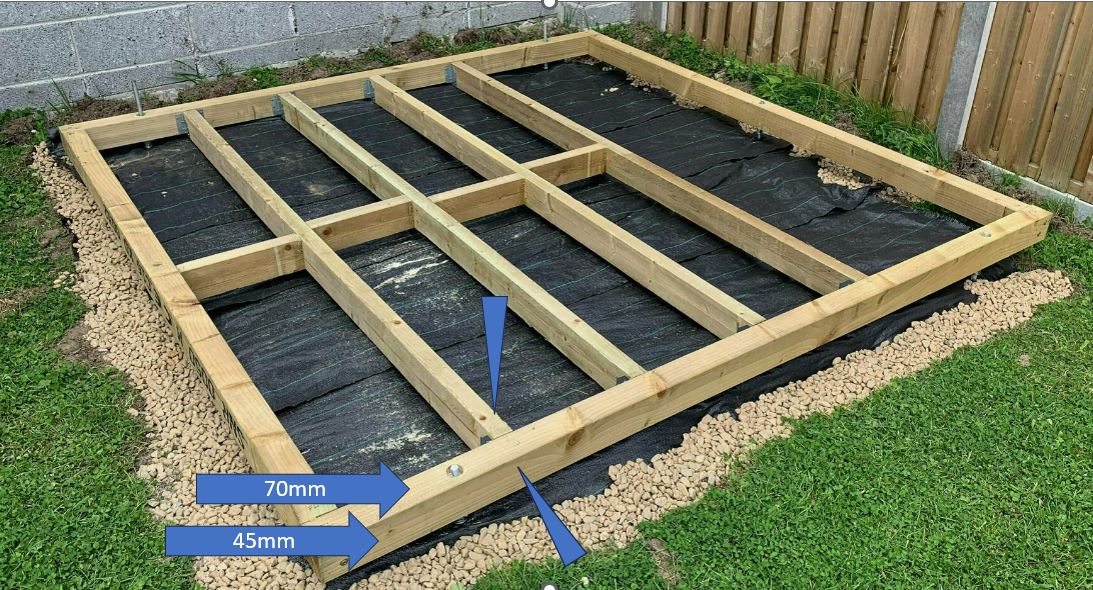

I need to build a frame using 45 x 70 timber. This will comprise of a rectangle being constructed with the 75mm side laid down. I will then have cross supports every 40cm and this will also be laid down the 75mm side. Should I screw through the 75mm rectangle to hold these cross supports in place or screw them from inside at an angle? I am trying to understand what provides a stronger join.

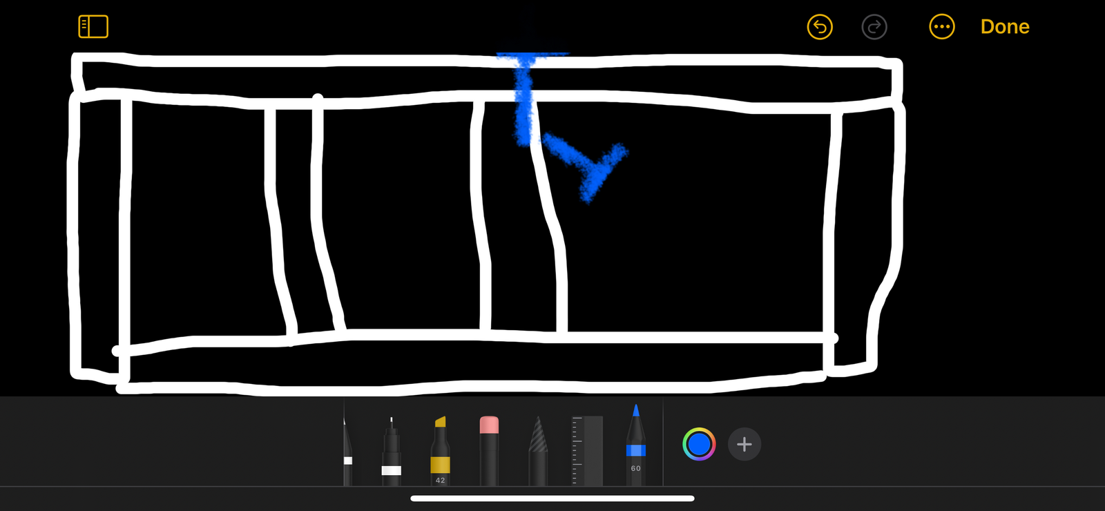

This graphic may help the explanation above. The wood is all laid along the 75mm side. The two options for screws is marked in blue.
Thanks in advance.

The base frame I am referring to is something like this:
Unusually, in my case I will have the 70mm side at the top and 45mm along the side. The cross braces will follow this format.

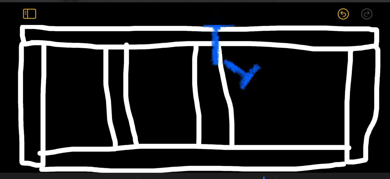

The blue arrows (without text) are - what I think - my screwing options. I could go straight into the long timber and screw into the cross brace. Presumably this would require a screw that is around 100mm long as it would need to go through the initial 70mm before it touches the cross brace. The other screw option is from the inside at an an angle. I could use a much smaller screw here. I am trying to understand what provides the most strength.

Yes, except my timbers are arranged differently. They have the wider side on top as shown in the image with measurements.

Right now, I am trying to understand which option I should use for the screwing of the base frame. Do I go through the 70mm timber and then into the cross brace or screw the cross brace at an angle. Again, I have tried to illustrate that in the earlier image.
