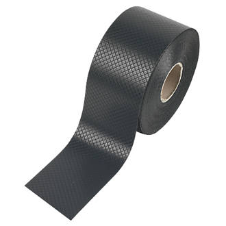

If the outside wall frames of your structure go onto DPM roll (available in various widths) lapped up the frames and stapled:
The walls can be clad and the roof put on, giving you somewhere in the dry to do the interior work. Any wall cladding can be laid over the DPM roll where it is turned up. I'd suggest making at least your sole plate in pressure treated timber. and maybe doubling it up to get a decent lap (using, say 300mm DPM which is under a tenner for a roll)
By putting down a DPM inside, again lapped up the walls and laying 120mm of PUR (pink, higher density) foam onto it, tightly fitted (i.e. no gaps), it should be possible to float an 18mm T&G P5 chipboard floor on top of that glued at the tongues. That way you get 120mm of insulation instead of 12.5mm, you aren't paying for the joists (which in prolonged direct contact with damp concrete might be prone to rotting), you aren't creating any "hidey holes" under the floor beneath the joists for wild life to nest in, and you can fix the wall frames directly through into the concrete with approprate anchors (although TBH 6.0 x 100mm screws and brown plugs would do the job)

I wrap my 4x2 studwork base plate in a 300mm DPC and screw through it to anchor to the concrete, (won't this pierce the DPC?)
then I fill the internal space with a DPC sheet lapped up the stud work to above ground floor level.
I'm assuming that I will have to make my internal walls longer to accommodate the extra (below floor) construction.
Could I not run the internal DPC sheet under the external stud work. (effectively putting the whole structure on a DPC sheet on top of the concrete?)
Yes, but don't worry about that. It's accepted practice to fix through a DPM - it still protects 99% of the material, which should in any case be treated timber, otherwise how do you get a structural fix?
