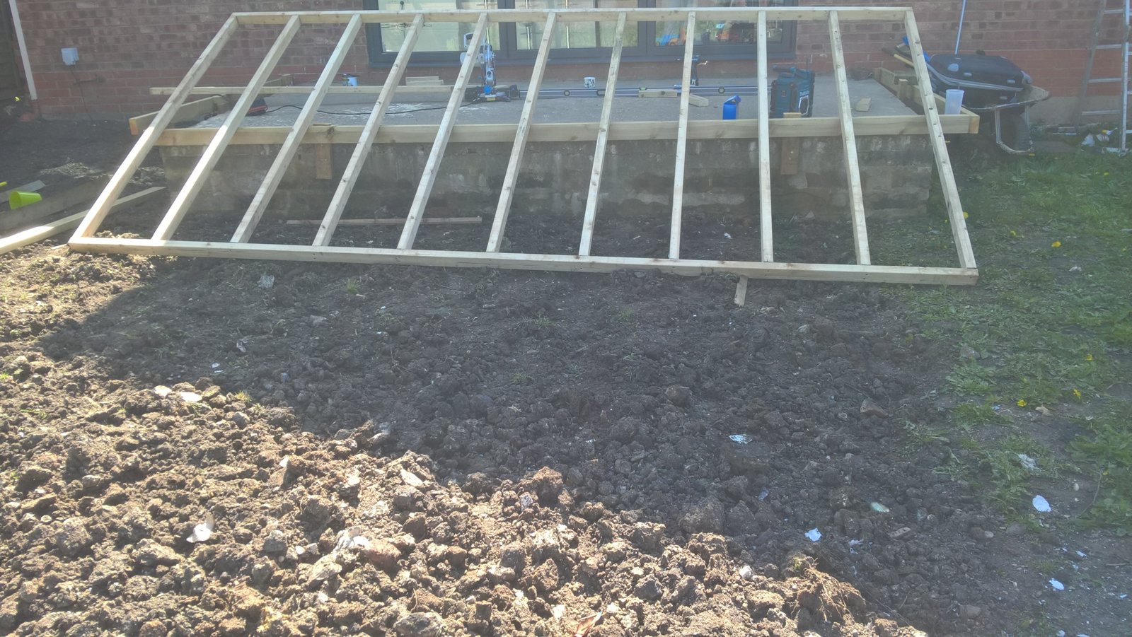

A follow on question please. Do I need noggins in this joist frame (4.2m x 2.20) and how should they be positioned? staggered, how many per joist set, etc.

Assuming you are laying the boards perpendicular to the joists (so left to right in your picture) then there is no need for noggins, the deck boards will secure the whole thing together.
That is how I am laying it but seen quite a few videos where they are fitting noggins. Thought I'd check with the experts.
Is there any justification for noggins because I am using 3x2 joists and it may reduce bounce, etc.?
It might reduce a small amount of bounce on the boards that exactly align with the noggins. I guess the complete answer is that you don't need to install them, but if you have the time and the timber spare, there is no harm in over-engineering it :)

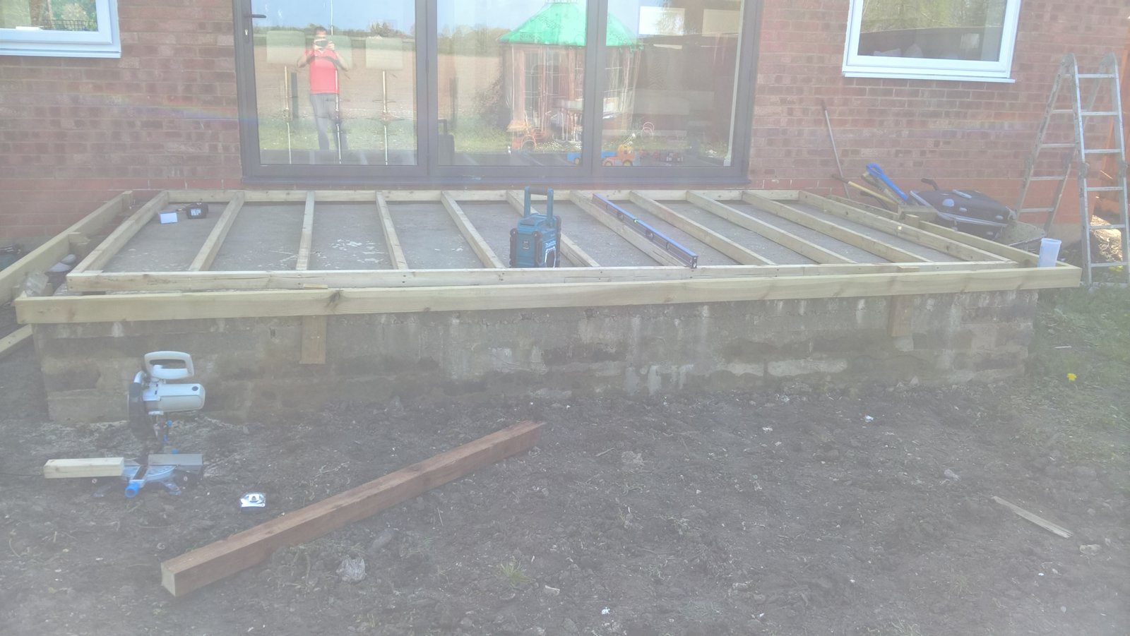

Here are a couple of pictures of my working progress...
