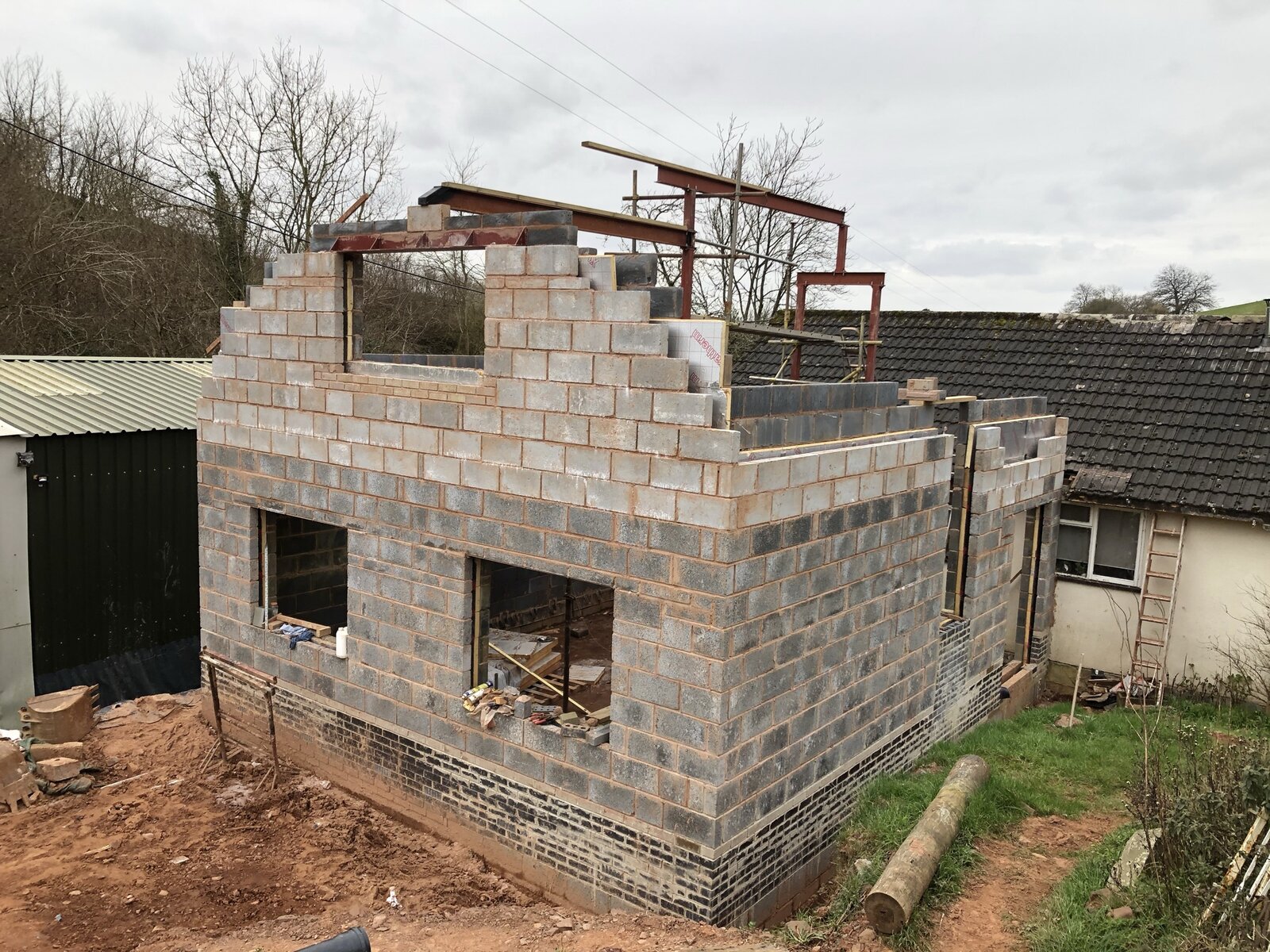

Hi!
I have a few concerns about some cracks on my self build that I am half way through.
This is my first project, I might add!
I have found a few hairline cracks and wonder if I should be freaking out?
Here is the story:
the site is 8m x 7m
I dug the foundations myself! I dug down around 2-4 metres in places into fresh/virgin soil in our uneven garden.
The concrete in the trench is a minimum of 375mm deep by 600 wide. It’s probably a bit deeper and wider in places. I made sure that the digger bucket excavated with the teeth slightly upward, so as never to drag the bottom of the trench. So all soil in the trenches is nice and compact.
Everything has been done to the structural engineers calcs.
the building control officer has inspected the soil and trenches prior pouring the concrete and blocking up the foundations. He then also returned to see DPC.
he was happy through the process.
The concrete was poured in august last year. I then began to lay the courses of blocks in the evenings, at weekends and in some spare days off work.
It’s 100 wide block outer leaf, with 140 block inner, with a concrete filled cavity up to 200 ish below DPC! Above DPC is n7 outer leaf with 3.6 aerated inner leaf.
The build is a 1 & 1/2 story build, with a room in the roof basically. To keep the rooms free of any load bearing support, the engineer specified a RSJ ridge beam and 200x47 rafters at 600 centres. The RSJ sits on a padstone, above a Heavy Duty Lintel in the wall, and upon a 100x100x5 box steel uprights elsewhere.
I was able to progress a lot more due to being at home during the lockdown in January to April.
I eventually lifted the RSJ ridge be into place in February/March. I have since then been adding roof rafters, building dormer windows and rolling out membrane and nailing in battens!
in the last two weeks, I have noticed some cracks they mainly follow the mortar, but has split a n7 dense block in half too! All issues are in the centre of the window reveals on the first floor, about 2 courses above DPC!
There are no issues, as far as I can see, in any other areas of the walls or the directly bearing block work sections. It’s just under the windows. I’m guessing that there is less pressure on these areas?
The cracks do not go down near the DPC (yet) and are not visible in the foundations.
My main question is, would anyone expect me to see some cracking under the windows, due to the fact that these block corses were laid back in September and october last year, and have only just recently started to take to load of the roof above?
Could it be a little bit of uneven settlement, with the load bearing bits settling a deeper and heavier than the unloaded sections? Is so, should this stabilise once the roof is finished and the tiles are all on etc?
Or should I be getting the digger out and get down to the foundations and have a better look at them?
Would bad weather have kept these areas moist, moist enough to make them softer than other areas, due to the fact that the rain can soak down through these exposed window reveals?
The cracks are only hairline, and you really need to look hard to see them! But now I know they are there, I can’t un see them! I have no idea how long they have been there, I only spotted them recently! They could have been there for ages!
i re pointed one crack about two weeks ago and it hasn’t returned. (Touch wood).
the only loading left to go on this wall is the roof tiles! The floors are supported by the returning walls!
Should I just keep calm and carry on?
Im pretty confident that I’ve done a good job, but a little bit of doubt is creeping in!
Any help would would be really appreciated!
i can’t sleep!
I will try to upload some images later!

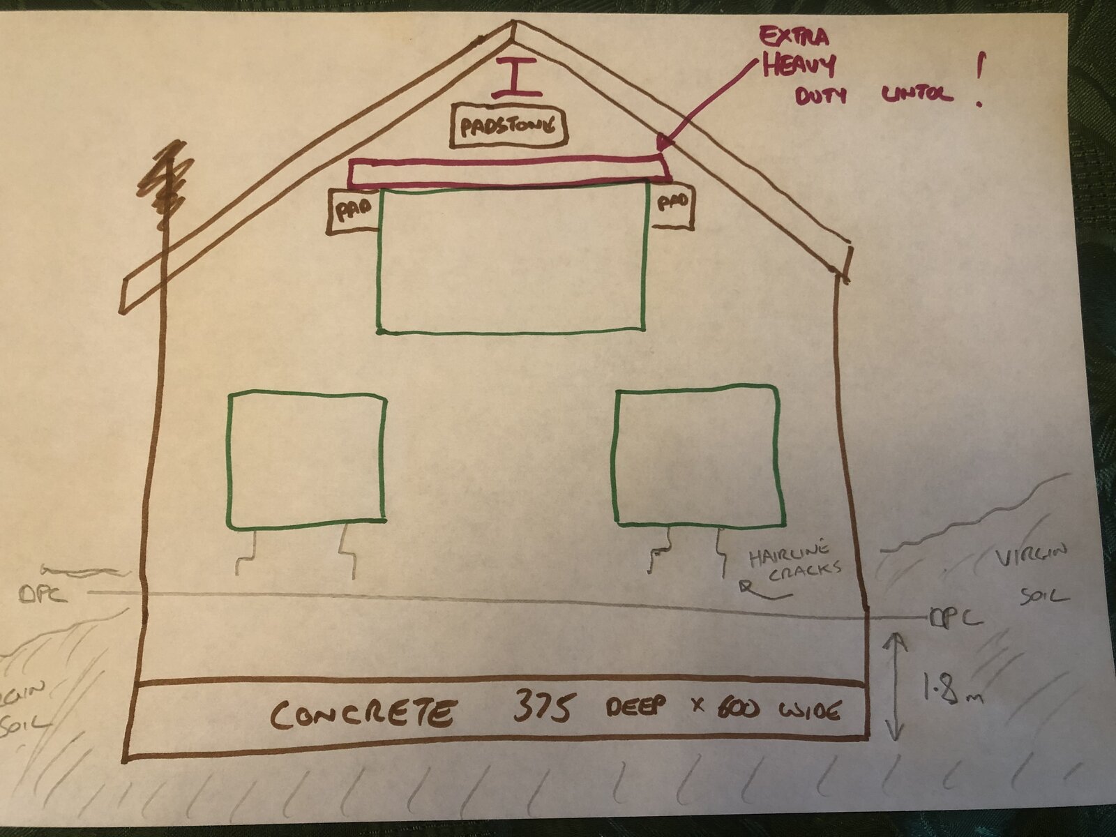

To anyone else that is looking at my post, and the sketch that I made, I hope you will concur that it is just a bit of loading settlement and shrinkage as the point loads are absorbed!!?
Thanks!
4m deep trenches (or even 2.4m) and strip founds? Thats insane.
Summary of your problem- you've got some cracks in the walls below windows. Those sections of wall are lightly loaded so there's a bit of settling going on. Did you use any plasticiser in the mortar? Is your house built on made ground (ie is there an old industrial site or mineworkings or anything similar below). Did you pour the foundations in one 2 hr go or did you do them in stages?

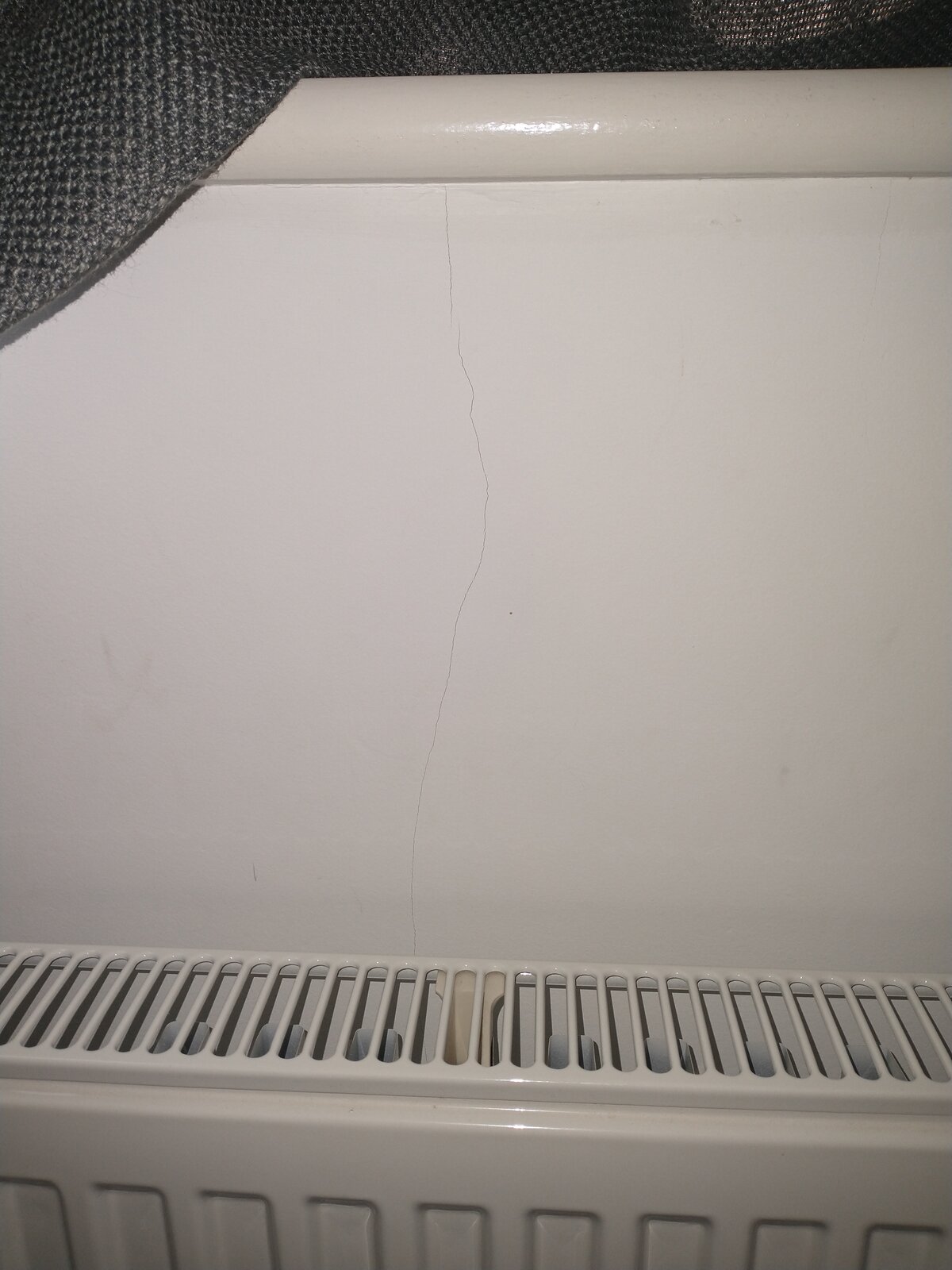

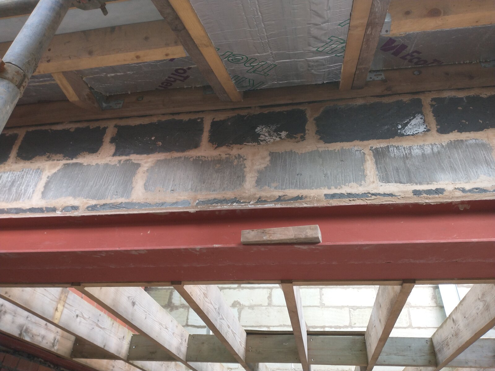

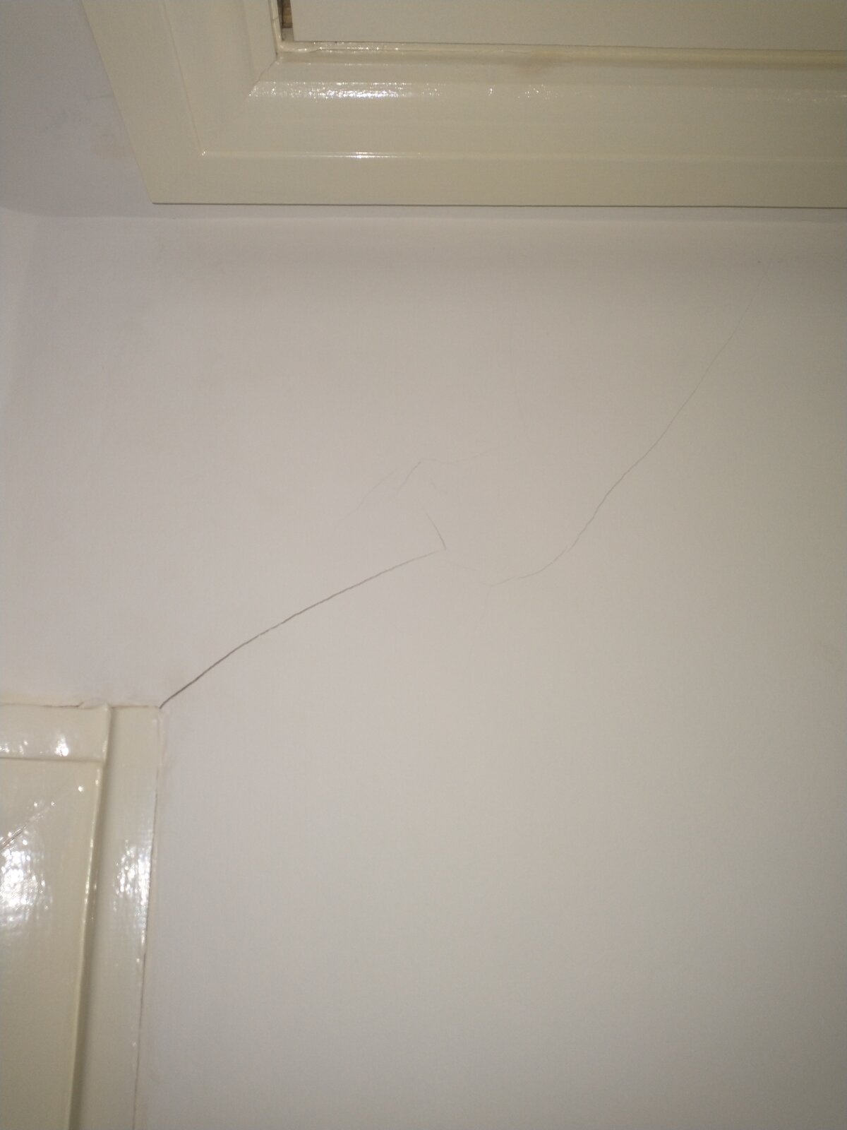

Here's one of mine, it's mid span on a 4m steel with another floor and roof on top - if you can't see it by zooming in it's just above the bit of wood. Doesn't worry me.
In other areas of the original house I have steels supporting first floor walls which now have cracks in, and while a little disconcerting at the time I'm not worried because I figure this means the walls have now firmly settled onto the steels and are not "floating" as masonry sometimes does and they're not going to "drop" onto the steels in the middle of the night in 6 months time.
Settlement, is anything significant would normally be even and so should not cause any cracking in a new detached building. There should be very little shrinkage in concrete blockwork.
It is certainly unusual for a 7N block to split, and even more so when it is in only two course of blockwork.
Not impossible, but unusual.
Is the mortar super strong?

Assuming there are no other cracks on other elevations, best guess would be a combination of exposure - the orientation of that elevation, and the rain being allowed to get into the top of the wall via the cill being uncovered, and this leading to rapid changes in moisture content in a relatively small section of blockwork.
It may need repairing before rendering.
All walls/sections should be covered to prevent moisture getting into the top of the wall until the final/permanent topping is formed

as I say, there are no cracks in the other areas, so i suppose the vertical load running down through the columns from above is helping to tie them together. This would encourage the shrinkage and movement to be let out in the weaker section of the wall under the window where there is zero loading from above?
If it’s settlement, maybe the settlement is acting down along the bottom of the end wall in a M shape, causing the 3 points under the most load to push down and the areas under the windows to heave upward a fraction?
