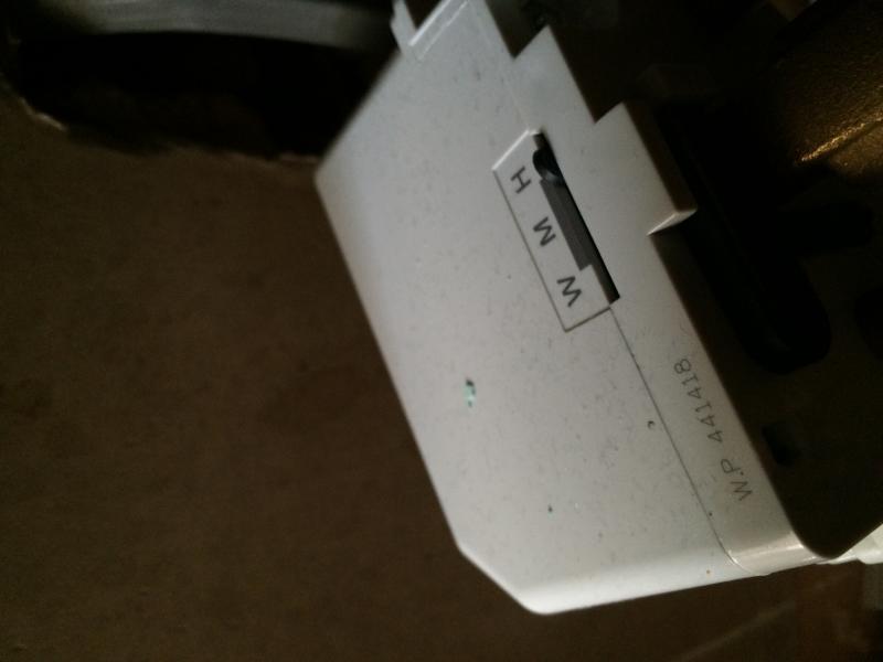

OK. I'll try to explain. The motorised valve is wound open by a motor.
1 For hot water only, the valve is unpowered. Its mechanism is held back at rest by a spring. At this point, the central heating port is closed and the hot water port is open.
2. When heating and hot water are required, the motor is powered and winds the valve to a central position, where it is held by a microswitch that detects it is in the middle. At this point both ports are open.
3. When only central heating is required, the motor winds the valve to the far end of its travel and closes off the hot water port. The frost stat will likely be wired to by-pass the programmer and put the valve in this position.
The operating lever has two positions. The default position is AUTO 'unlatched' and this allows the motor to take control of the valves position. If the lever is moved across to the MAN position and latched, the valve is held in position 2 as described above with both ports open.
Having said the above, if the valve is latched in MAN and is told to go to the central heating position only by the controls, it will do so and likely release the lever from its latched position as it winds past anyway.

Sorry I'm not so good explaining with words. I like pictures better!
the pin on the valve that moves between the three settings (HW /CH / central (ie both)) "sits" in the last known location until told to move
I'm not sure what "pin" you are referring to. Most of the valves I've seen look like the one in the photo, not seen any pins anywhere.
Anyway you are correct in that the valve does indeed remain electrically held in its last used position. This is because there are certain control signals present at the valve even when the heating and hot water are set to be off.
However, when the frost thermostat turns 'on' it will by-pass the programmers control of the central heating on and off periods and turn just the heating on. This will then drive the valve fully across to central heating only position, regardless of where it was before.
OK thanks, I think I've only ever seen one of those. Is it called an iflow or something like that?
The most common makes are Honeywell, Danfoss, Drayton and Horstmann they all work on the same principles and are electrically interchangeable. So I would imagine yours will be too.

This definitely has a mid position, ("M") which is indicated when both the CH & HW are on. We have three options - CH only, HW only or CH & HW.
That photo is a Drayton mid position valve.
