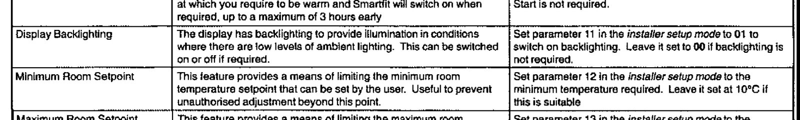

I may be wrong, and I’m not sure if your system matches the attached manual, but I was wondering if the snowflake symbol was related to the minimum room temperature setpoint, rather than the frost stat firing the boiler itself?
Thanks very much for looking into it. I had wondered the same thing myself, but there doesn't seem to be consistency re: the inside temperatures that are triggering it firing - I have a separate room thermometer which is ~16deg when the snowflake symbol is coming on. Weirdly the snowflake symbol isn't mentioned at all in my Honeywell manual!
