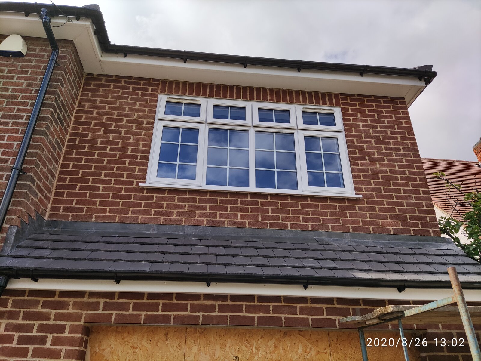

full tile at verge? simple novice question
I'm probably totally wrong .... but your latest picture shows a tile, then a tile that has been cut to an L shape. Could this be replaced with a "tile and a half" and cut into an L shape so its stronger?
Ignore me - Just seen what you mean!!
Getting somewhere near with this now.

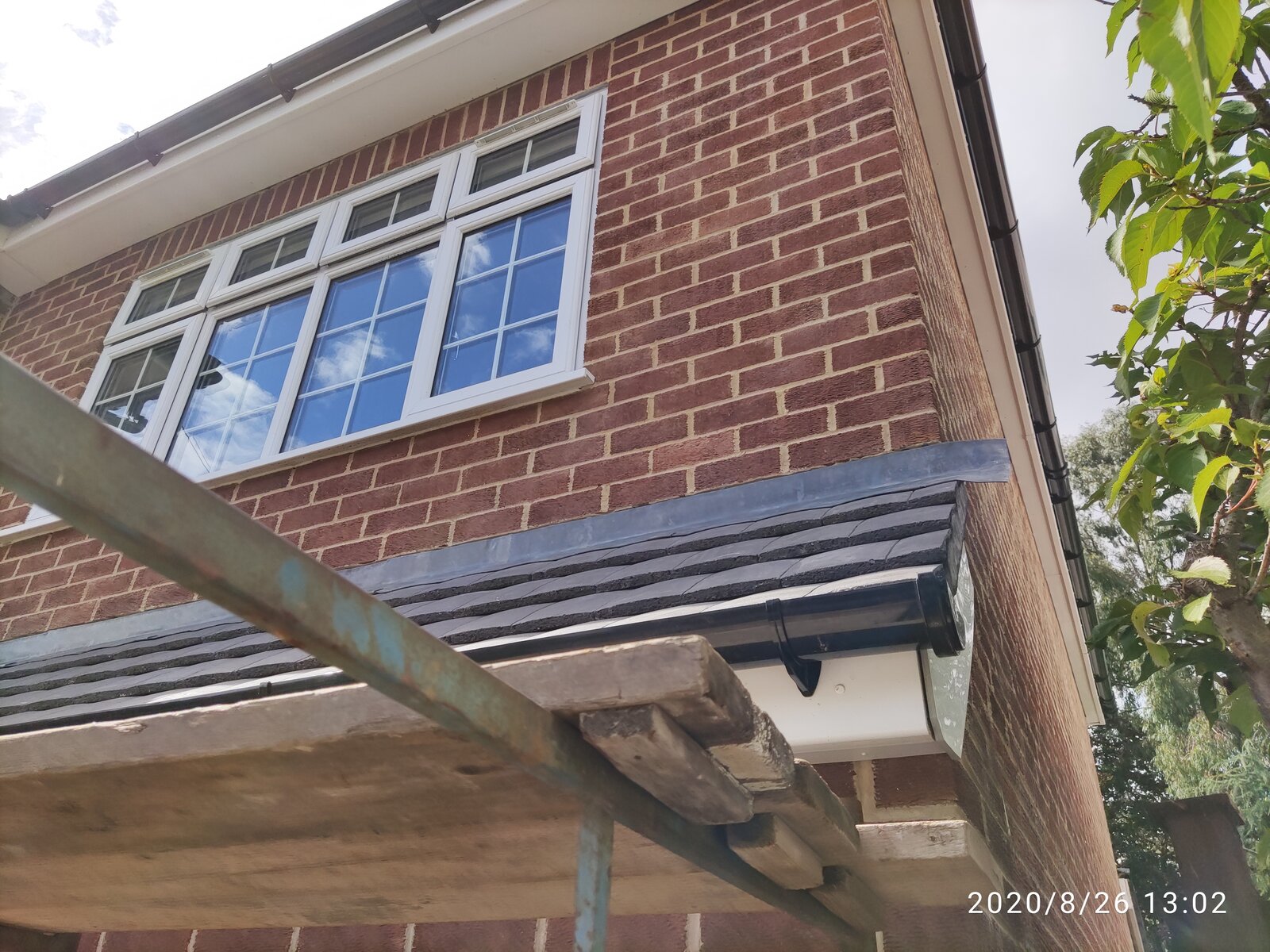

Waiting till the mortar has set a bit before I shape the lead near the verge. Has anyone got a decent photo showing how this should look? Thanks
Afternoon, has anyone shed some light on how the lead is supposed to look at the corner?
If I fold it down or around I'll have to cut the lead but will that leave a gap?
Basically you do both.
Trim it back a bit then dress it round and down . No need to cut , just a little Patience
