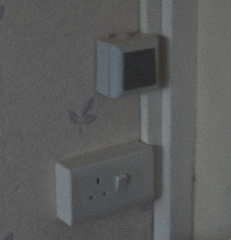

I used LAP grid system from Screwfix, a non fused spur was made into a fused spur so I could add more sockets, and it still had a socket at the point where the spur first socket was. IMGP7387.jpg But if you read the appendix 12 I think it refers to 2 kW limit to non portable appliances from a ring final, so you have to decide if there may be an overload problem.

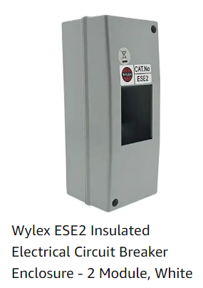

Thanks again for the very informative explanation EFLI. Could you give me an example of what you call "a small enclosure with a 25A MCB in it" - and I will leave you alone.
I can't seem to find any at the moment but they are out there.
Like this on Amazon - but just one module wide:
