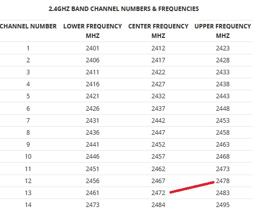

, channels 12 and 13 are fine to use.
They also overlap
Just using one example. The upper frequency limit of channel 12 is higher than the centre frequency of channel 13.
Assuming 5MHz channel spacing and 20 MHz band width per channel ( Centre frequency +/- 10MHz )
They also overlap
Agreed, I just didn't understand why you only mentioned channels 1-11 given that you don't seem to live in the USA. Sorry, i wasn't having a dig at you, I just didn't understand why you omitted the extra 2 channels.
With regards to Wi-Fi channels, if you use OS X (Mac) you can use the Wireless Diagnostics tool which will scan the area and tell you the best channels to use based on usage in the local area. I'm sure there are free Windows alternatives too.
There are a few versions of scanning software, to show local channel usage, but what I find is that the occupied channels constantly change. By default, routers when turned on choose what they find is the least occupied channel - often that channel will be the one you have chosen earlier as the least occupied local channel.
My solution, after spending years struggling for access and constantly swapping channels, is to have more than one router access point. One at the top of the house where the phone line comes in, a second on the ground floor, with the two connected by a LAN cable. I have a third wifi router on the first floor, also wired back to the main router, which serves what I call my 'print room' and only powered when I need to print anything. In there I have an old monster of an office laser printer and a couple of colour laser printers, plus a RPi acting as a weather server, plus my desktop PC.
