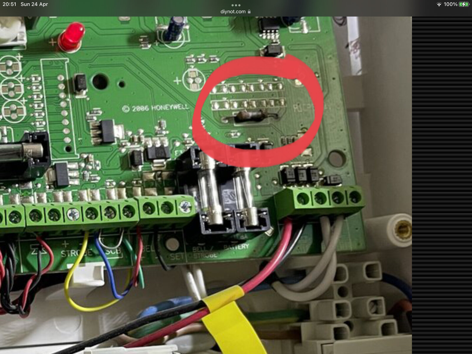

Everything appears to be working, what does that control ?
That's a great spot.
Your control panel battery is faulty or has been faulty and burnt out that resistor.

What would this stop working? As it appears to be working ok ? What would you replace this board with please?
There are some old stock available on eBay so you may be able to get a like for a like replacement.

As stated previously the resistor burns out when a battery has long since failed.
