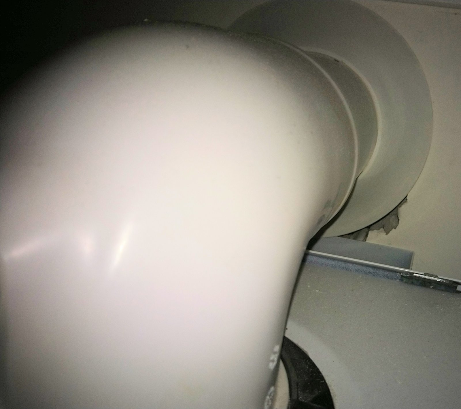

Sorry for replying to an old thread.
I have gaps on my flue at wall above the boiler, which is the best method to fill these gaps apart from foam as the flue as per image is attached to plasterboard wall.
