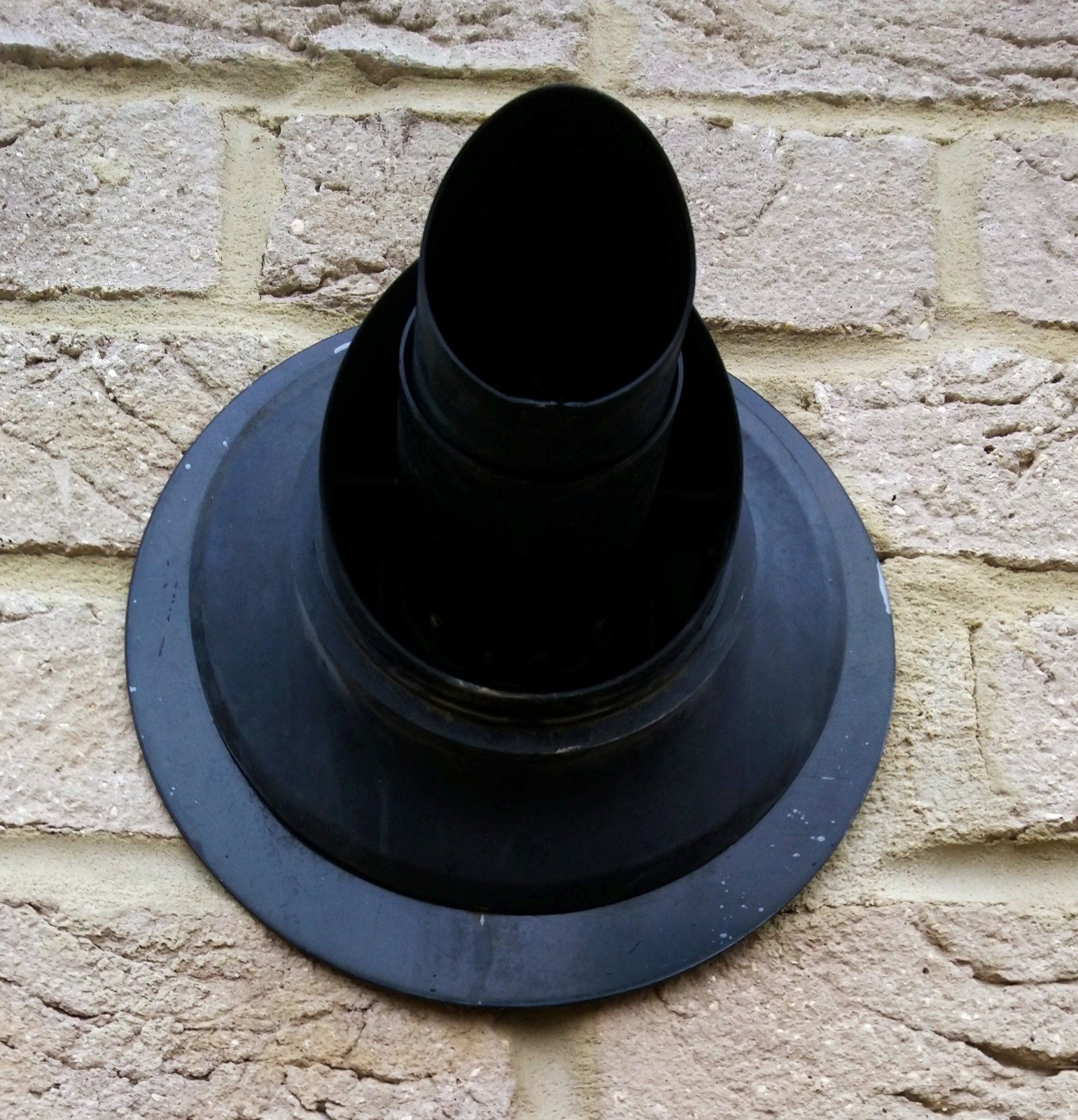

Here is the external flue from outside, does it look ok re sealing etc?

you will have to pull the weather collar forward or remove to see what the gap is like , but they can all be sealed , hardly a big job

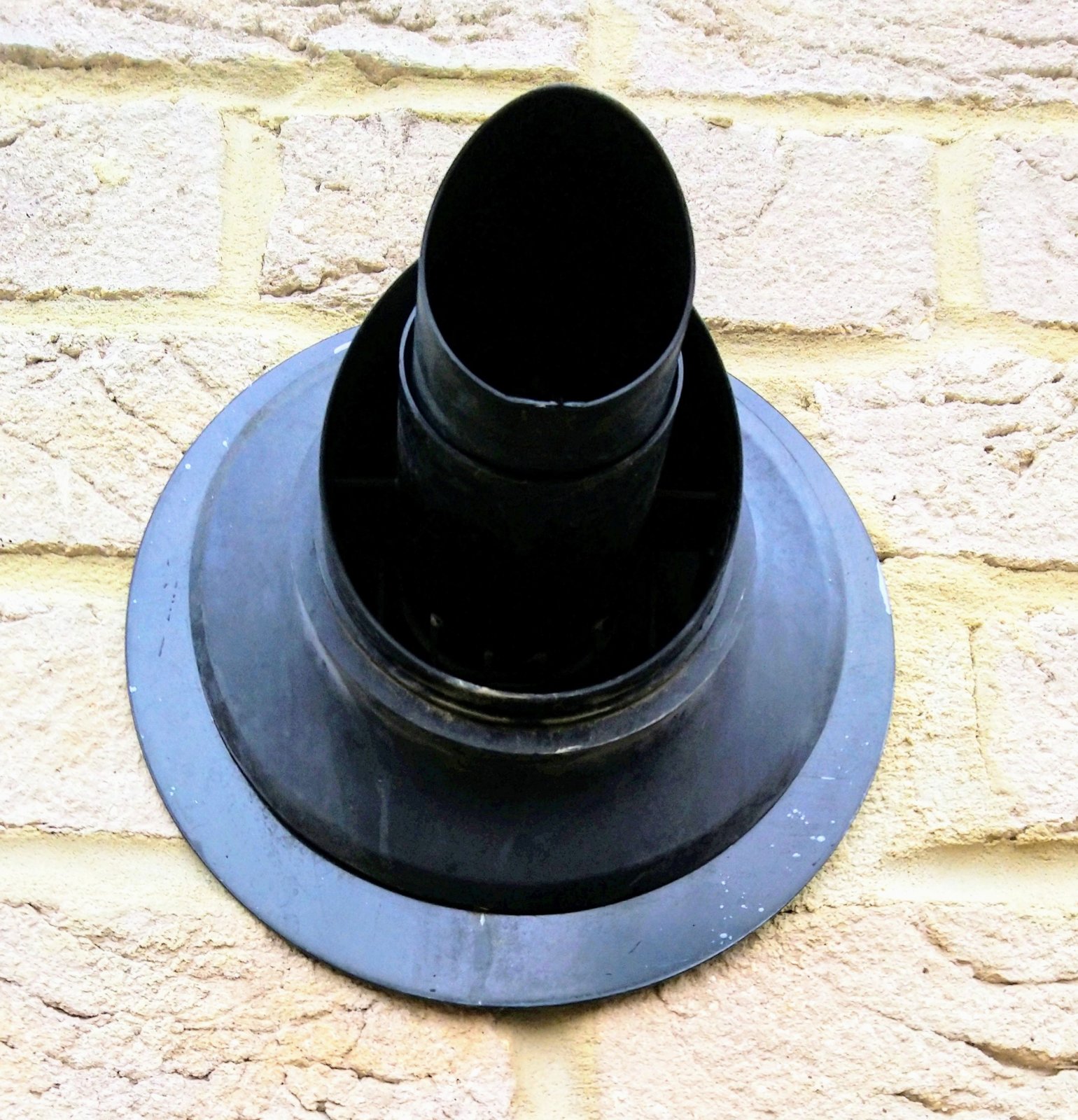

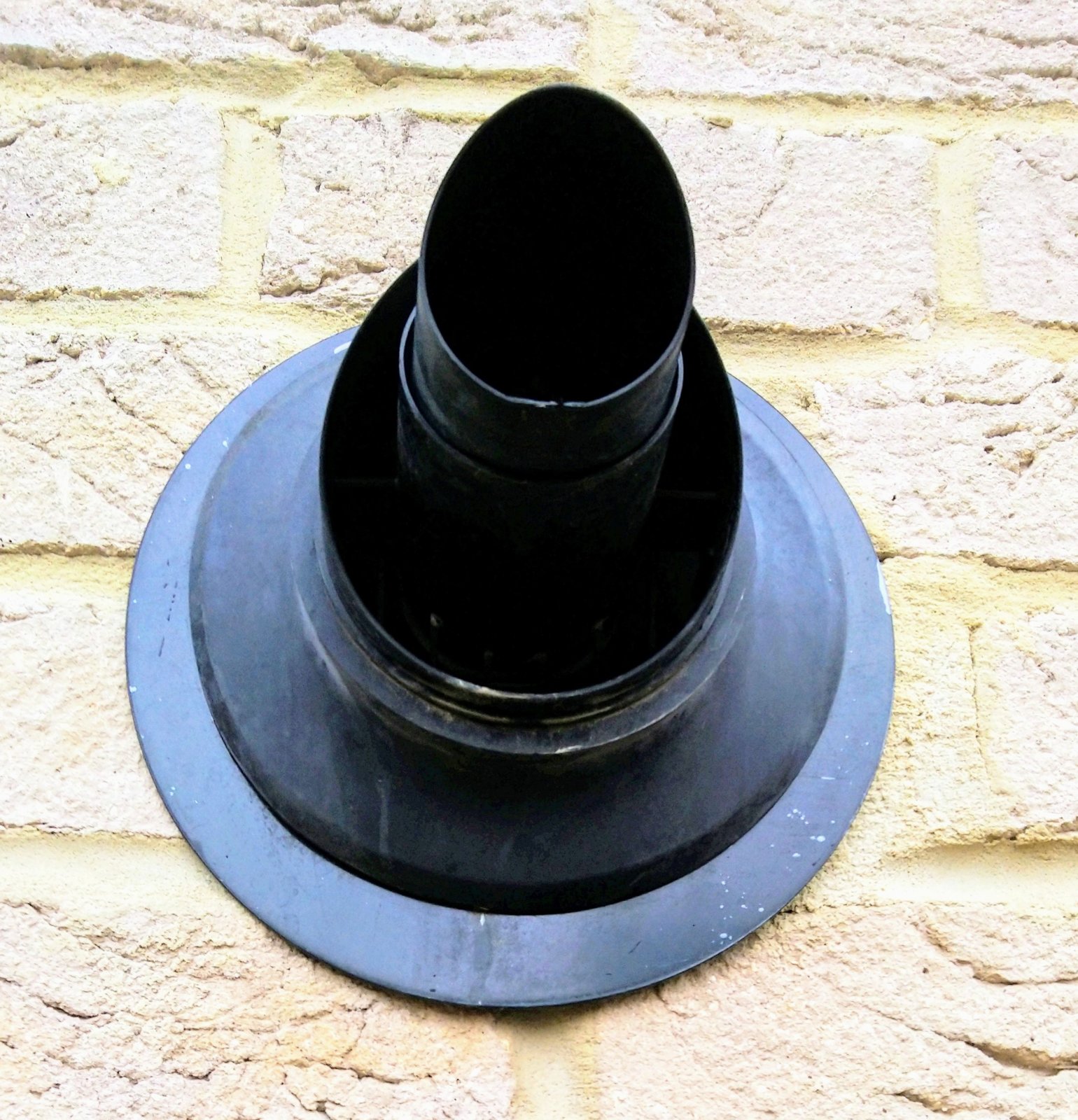

Here's a slightly brighter image.

still means diddly squat though, what exactly do you think you have to seal , nothing in any of those pics

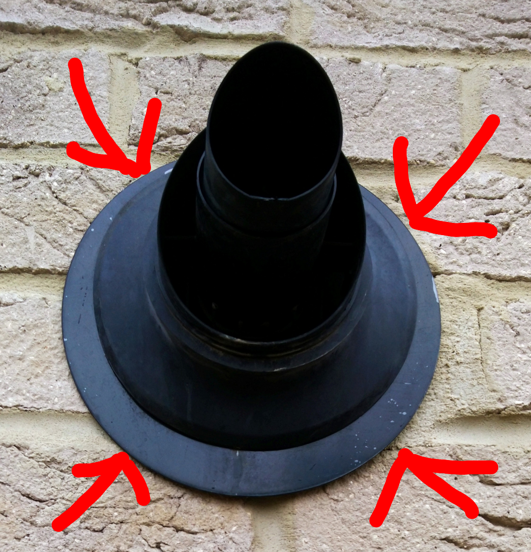

To answer your question I wondered if there should be a seal around the outer area as arrowed in this image.

Fold back the rubber collar and seal any gaps. It really is quite simple.

NO, you pull the weather collar forward and seal the gap behind it , kinda thought you were not understanding what needs to be done
