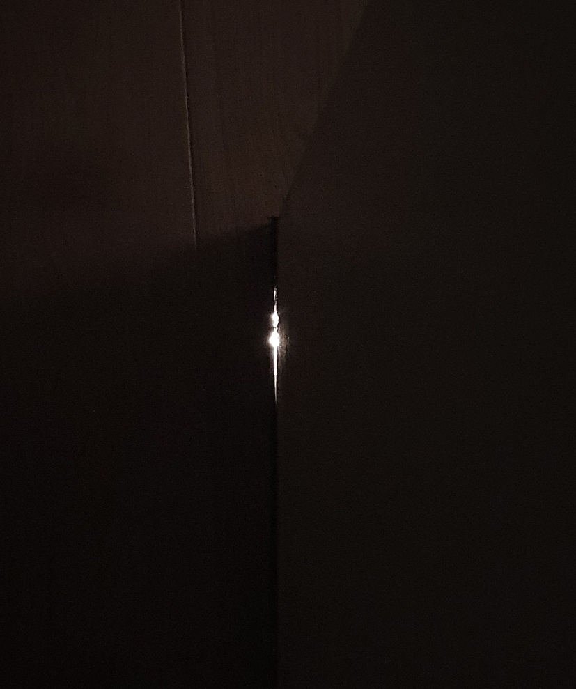

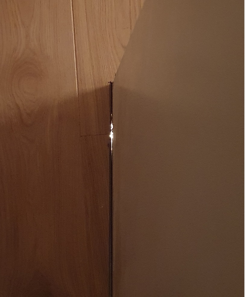

I have sound insulated my wooden floor using MuteMat 3 and the flanking strip that comes with it.
However my contractor left a part which is not part of the wall (therefore there is no skirting board) that touches the wardrobe without the strip, and I realized the other day that there is light coming from the bottom floor's ceiling.
My guess is that (airborne) sound escapes from there too.
He suggested to use self expansion foam to cover the gap, and that he couldn't put the strip as there is no skirting to fit on top.
I am not sure on the self expansion foam, first I don't think it can replace the sound proofing strip, and second I am afraid that it will push the rest of the floor up in that area.
Any suggestions how to tackle this? My main worry is that sound might be escaping from there to the floor below.

This is probably 5mm on the floor and about 1-2mm on the plywood underneath.

Is this a floor between two dwellings :?: How has a clear gap right through the floor come about :?: Might be more than just an acoustic sealant required.
Correct, it's between 2 floors.
The stack consists of 200mm joists, floorboards,
Mutemat, plywood and engineered floor.
At this particular point, a wardrobe is placed on top of the floorboards.
My guess is that there was an existing gap in the floorboards, which coincided with the rest of the stack (sound insulation, plywood and floor), and therefore the light comes through.
With solid floors in what seems to be dwellings not designed for multiple residents then sound transmission will always be problem , carpet over thick underlay would be best floor surface .Small air gap will have little impact when most of the sound will be transmitted directly thru timbers .
