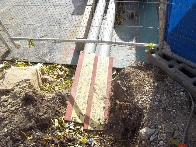

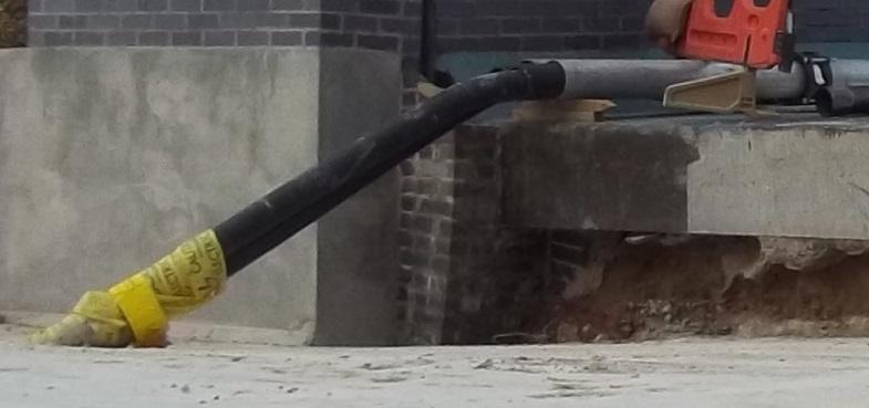

It could also be argued that it's reasonably foreseable that ivy may grow up a wall where SWA has been attached and then someone will have a go at it with loppers.
Cables have often been 'buried' at a depth and then covered with some form of additional mechanical protection where it can't be at the recommended 600/1200/etc depth of cover. This is especially true where cable is run over bridges or graded up to the surface.

Presumably (IMO reasonably) they think it unlikely that anybody will be hacking at the footbridge without making proper enquiries about concealed utilities.
It is not just a foot bridge, it is a two lane road over a railway line.
It would take a very unlikely ( but not impossible ) accident to damage those cables after the bridge is completed.
