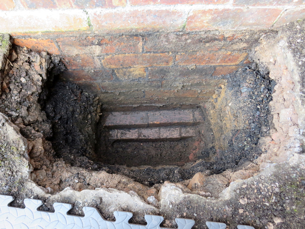

I've been digging - and unearthed stepped brick footings. No sign of concrete foundations as of yet...
What would be an approximate cost to underpin a 5 metre length of wall such as this?
Well its a foundation albeit in brick and in essences is doing the same thing - spreading the load. And it looks pretty sound so have a word with your BCO before you get too worried/get him out.
Thanks - I'm living in hope :unsure:
He's coming to have a look again this week.
The stepped footings are seven courses below the surface level and as you can see are two courses thick. The footings sit on solid clay. It's all clay around here - and you can see the clay in the photo above just a foot below the surface.
What would be deemed to be the advantages of a concrete strip foundation over these brick footings - such as to deem them a requirement (or underpinning) for using this wall as a part of the garage extension?
That is a pretty substantial footing for a boundary wall. There are many houses around here which are built just off one offset, one-and-a-half bricks wide, rather than the two-bricks width you have.
Your BCO would have to be clueless - or peverse - to expect you to underpin that.

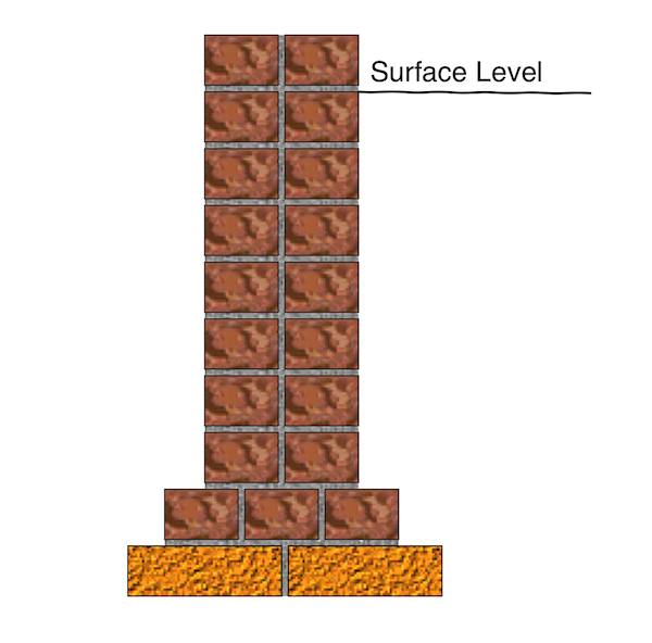

The wall was originally part of a substantial group of garages which were subsequently demolished leaving just this wall around the perimeter of the plot. The lowest footing course appears to be of different brick with a yellow tint.
A cross-section of the construction as I see it is as follows:
Your comments are getting my hopes up here - however the BCO appeared to be pretty sure (99%) it would require underpinning / rebuilding. Oh well - see what he says later this week :unsure:
