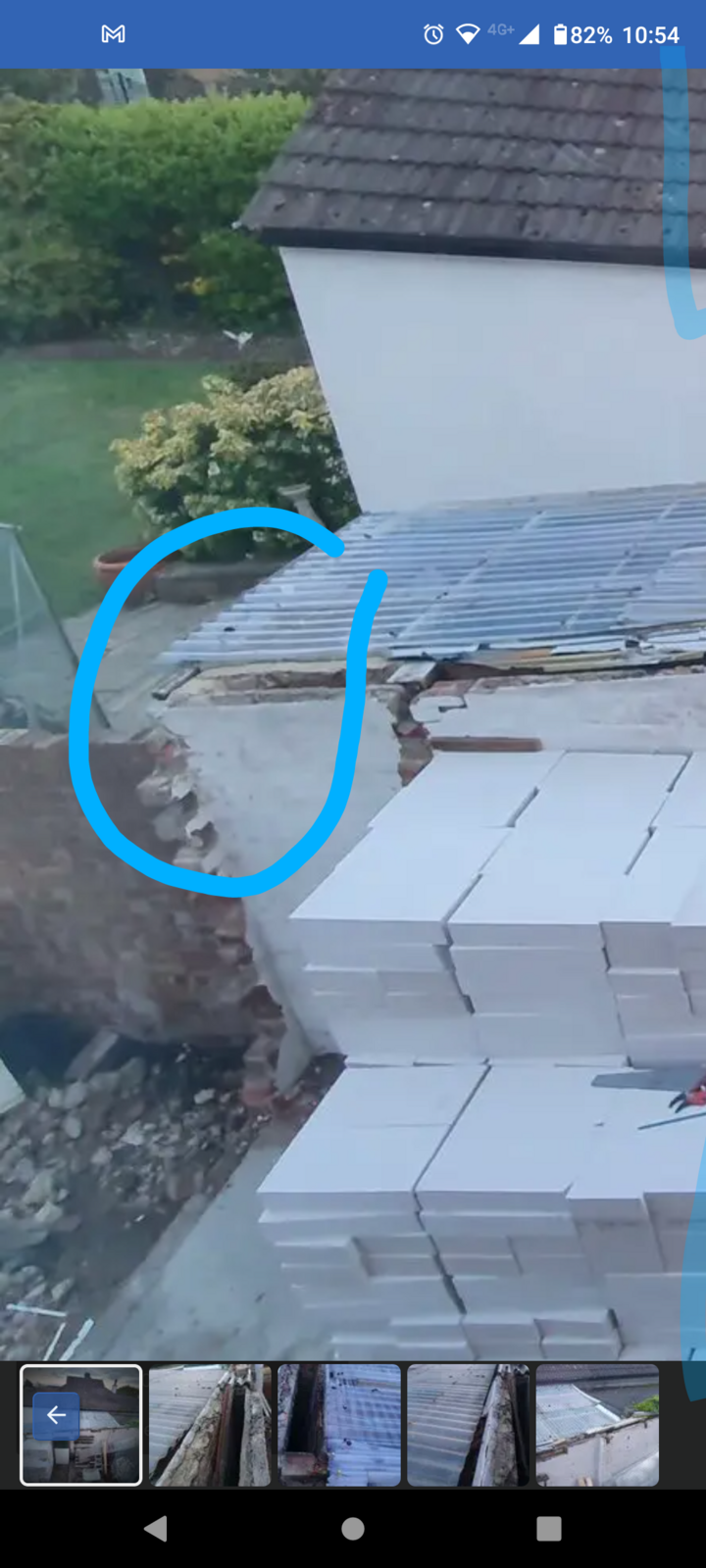

The front was just a garage door and the rear was a single skin used for storage area
To cut through all this, why don't you just do a trail dig from your side. If the foundation is suitable you could just get on with it.
I'm having a loft dormer at the same time so they will first check by trial holes. Is there anything they can do if foundations are good and I start with the build?
That looks strange to me, if it was built with a cavity wall it wouldn't need piers, almost as if the outer skin has been added at a later date. What was the detail of the front and back walls?
This business here is quite interesting:
How would the outer wall be built at a later date in the gap between the garages? The wall looks to be built same time as our garage was built. It's breeze block on inside brick outside.
Regardless, this doesn't even look like a party wall as the neighbours claim?
I don't know, all I can say is that's not a cavity wall, looks more like something someone would build to hide your blockwork garage, does it continue up the gap between your garage and their extension? If it were me, and I were planning to build on that outer wall I would want to be absolutely certain about where the boundary was.

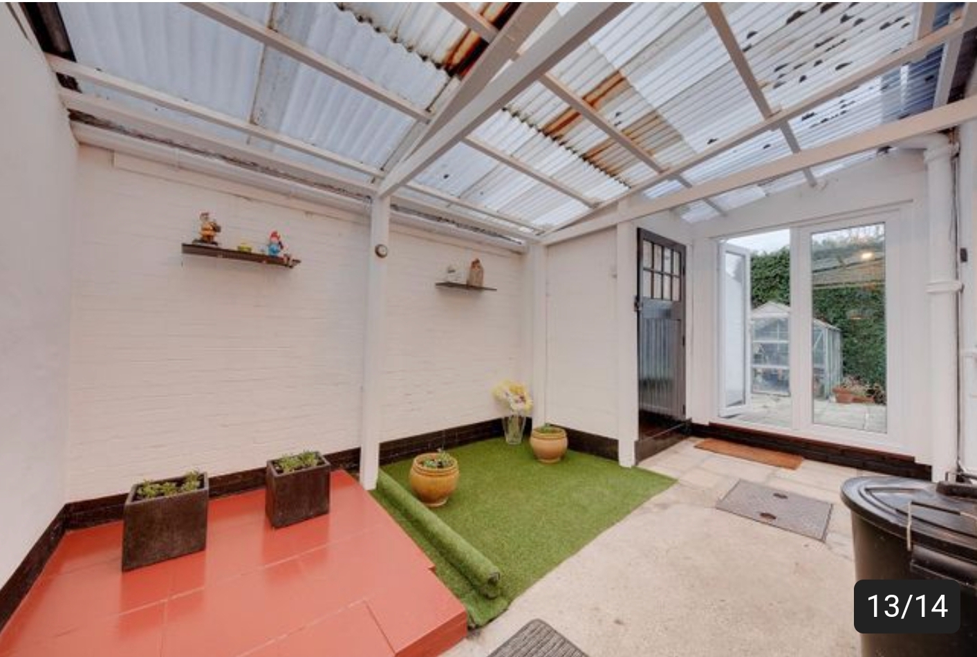

The water has been further muddied by the neighbours lean-to. Even if the disputed wall is on the OP's side of the boundary the fact that the neighbours have enclosed it with the lean-to roof could potentially make it a party wall.
I confess that I don't know if a ramshackle lean-to would count as enclosure. I predict that this is going to get messy and expensive.

I say its neighbouring the boundary line but according to the architects plan, it sits within the boundary line.

After doing some searching I managed to come across a previous for sale advert. This is how the area behind their garage looks. I don't think this would've have planning permission or anything?
you can see the gutter that comes from between our garages to the end where they have a water butt in the garden

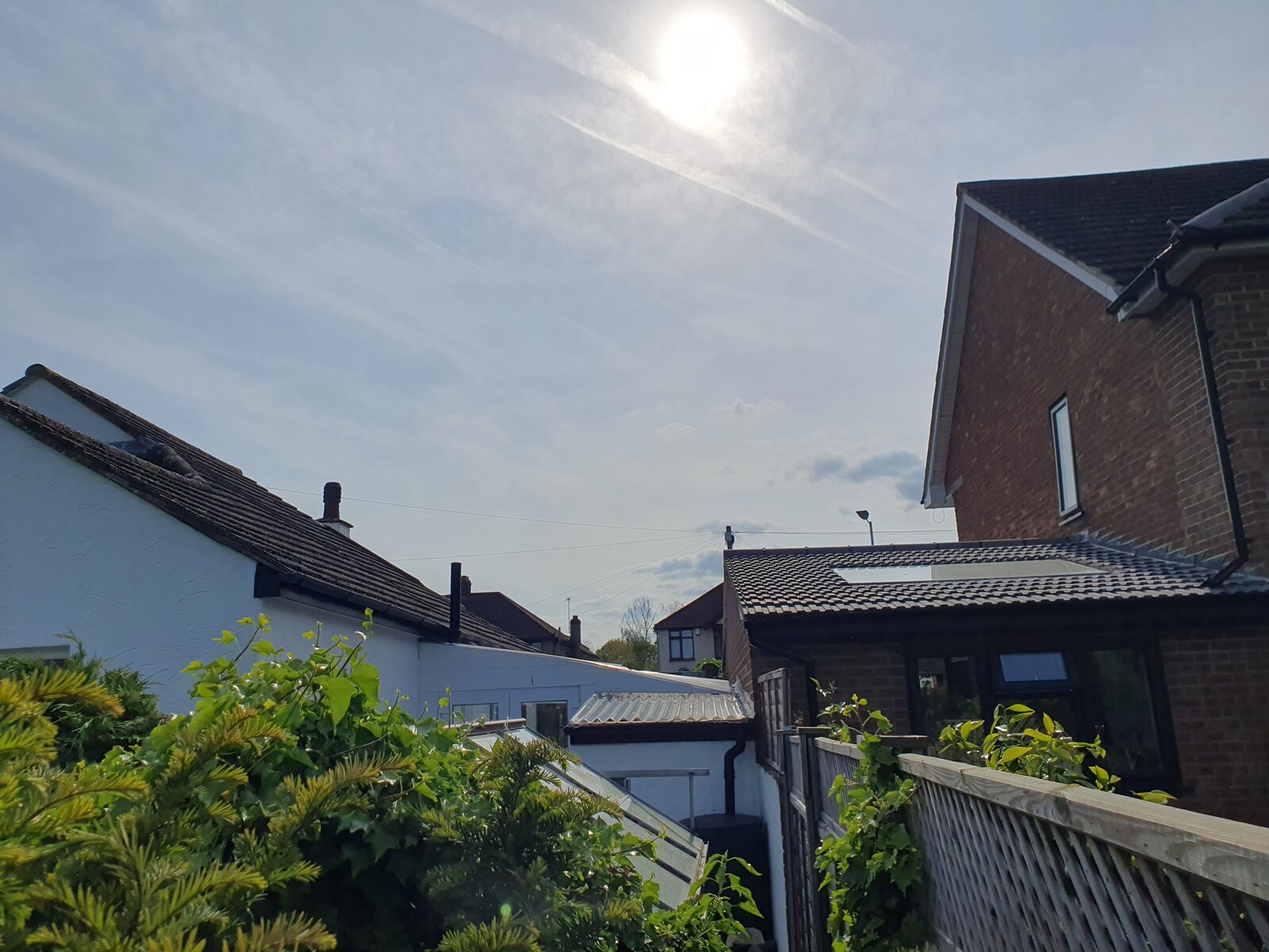

Thanks jb44, that's pretty clear. Unfortunately I don't think the neighbours want to listen to our advice or anything we say.
What can be done about their lean to? They've built it right up against the wall, so shouldn't they have notified me or something?
I need to stay on good terms because the builder said scaffolding will need to overhang over their property for the extension, so I don't want it to seem I am threatening them with costs.
I've attached a picture taken from my garden, you can see the gap towards the front where the ivy is (previous picture).

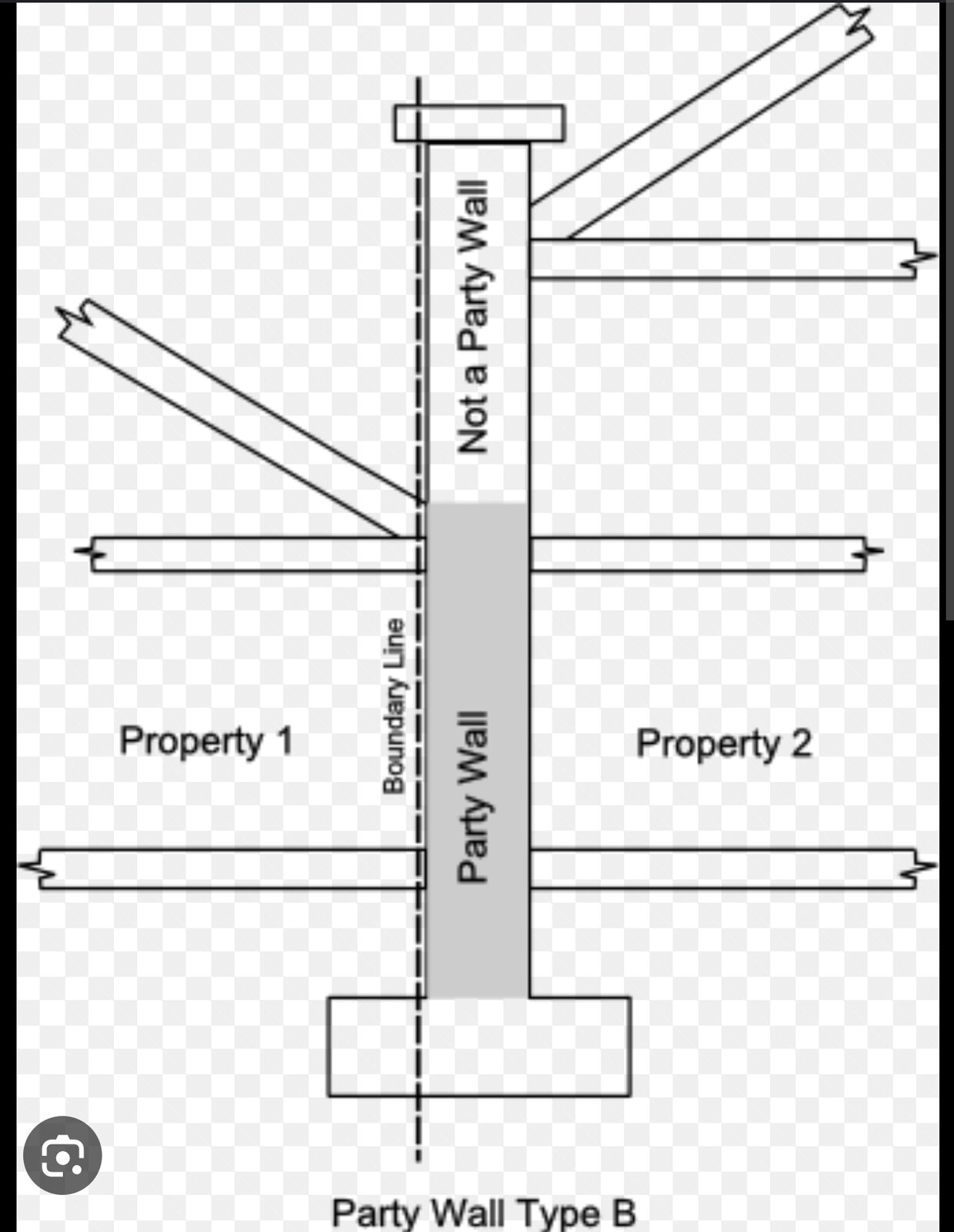

So after doing more searching and reading it seems its a type B party wall. They've basically enclosed their lean to against my wall and made it type b party wall. I have no legal documents or agreements for this - neither was I notified by solicitors about this when purchasing the house.
I'm getting more confused now. Where do I go from here?
