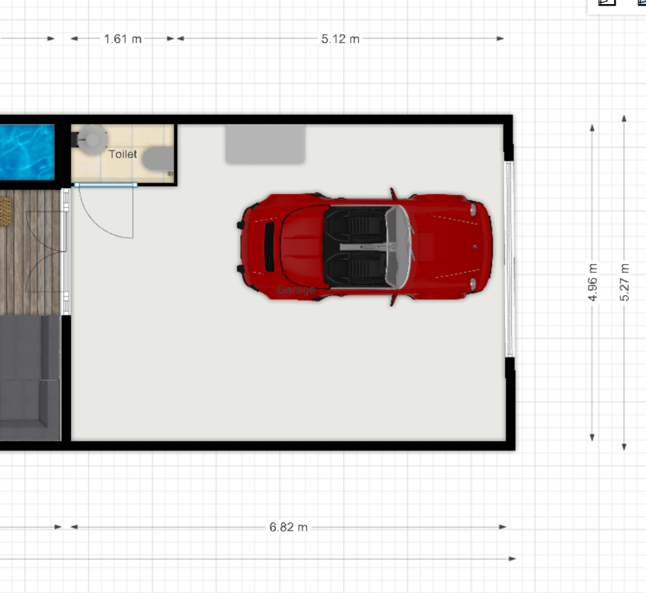

Currently in the planning stages of building a detached double garage at the bottom of my garden.
Approx 5m width x 7m length
2.5m eves and 4m at pitch
I plan to use breeze blocks and clad the house side with cedar the other 3 sides are hard against boundaries and private rear access road so I am hoping just to paint roof will most likely be tiled.
I'd like to insulate the garage, install power and mains water and if possible / cost dependant have a toilet.

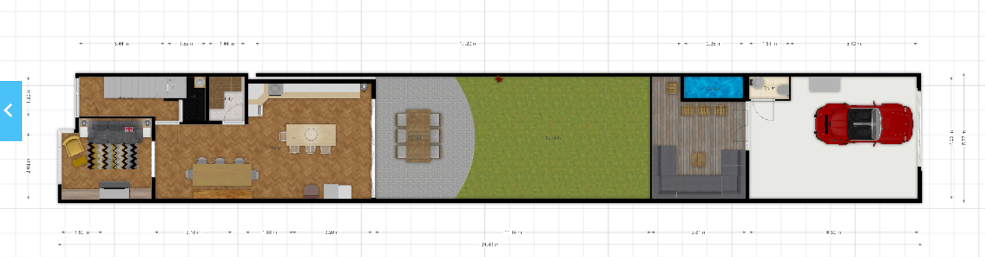

plan view of current plan, kitchen extension shown is also a future project

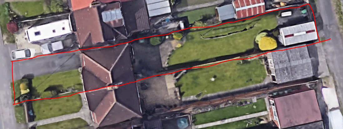

Google maps view of my house, the road to the rear is privately owned. The existing garage will be removed to be replaced with plan above
Sadly I don't actually own a porsche
I'm aware I will need planning permission I am based in the warwickshire does anyone have any experience dealing with that particular planning office and how likely my plans will be approved?
Also I plan to build the garage myself having never laid a brick before. I am competent at DIY but this project exceeds anything i've done in the past. Please tell me I'm not mad.
Is there anything else I should consider?
What level of detail is required to obtain planning permission

Planning should be pretty straight forward. The only aspect that needs planning is the height of the roof and 4m isn't crazy, especially if others in the row are that height. As mentioned it will need building regs for the structure as it is over 30m2. The electrics and plumbing will also need sign off. What do you mean by "breeze block"? Actual breeze blocks don't exist any more, if you mean aerated lightweight blocks then I'd reconsider. They wouldn't be great as a finished face and there is a high risk of cracking. It should be OK to DIY. It'll take you a lot longer than a pro to lay the blocks but if you do it methodically, carefully set up the corners to be plumb, keep checking with a level, etc you should get a good building. You'll need access to the outside of the wall to get a good finish.

Why do you think it isn't a garage? The building will most definitely be used to house and give space to work on a car. The power is required for lighting and to power tools and the water so I can wash hands without bringing it in the house. Same reason for the toilet also will be useful during garden parties.
Over 30sqm, you need building regs.
I thought so what is involved?

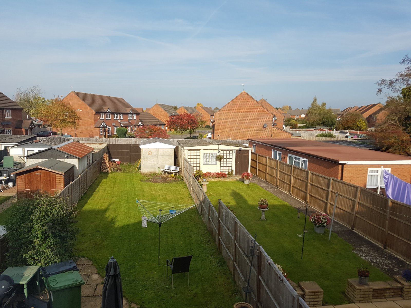

I was hoping planning would be easy, currently there are other garden buildings (see photo below) but non with a pitched roof however as it is at the end of my garden it wouldn't impede on the light to my neighbours.
I should have easy access to 3 sides of the building but one side I plan to build close to the boundary (which the neighbour has an existing garage next to)
I think i do mean Aerated blocks, the plan is to clad the house side in cedar and just paint the other sides as it won't be easily visible the main reason being keeping cost as low as possible. As I'm hoping to get it water tight for around £5000 and finished for £7000.
The garage will start where the existing garage starts and come as far forward as the neighbours to the right which is just over 7m.
As you can see the neighbour 2 doors down to the right has already constructed a substantial building.
I actually own right back to the second fence which is the shared access road.

One other thing. Looks like the garage on the right over sails your boundary then drops its rainwater. This isn't really allowed but I suspect there is little you can do about now. You will however have to think about how your building will abut this and deal with the rainwater. You don't want to just let it pour into the gap

I don't know if that is on / or over the boundary however the boundary fence which they own is further into my land than the garage is. They have been great neighbors so no point upsetting them by complaining about a garage that's stood there for at least 20 years plus. When I removed a chimney on the party wall they only asked me to stop after i'd be at it for 8hrs plus with the SDS (only discovered afterwards from this forum about the party wall act whoops).
I plan to leave a small gap anyway on that side other side want to leave around 500mm so I can access drainage etc
