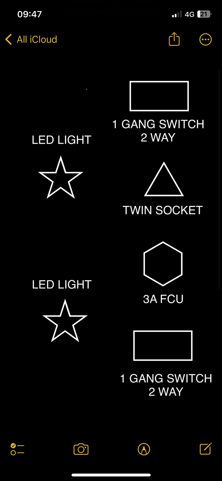

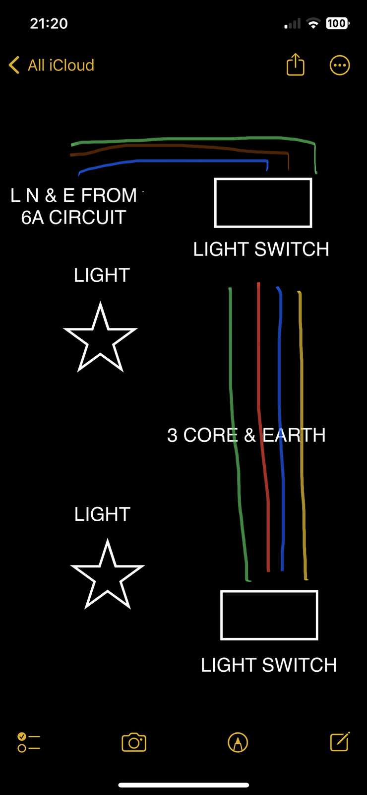

I have a garage with 1x twin socket and would like to add a fused spur with 1mm sq 3 core & earth
To control 2x LED lights which will come on at the same time from either light switch at each end of the garage
I know how to run a fused spur but would like to help on how to correctly run the lighting cable
I haven’t done this before but I am familiar with the terms permanent live and switch live and neutral and the terminals common L1 & L2
I have attached a rather basic diagram to explain the easier, if someone could assist I would be very grateful

What is the distance between switches and location of the FCU relative to the switches? I can think of a couple of ways to do it just depends on how much cable you have and want to run - one could need a junction box or terminal within a fitting if possible

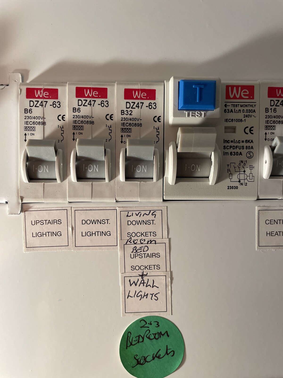

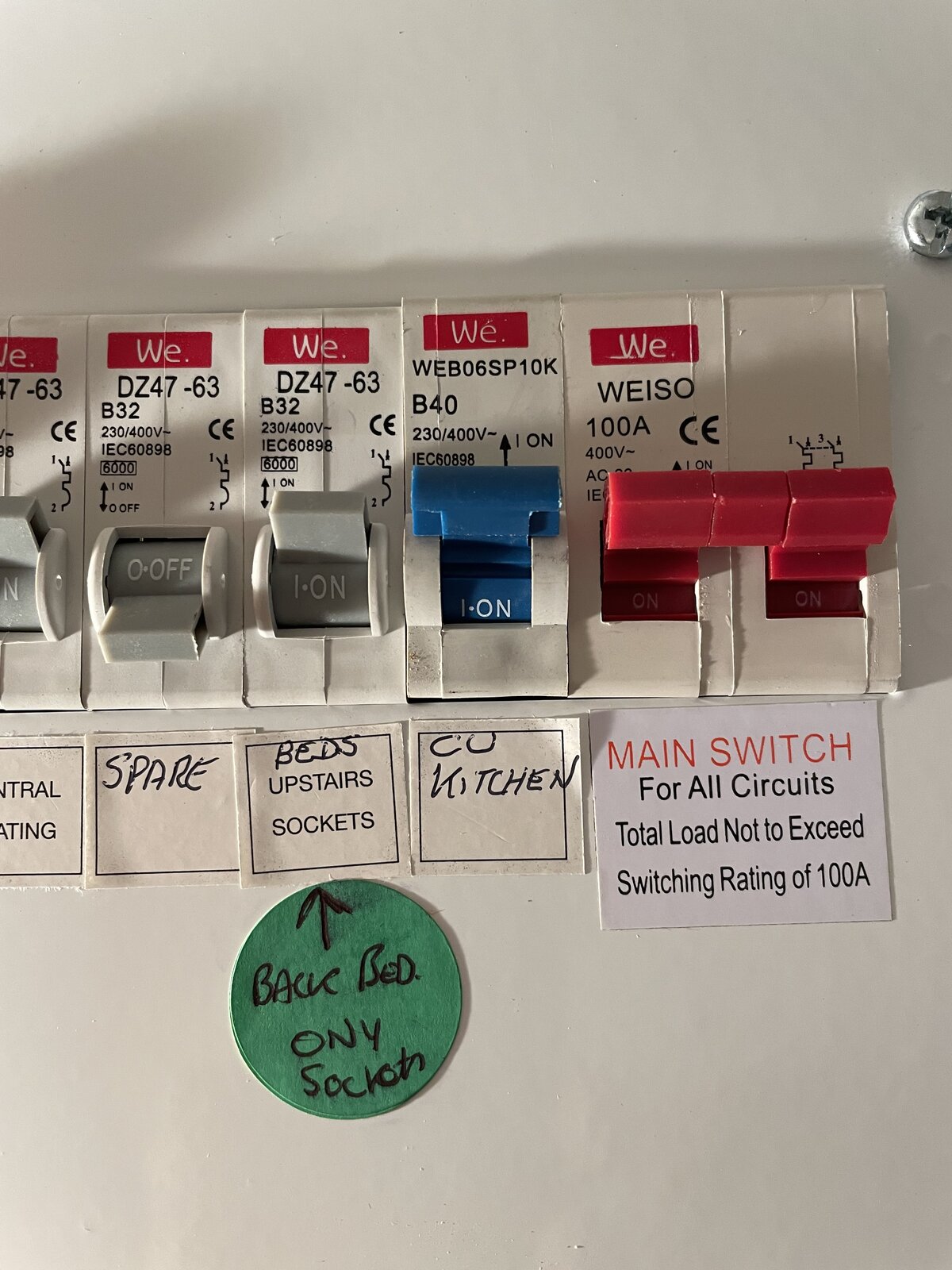

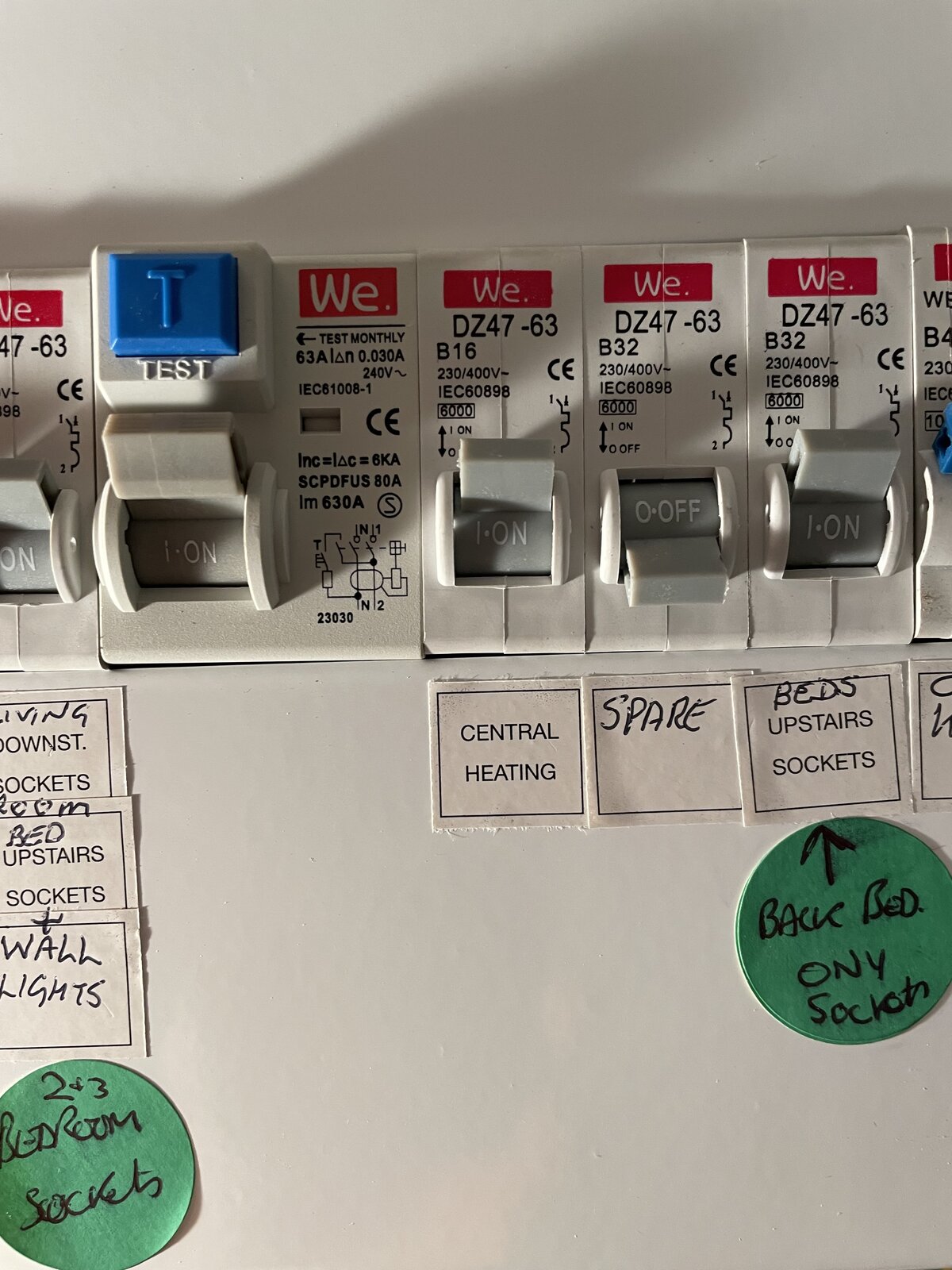

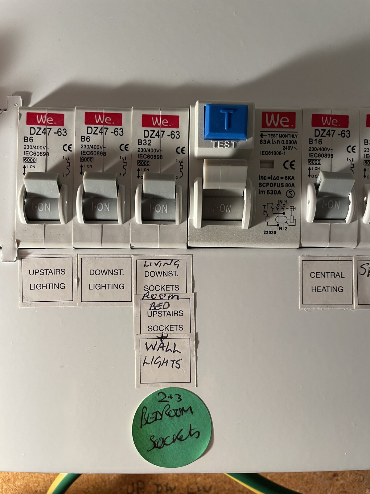

If unsure of RCD and what type of circuit the donor socket is part of ,show us a pic of your consumer unit ( or fuse box),and indicate which circuit the socket is connected to.

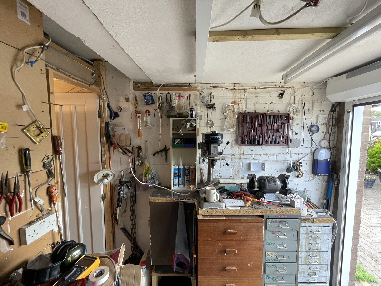

I will take some photos, I will be using a 5 amp fused connection unit rather than 3 amp now. I am unsure if the batten lights are LED having realised they could be fluorescent tubes so I will take photos and confirm to be sure
Are the light fittings already wired up ,and in use ,or are you installing from scratch ? Sorry ,but I am not following your description of the lights/ terminal block ,pics would be very helpful.

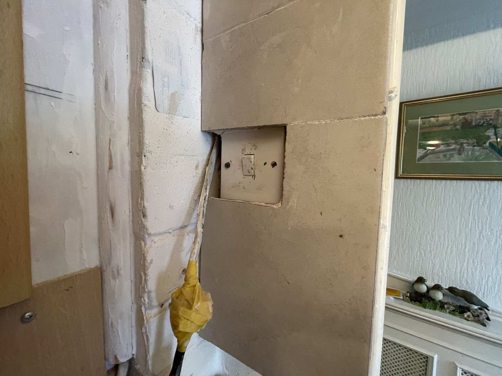

I’ve made this simpler as I found the original light switch hidden behind some tiles so I won’t need to take a fused spur from the double socket on the 32 amp ring main
I’ve continuity tested the 3 core & earth cable at both ends of each light switch successfully

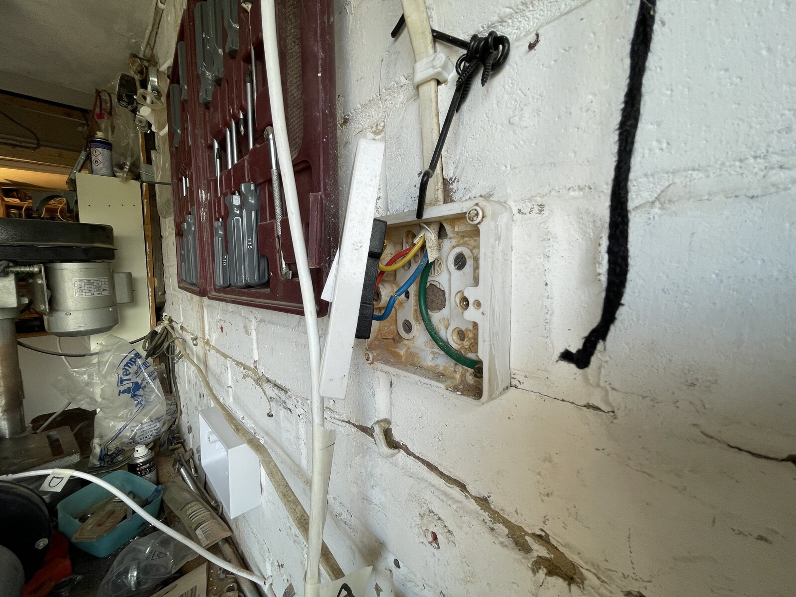

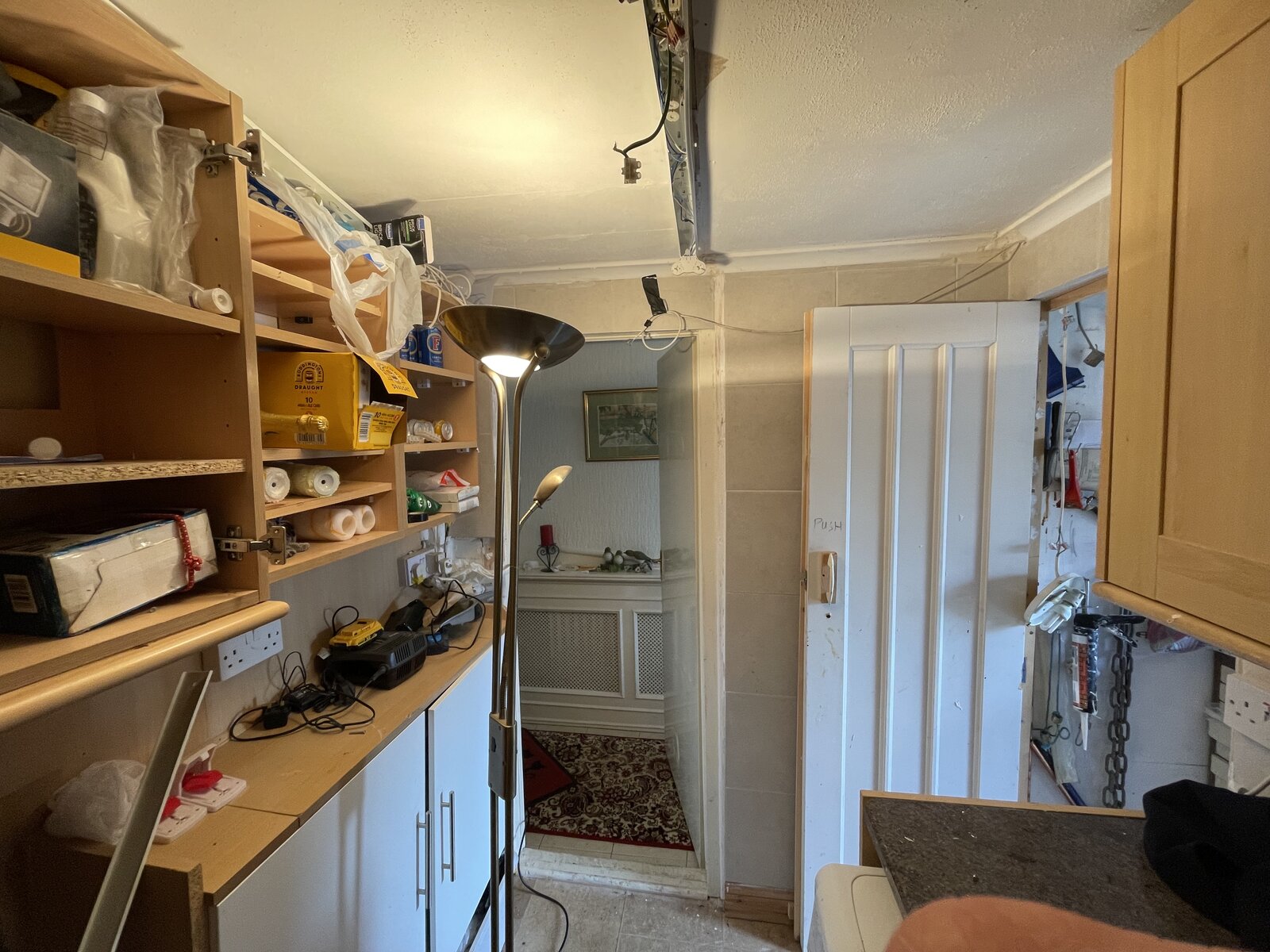

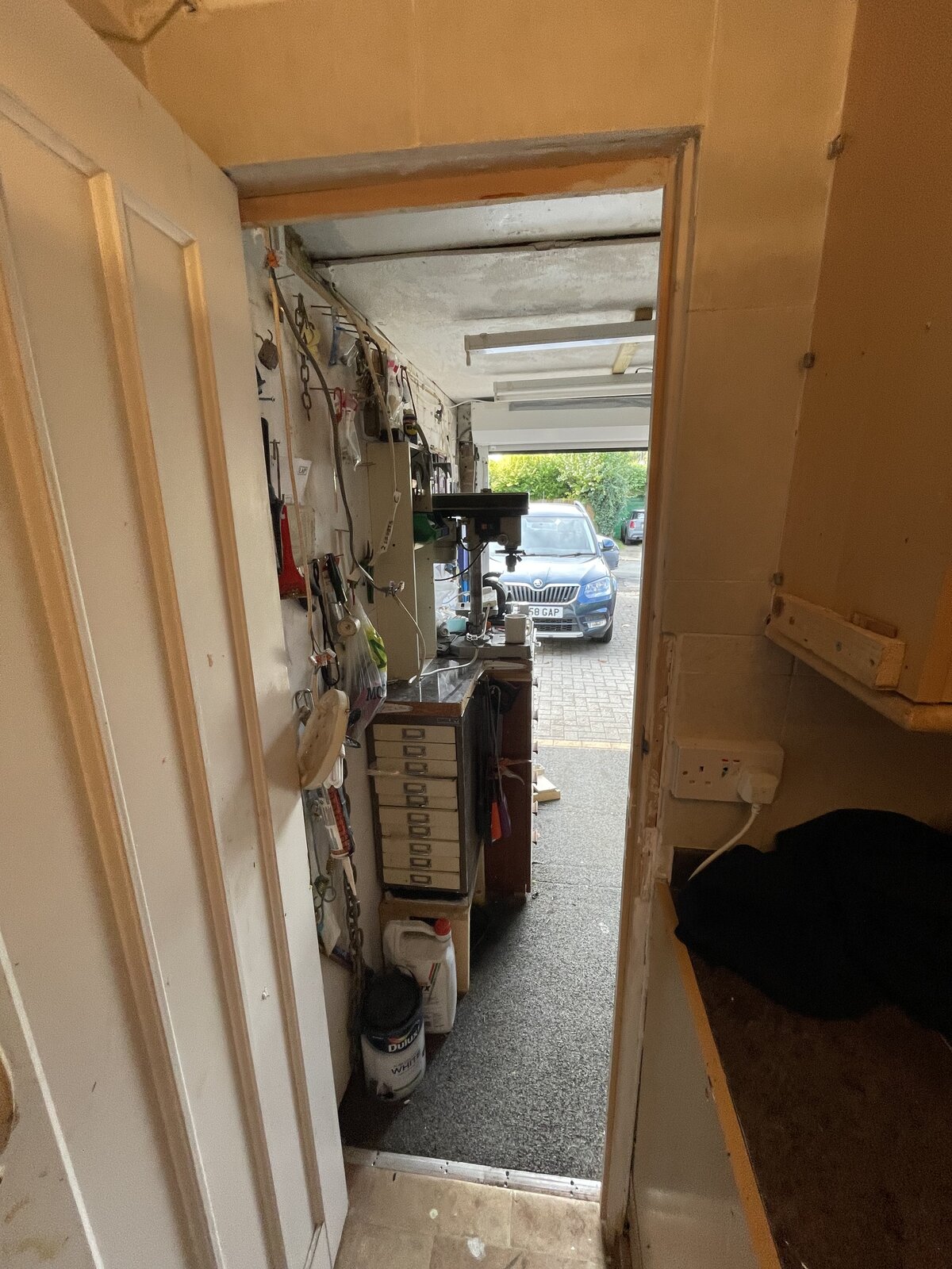

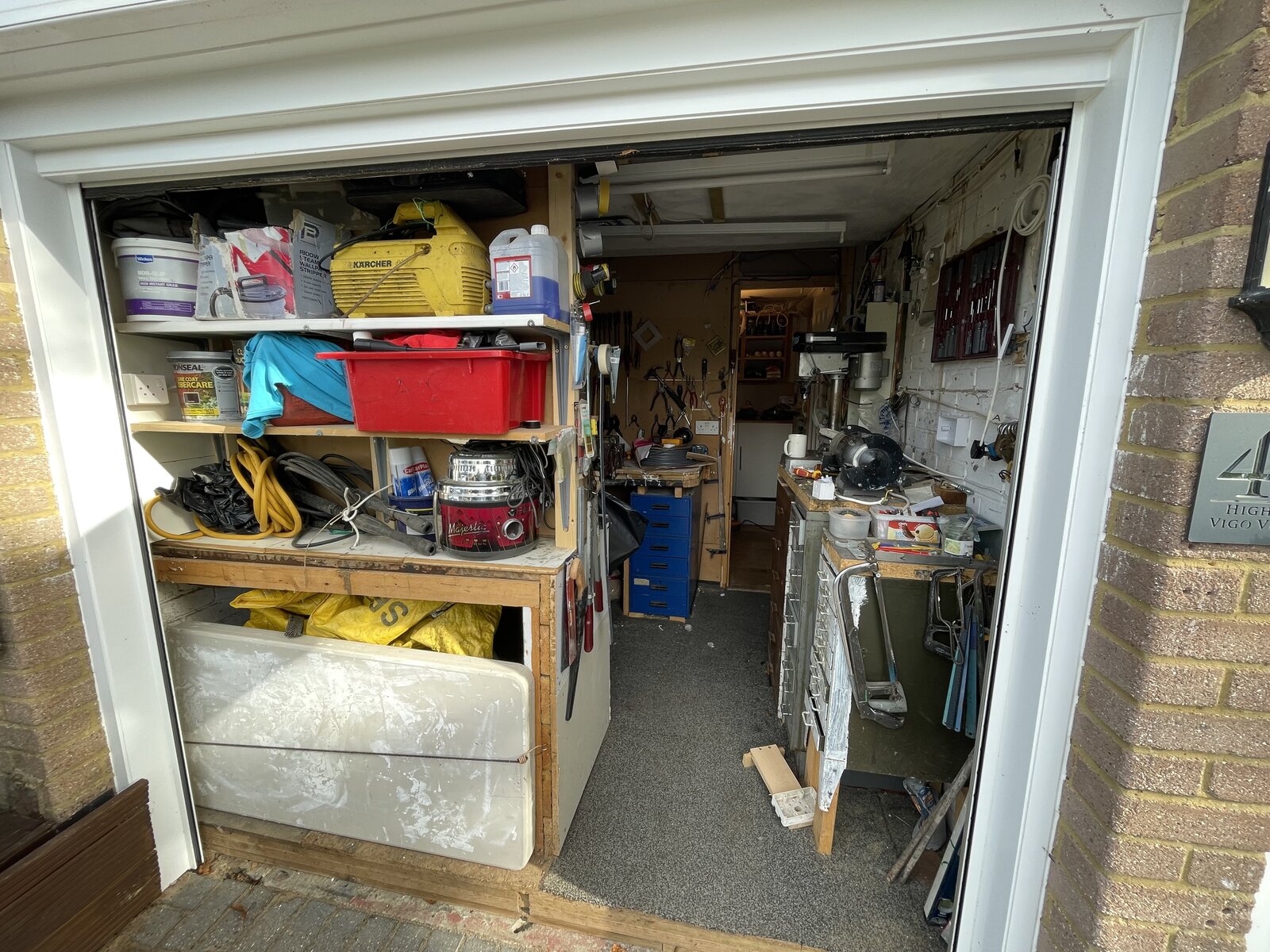

I’ve attached some photos for reference to show what I’m looking at in the garage

Latest diagram, the light switches have a cable in place but I am unable to work out what type of light switches I need and where to connect all the 3 core & earth plus the live neutral and earth from the lighting circuit

3 core & earth existing in place between both light switches, back boxes and front plates to be replaced once I know what type of light switches I need
Unsure if I need to wire both lights to each other or to both or just one light switch
Have you established which of the circuit breakers the existing lights/ switches in the garage are fed from ?
If you want both light fittings to come on/ off simultaneously ,by either switch ,you will need to connect a length of cable between them.

You will need two way switches ( 2 of them).
There appears to be a lot of dodgy looking wires and connectors hanging around,are you in the process of tidying all this up ?
The breaker is the 6 amp one 2nd from the left on the consumer unit labelled downstairs lighting
Would that be for example 2 core & earth cable between both lights or would it be the 3 core & earth between the light sockets?
Would it be a 1 gang, 2 way light switch, one at each end?
Yes ,both one gang ,two way switches.
The cable joining both lights would need to carry neutral,switched line,and earth. So yes ,twin and earth cable.
Yes the guy I’m helping has been adding all sorts of cables and connectors over several decades without realising he has made lots of spurs all daisy chaining from the ring main so I am disconnecting all of them and starting a fresh
