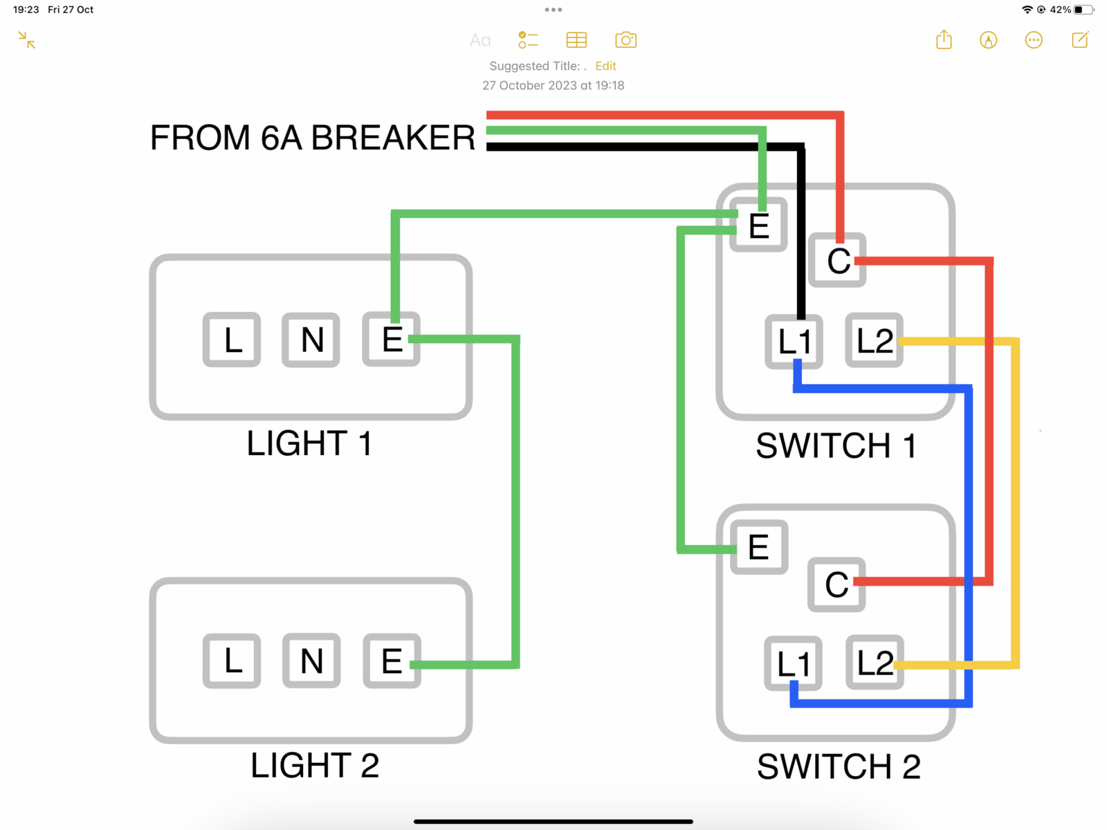

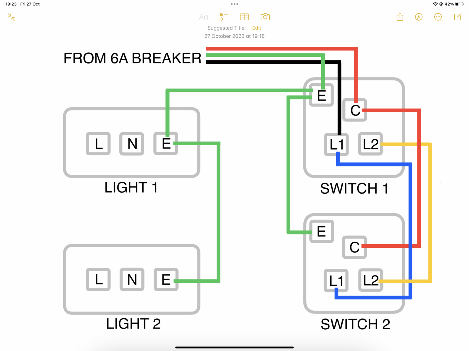

How about this diagram, is it correct so far?

It is ok,other than the fact that the black and red cable doesn't come directly from the breaker ,and there is no neutral present.

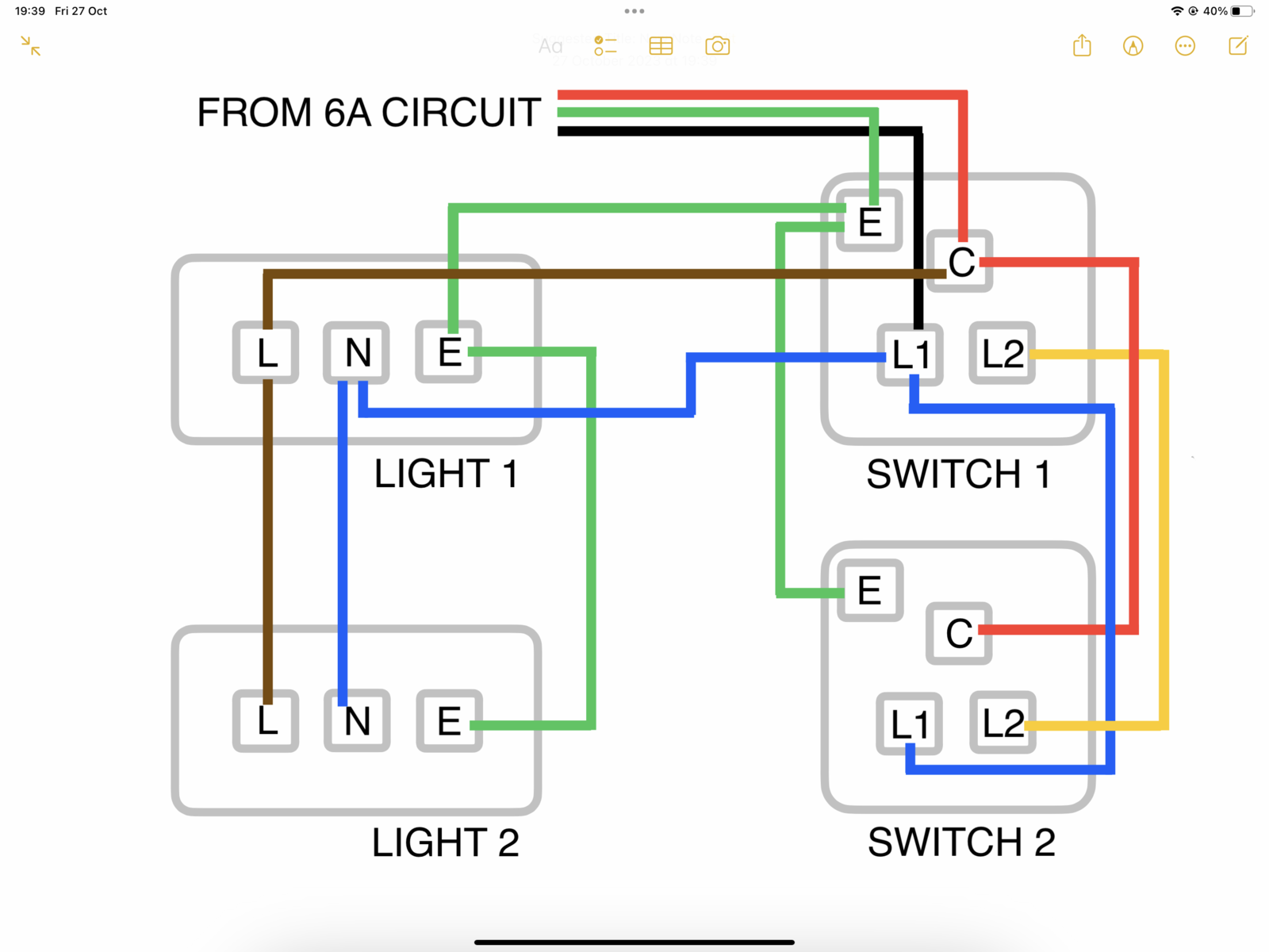

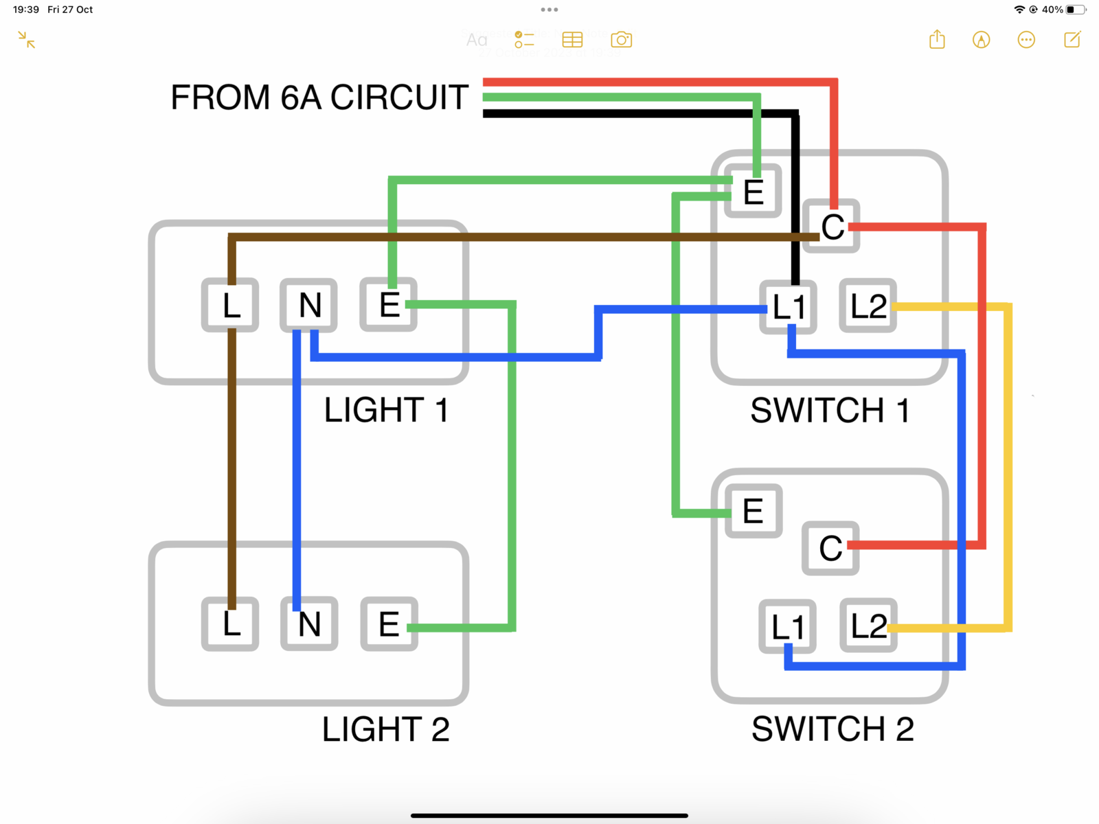

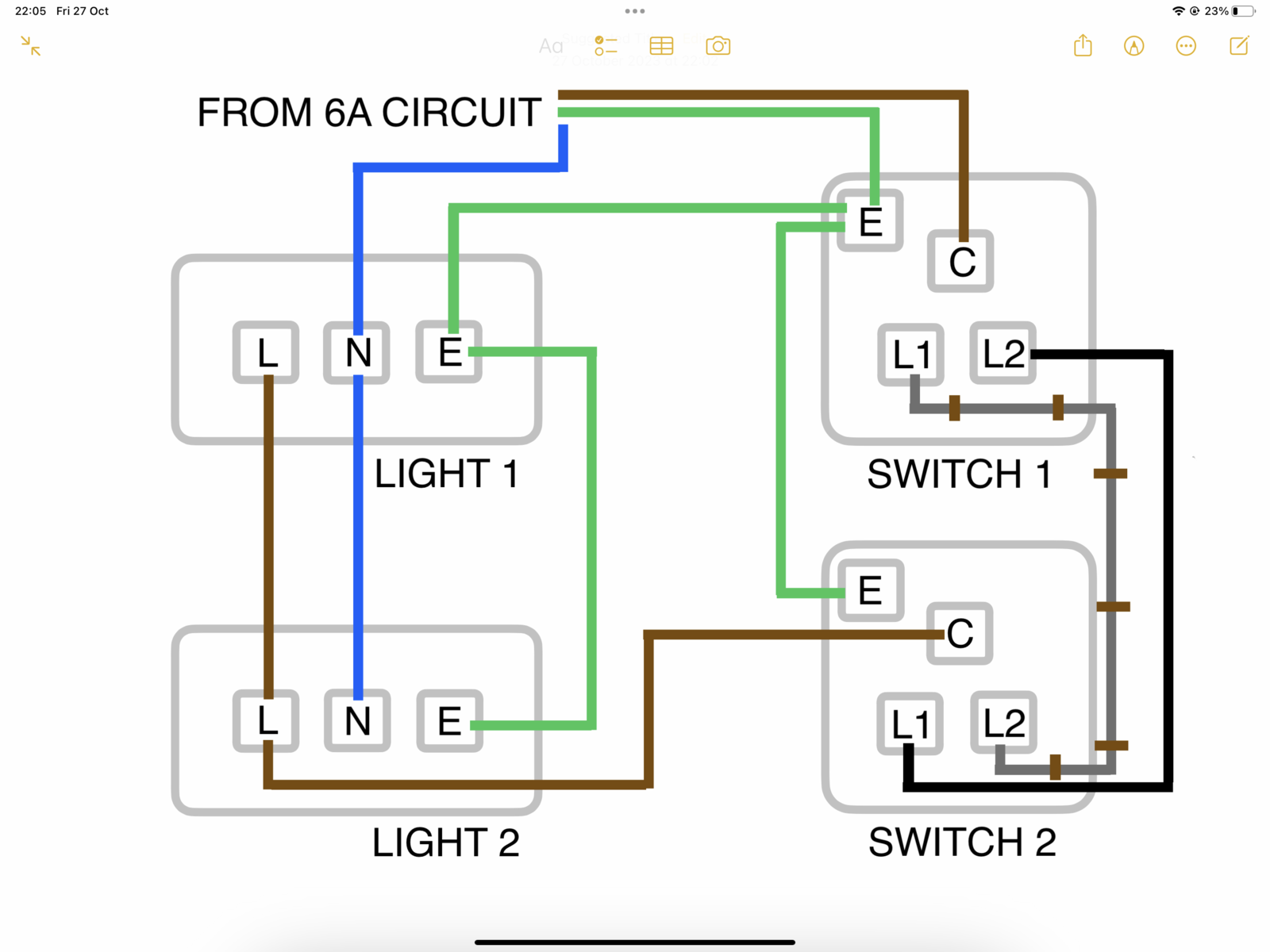

I’ve added some more to the diagram what do you think ?

Completely wrong. The black wire in the cable which also has a red wire is not a neutral. That cable is the switch cable, red wire brings voltage to the switch ,and the black wire takes voltage up to the light fitting/s, it is the switched live.

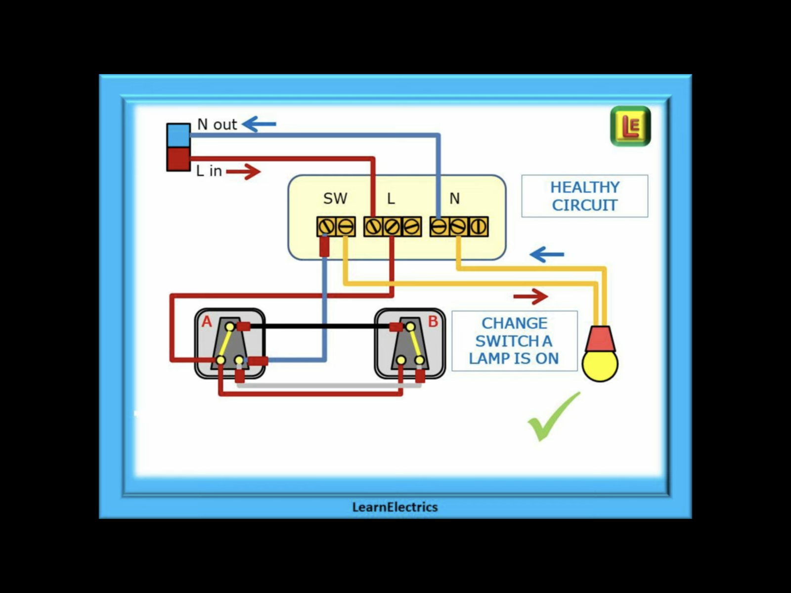

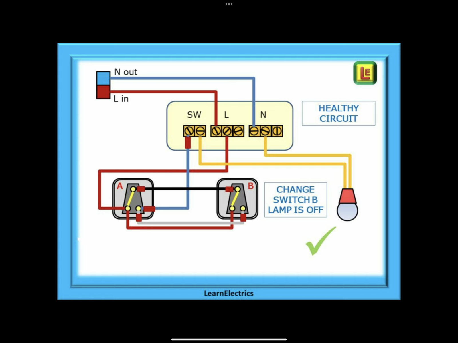

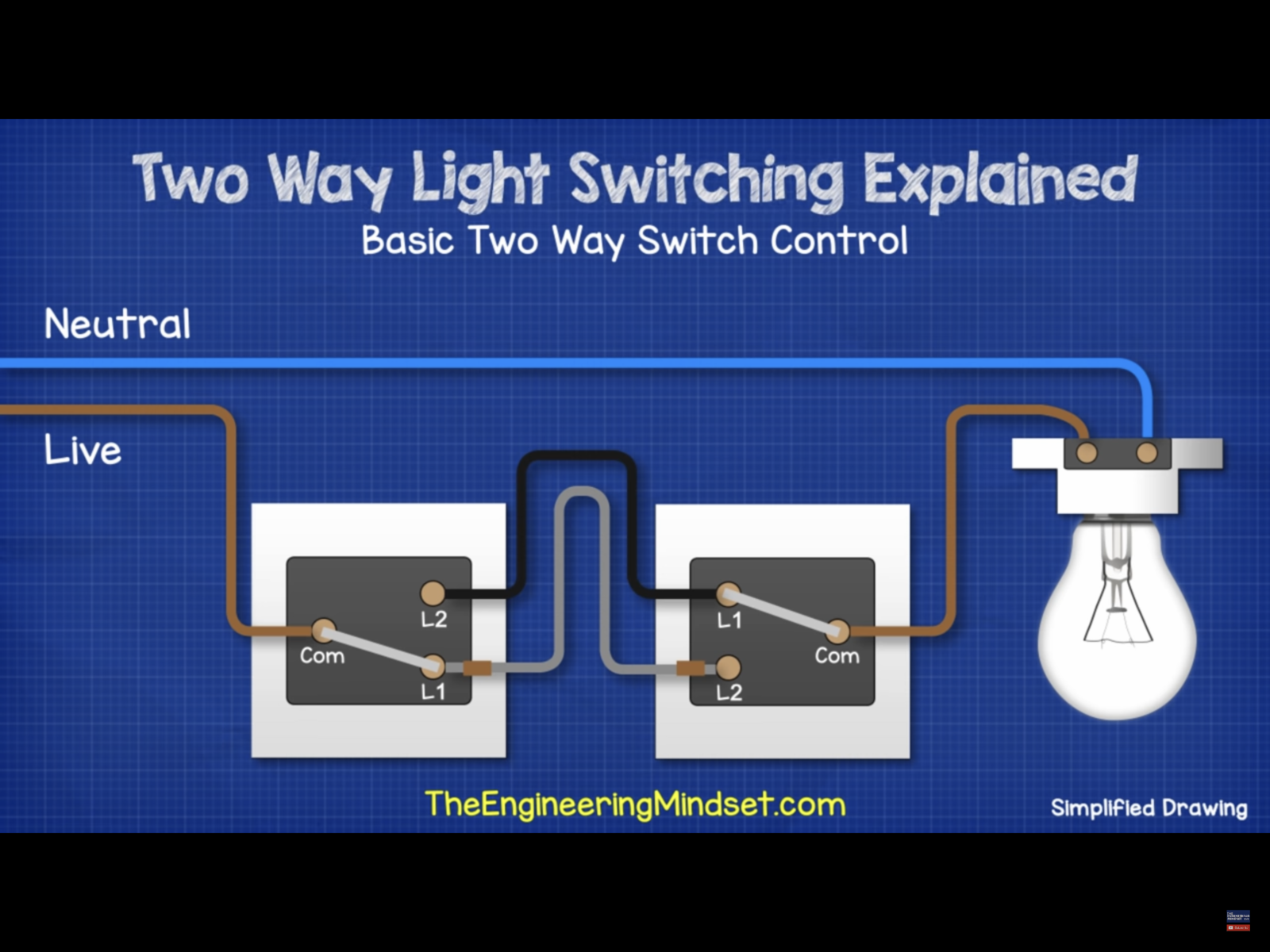

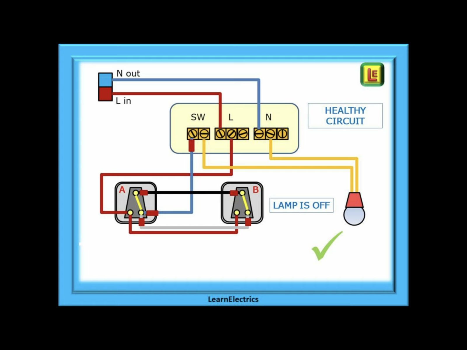

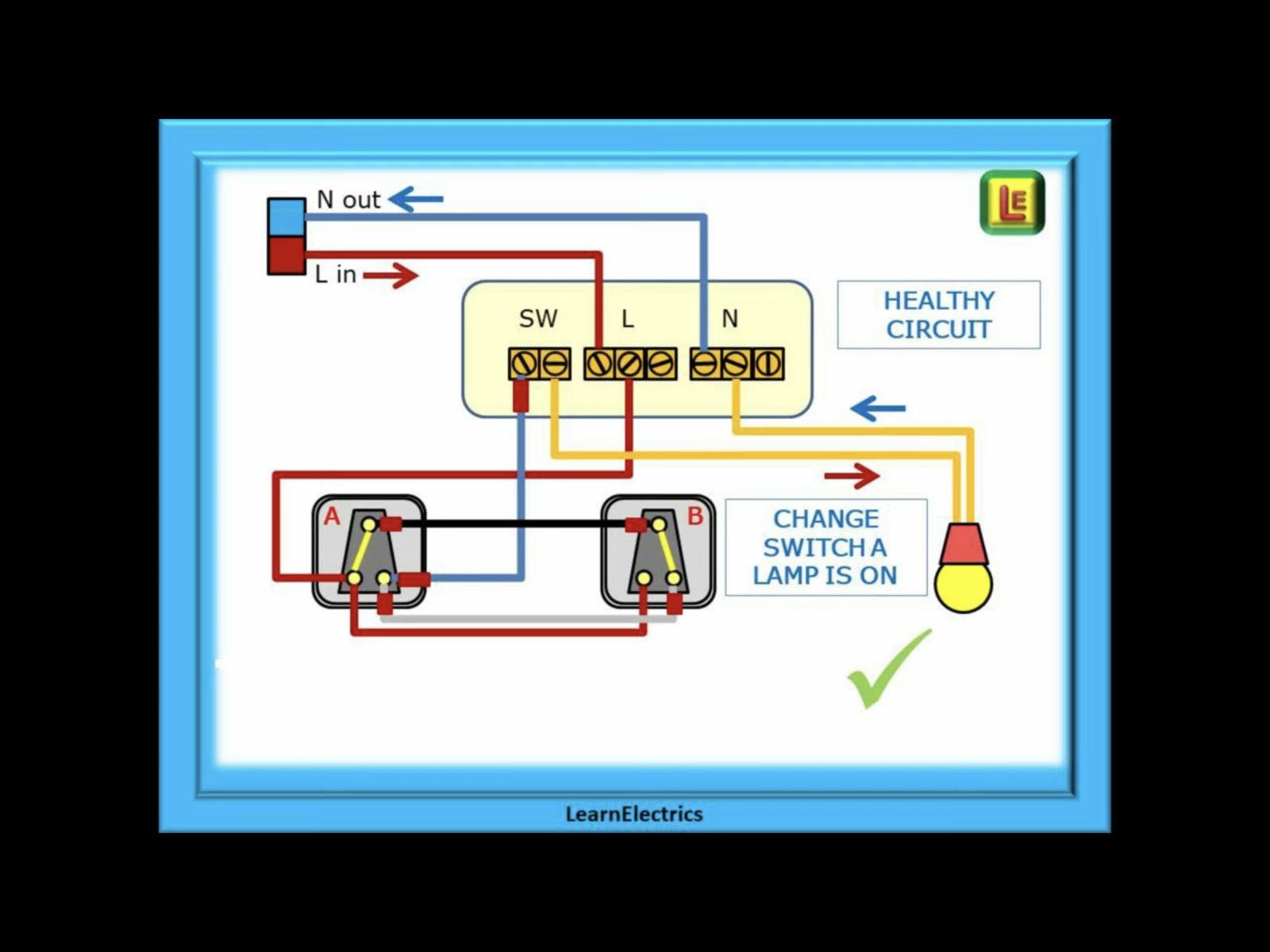

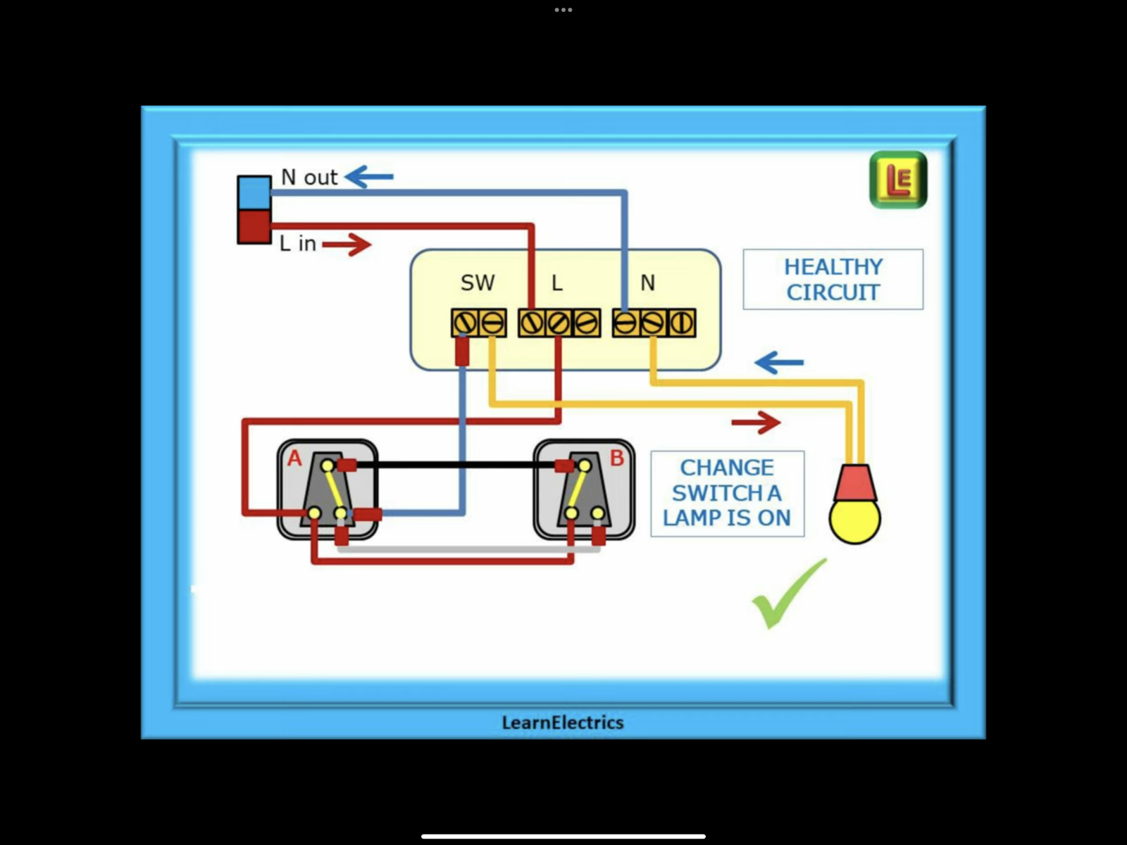

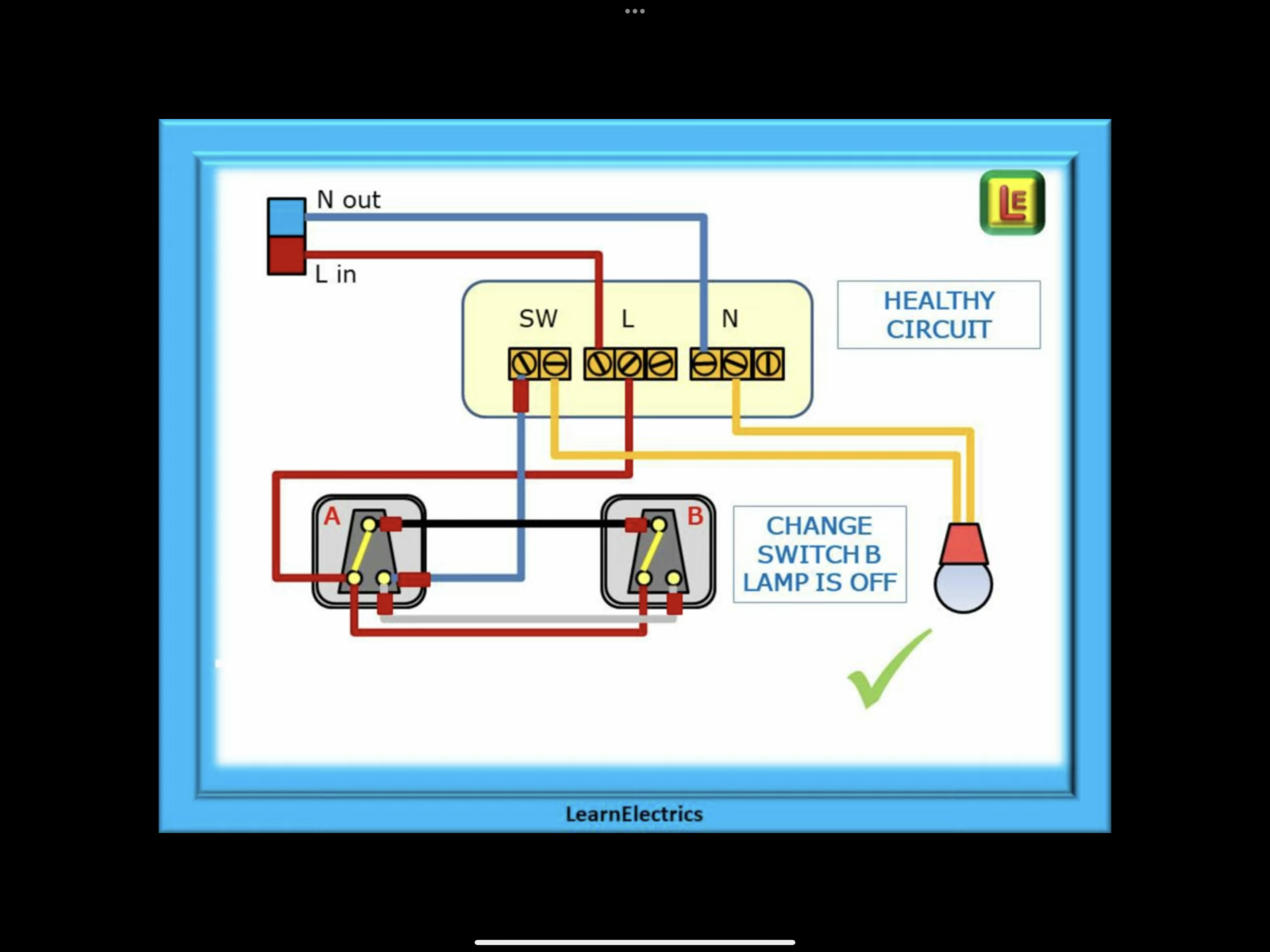

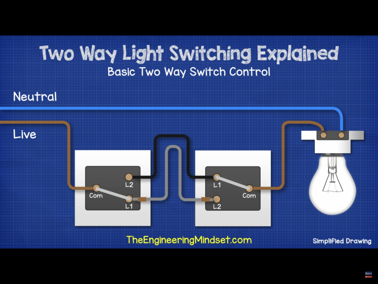

I’ve tried to make a new diagram based on what I saw on this link, the video only has 1 light so my diagram is probably still not right

Your diagram represents one way of doing it. Unfortunately it doesn't fit what you currently have. The current cable ( with black and red wires) that goes to the switch that you recently found does not have a neutral conductor, as is depicted in your diagram.
You would need to do a lot of rewiring if you want to wire up as that diagram.
You really don't need to do that.
You currently have a working set up ,as I understand it,so besides fitting new switches and running a new length of 3 core and earth ,what else are you trying to achieve ?

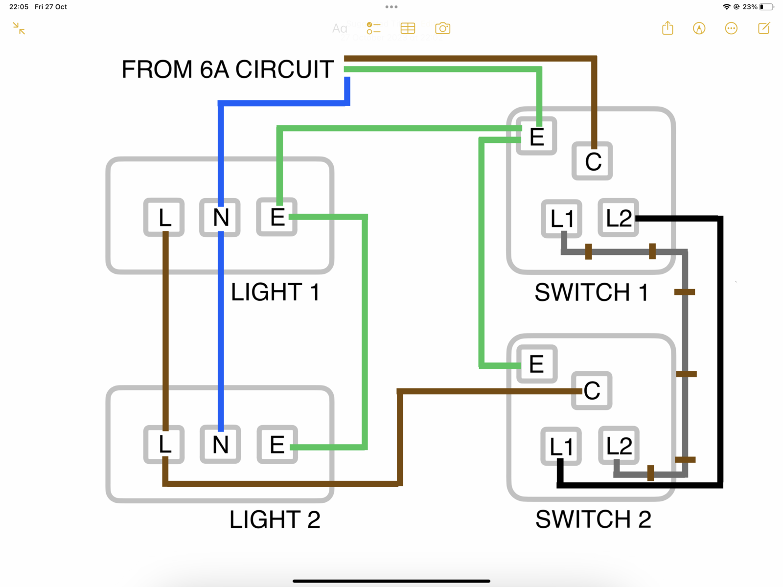

I appreciate all the assistance on this it’s really helped me, the homeowner wants to have the wiring replaced entirely so I’ve got my electrician visiting next week to check the incoming feed to work out where it’s coming from and make any change’s necessary to let me run new wiring with the current colour codes

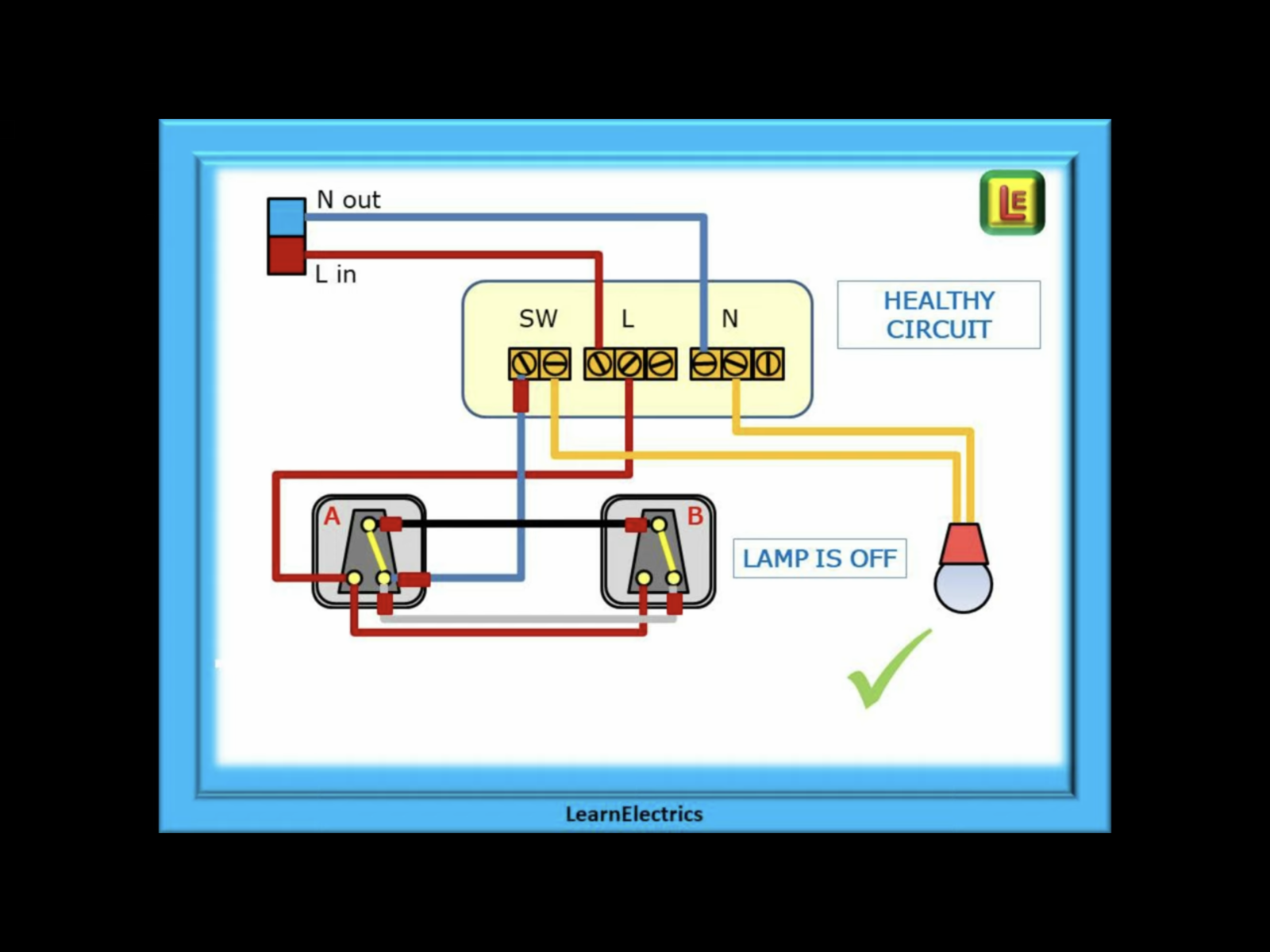

Anyone reading this in the future these diagrams will help
