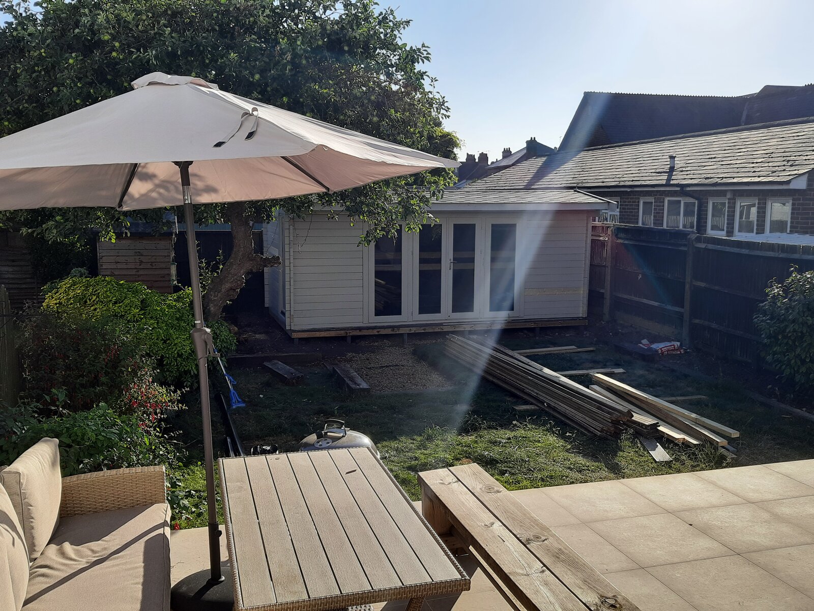

Quite pleased with the cabin so far, still need to complete the decking, gutter and electrics.

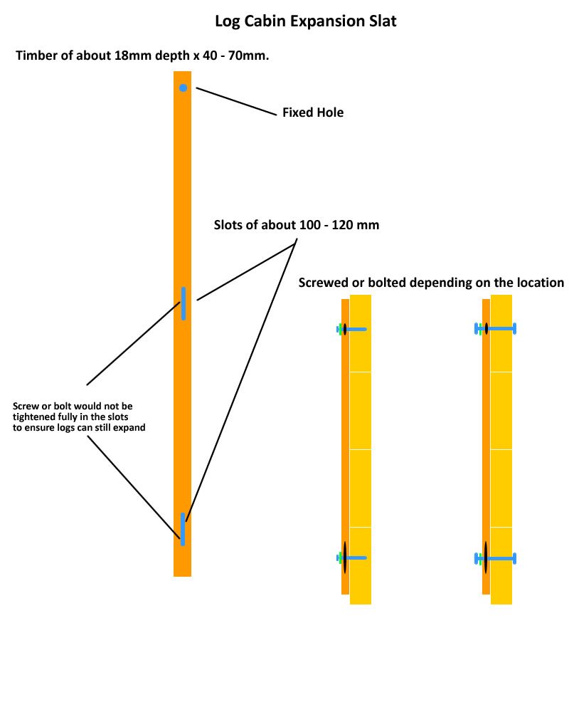

As we are getting into the winter months, I'm looking back at getting our cabin insulated - thanks for all the advice so far
From what I have read, the best option I think would be to fix treated wooden battens to the top horizontal timber of the cabin, with slotted holes further down which allow the further fixings to move as the cabin flexes...
I've attached a picture from the Tuin site on what they recommend
We want to attach cork insulation panels to these - if there are the wooden battens behind the insulation panel I suppose there will be a slight void of some sort... is this a problem for moisture etc.? Will there need to be some lining behind cork panels or does it not require them?

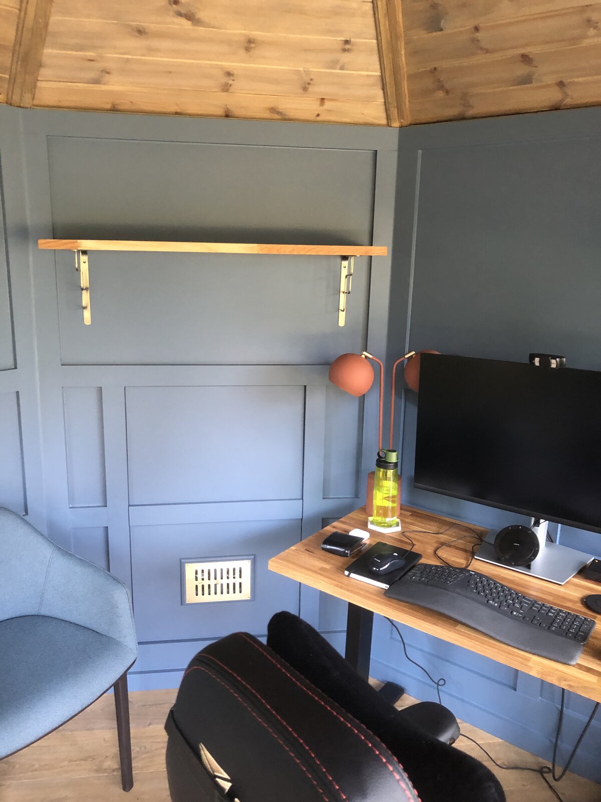

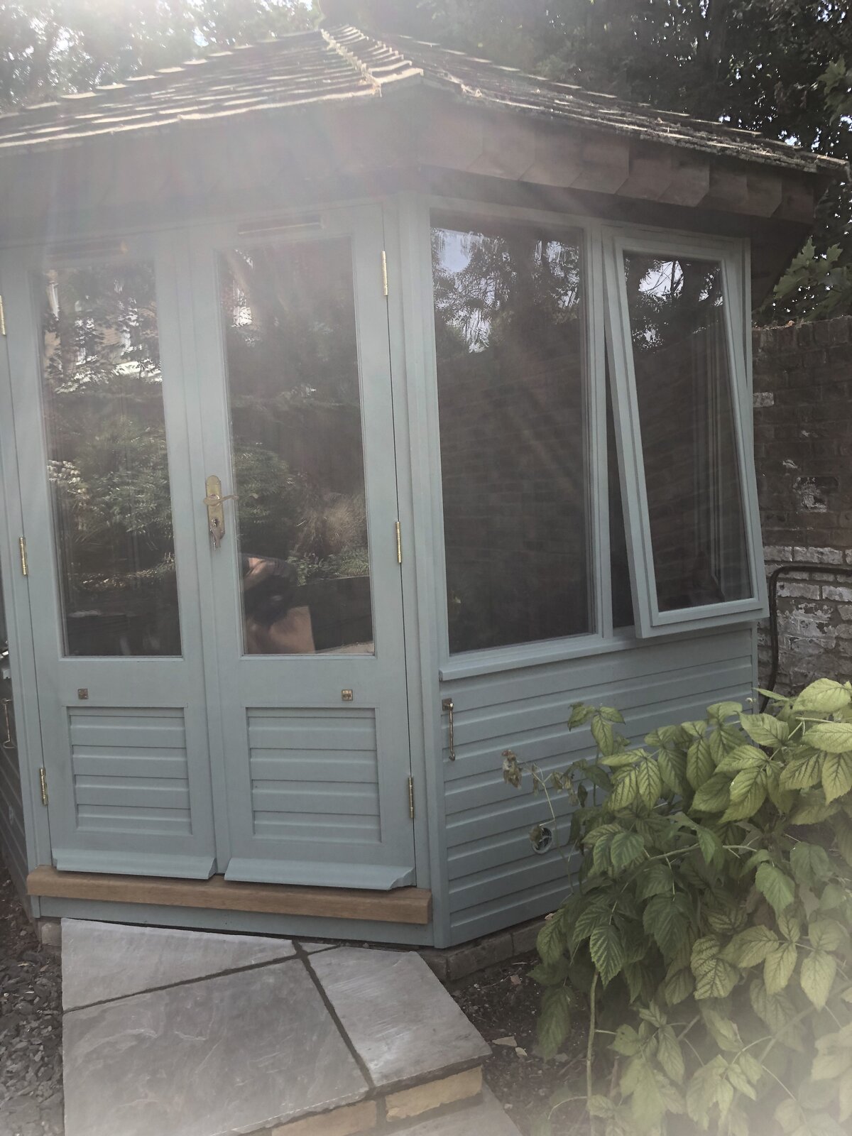

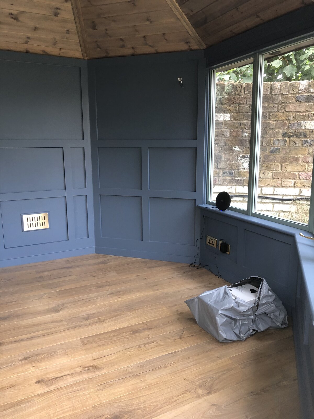

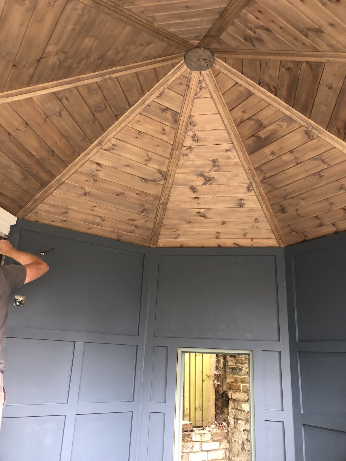

Converted summer house to home office for a client, underfloor heating , insulated all round , but this doubled the existing depth of the wall which were finished with panelling.Glazing replaced with double glazing units .Hexagon so a real pain with all the angles .WiFi was fine with s as signal booster
