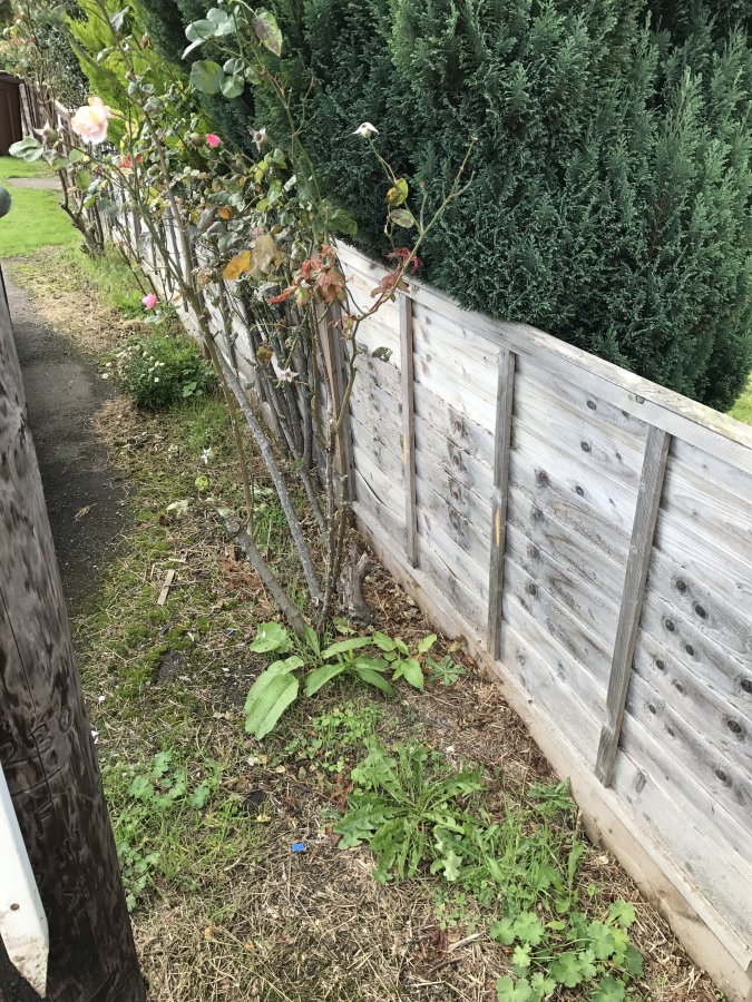

Hi
New to this forum hope this is the right palace to get some generic advise and views
We are about to buy and have had an offer accepted on a country property but currently only has parking on the road in front of it however the front garden is big enough for at least 3 cars if not 4 now I understand I can turn the garden into the drive as long as I use a material that drains away which is fine was just going to use gravel to Keep it low cost
My question is regarding the kerb issue and pavement
The garden in essence ends at the road there is no obvious kerb or pavement it just goes from my fence then behind it is the start of the road tarmac and a tiny bit of grass.
so can I clarify, could I just remove my fence and that's it or do I still need councils permission becuse if I create a drive what's stopping other people blocking it.
Where I would be entering my new drive is essence where we or other people in the few houses would park currently.
Attach a very bad picture of the transition from road to fence.

Do you own the verge? if not it will likely be council land - there is a process that will allow you to us a section for access.
Is the road public or privately owned ?
You should speak to the council planning team about a new drive way access - They should provide a chat free of charge and this can save you a lot of angst (and cost)
I know a lot of people open up thier gardens for hard standing without consulting the council, but you should do it properly. If you want to enforce any parking that blocks your drive then you need it to be an authorized driveway access.

Normally you would apply for permission to have a drop kerb installed by an approved contractor.
You seem to be rural so no kerb but as said you probably need written permission to ensure access.
Possibly look at houses up and down the road to see if anybody else has done the same.
Yes a dropped kerb application really. Look at your local authority's website for dropped kerb applications all the information including the forms, the cost, what they expect to be submitted with the application and most important;y the criteria by which they will determine your application. You will be able to read that guidance and get a very good idea if your application will be acceptable or not. I can't see you getting anywhere by trying to speak with anyone from the council they will merely direct you to all of the information that is already online as I have just described.

Thanks will take a look, i fully aware that if there was a kerb and a pavement i would have to go though them but there is no kerb and no pavement its direct from road to my fence with a very tiny bit of weeds and grass (likely just to be where its taken hold)
Thanks All
Well actually they're actually called Domestic Vehicle Crossings, that is an application to cross the footway or highway verge to gain access to your property however they're often refereed to as dropped kerb applications and the actual process of dropping the kerb has little to do with whether permission would be granted or not.
And if its a designated road you might need Planning Permission to form a crossover.
