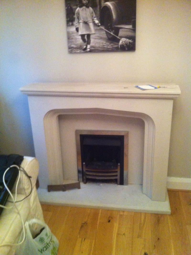

The front room of our 1930's house is never used much so in a mission to restyle it, I've decided to remove the cheap, stone effect, fireplace and replace it with a wood burning stove.
The previous owners have bodged pretty much every aspect of the house so I'm on a crusade to slowly get everything fixed.

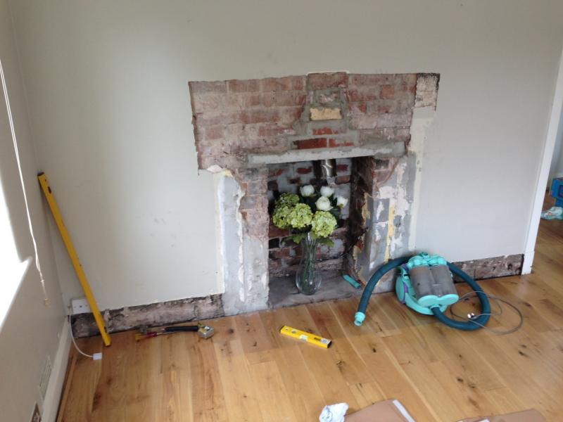

Here's the fireplace in question, looks ok from afar but never used and cheap
I got a HETAS bloke round who gave the chimney the OK and capped off the gas supply, time to get busy with the SDS drill..
Around 30 minutes into the job the ghost of owners past rears its head again as you can see:
The builders opening is supported by the chimney register plate, that's it, no lintel, nothing. The bricks are all loose to the touch and the mortar is all crumbling so my first job in the next few days is to sort this mess out.
I'm going up above the breeze blocks with a concrete lintel and am going to rebuild the bricks above.

Bricks were easily removed by hand from the recess and the whole area cleaned up.
New Lintel
As far as I'm up to now, not rushing anything as the summer's so nice :cool:
I've got a man coming to line the chimney at the end of the month (payday!) and then I'll get the rest sorted the month after (waiting for yet another payday!)

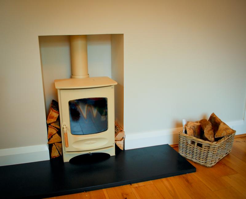

It's been a while so I thought I'd post the finished pictures of my fireplace.

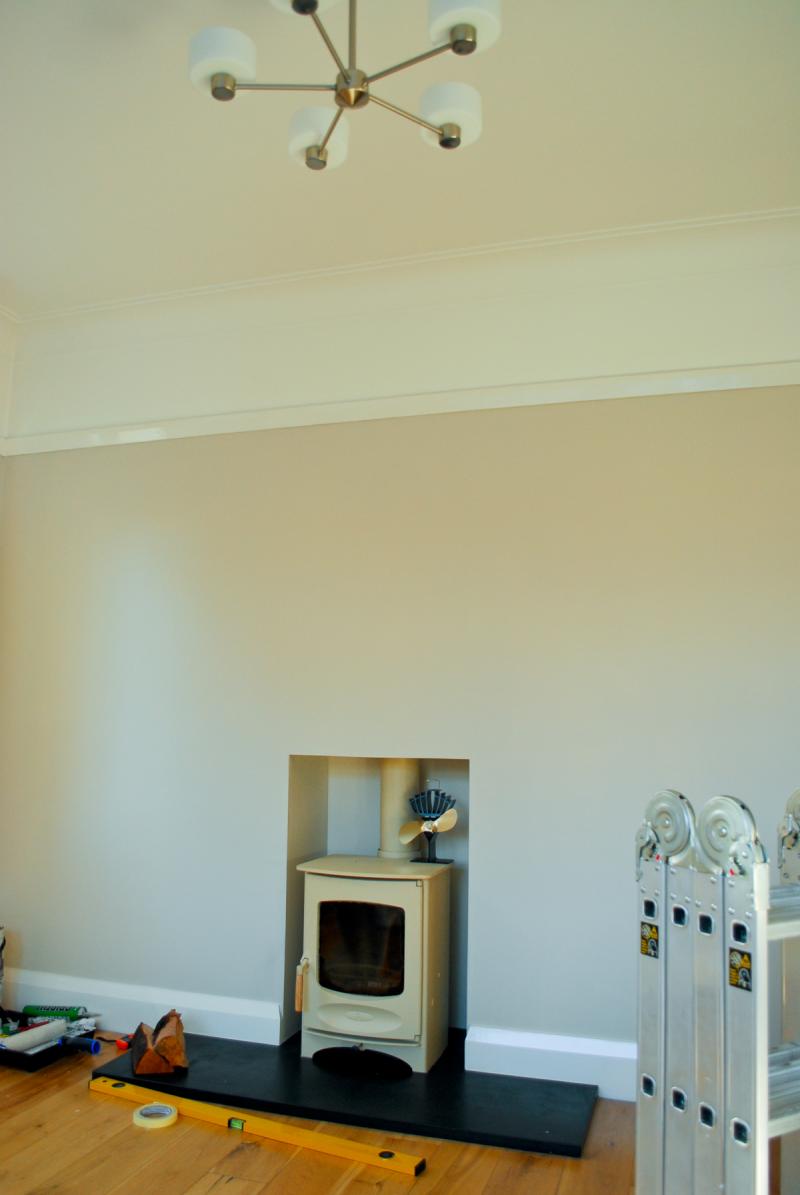

It took a month for the stove to arrive, and another couple of weeks for the plaster to dry and paint (you can't plaster before the stove's installed as the installer needs access from the bricks above the lintel).
Here's the final result, I'm chuffed with the finish and it's a great, hot, little stove when running at full chat. Well, onto the next project....
You shouldn't store your logs in the sides when the fire is in use as they can combust!
Who told you that? Ive installed hundreds of stoves and never needed to get in above the lintel in order to fit.
Most of the time, even with an open fire fitted with a gather and liner, it can still all be done from inside the opening.
As there was a delay on my stove the register plate was fitted and the recess boarded before connection of the stovepipe to flue. If the wall had been skimmed prior to connection then it would have been impossible to connect the two, ref dann09 post above.
