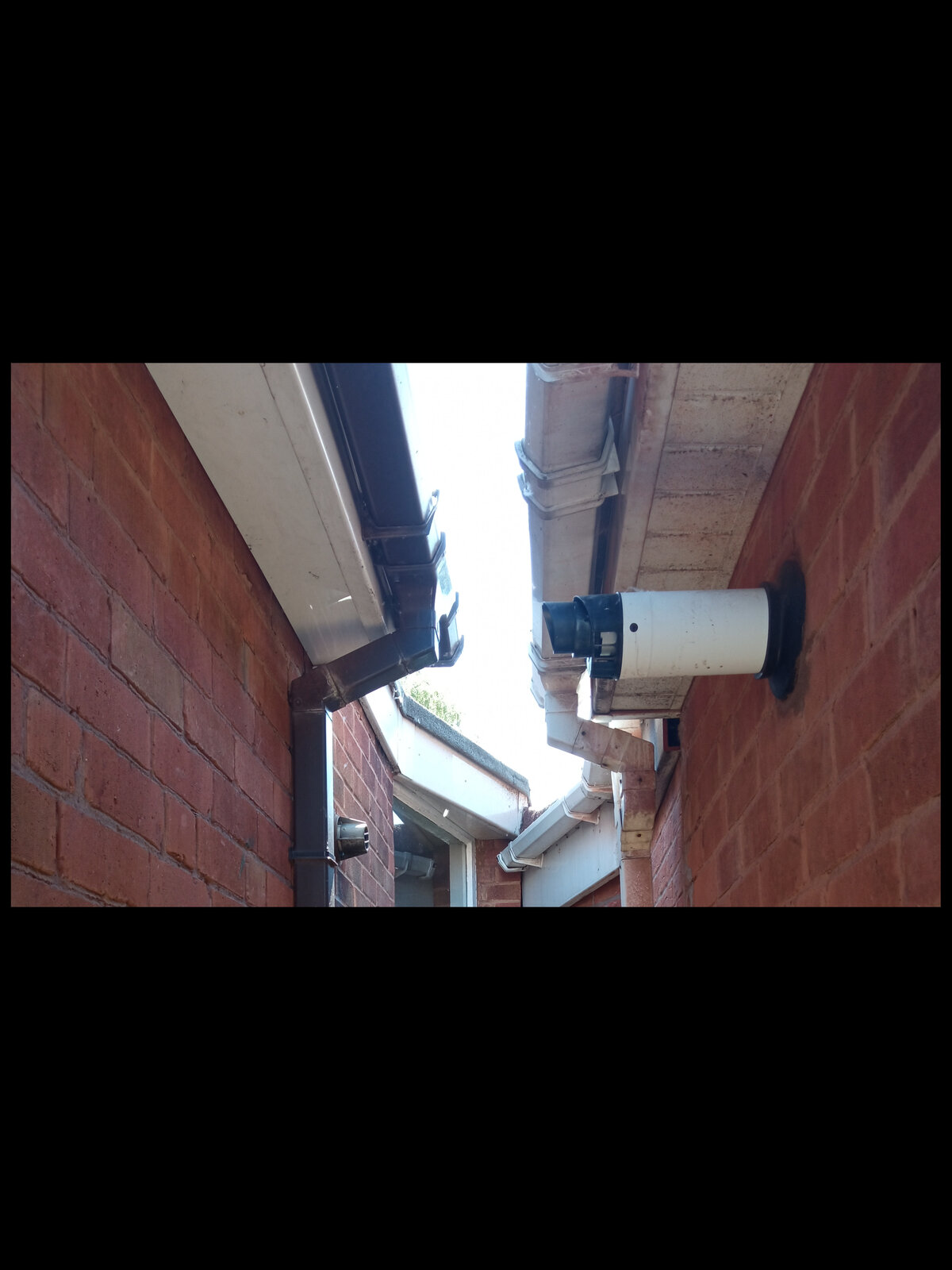

Hello all,
I've been searching and I can't see any similar thread. I'm after an opinion as to if I have anything to worry about with respect to the location of my neighbour's flue.
It's situated in an entry way, approx 45cm from my wall, guttering and soffit - I'm getting a fair bit of condensation forming under the guttering, soffit. To cut a long story short the inspector from Gas Safe says that he would have it taken back - can't enforce as my neighbour hasn't responded to their request for inspection, my local council (Birmingham) have stated that even if it is breach of that 60cm from boundary thing, that's just a recommendation not a requirement.
So, I'm in a position where I'm stuck with it, any comments would be welcome as it is something that's on my mind.
Its location could constitute a statutory nuisance, quite apart from contravening the installation regulations. Contact Environmental Health

The 600mm clearance is in “Part J” of building regs - so is mandatory.
The extra dimension for nuisance pluming is probably not a legal requirement, but could form the basis of a private action

No, it isn’t “just you”. The flue is wrong

I would reapproach whoever said it is guidance and quote Part J of the building regs. Building regs are statutory requirements (as opposed to British Standards which is guidance). As a side issue, it is a widely held belief that Gas manufacturers instructions over tide the Regs - they don’t , but those MI’s should be in accordance with the Regs.
Look here, page 52.
You have probably seen tge diagram, but this puts it into context of the Regs, making it easier to make your point.
Gas safe not being interested in such things is a farce, IMO. I would write to them and ask why they have no interest in infringement s.

Finally, what is the distance between the two flues?
Interesting to note that (presumably) the OP's flue is in the same position etc, only difference being the boiler is not a steamer.
Point I'm making is that if he kicks up a fuss, he may have to take action with his own flue?
Distance between the two flues (just measured) is 110cm.
Also my own flue - yes that did cross my mind, didn't think it would be an issue as it's just hot air and not near guttering etc. But if needed, will fit a conversion kit.

One other question from those regs, page 50 - those distances are they legal requirements ? Why I ask is because :
"A way of meeting this requirement would be to locate flue outlets as shown in Diagram 34"
Would not should
No, Approved Document J is not the building regs and is guidance only. But, if you follow Approved Documents you are deemed to have complied with the building regs. It would be difficult to argue against doc J, but it is not statutory.
