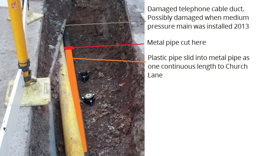

The medium pressure line installed through the village in 2013 to the nearby Science Park was 150 or 200 mm diameter. It was laid directly on top of the iron mains for the High Street .
so bernard did they change the house supplies in your village from medium pressure to low pressure
Along the High Street the old iron low pressure mains that were starting to leak too often were lined with plastic pipe slid into the old pipes . As far as I know the pressure on that section was not changed .
