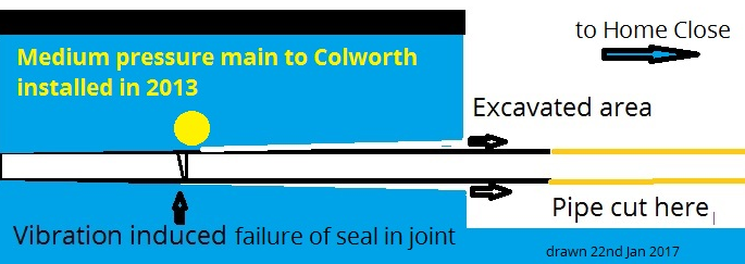

Year 2103 was the medium pressure line was laid through the village along the High Street to the nearby Science Park,

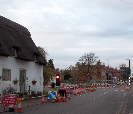

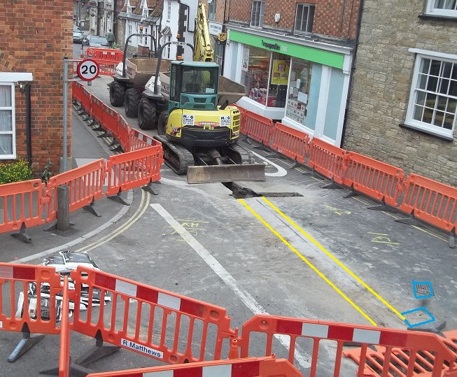

October 2017 was when several gas mains were upgraded along the High Street and in a side road
after this work in October 2017 there were frequent and persistant reports that gas could be smelt
These reports and futile searches for the leak continued until January 2018
Contractors spent about three weeks sniffing and cutting core holes in the High Street
At this point a strongly worded complaint was sent to the CEO of Cadent, this included a suggestion as to where the leak was.
This was the diagram of our prediction of what had cause the leak
and this was our prediction of where the leak was.

They arranged for Cadent engineers to come to the village to locate and repair the leak.
The engineers worked from 8 in the morning till almost 10 at night
The leak was less than 2 feet from where we had predicted it to be.

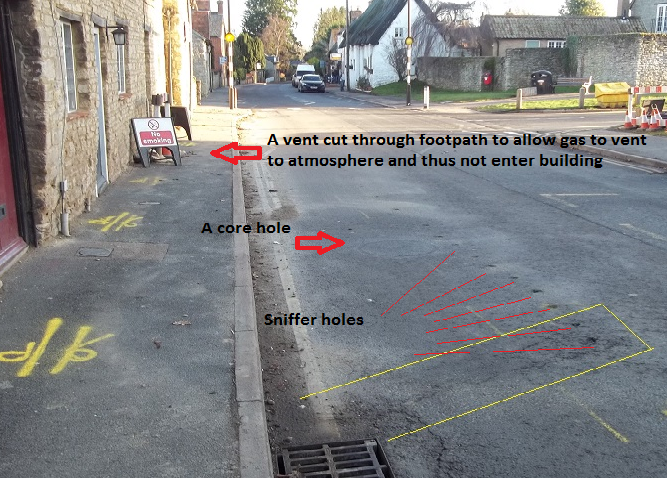

The continuing smell of gas and reports meant there were "gas engineers" (*) up and down the High Street for more than three weeks drilling holes in the road and sniffing for gas. We had a large core drilling machine in the High Street on two or three nights.

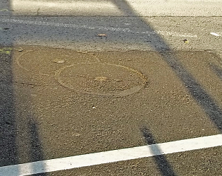

Two of the many core holes drilled in the search for the leak.
Some of the dozens of sniffer holes and the excavated vent to prevent gas seeping through the stone wall of a building.
