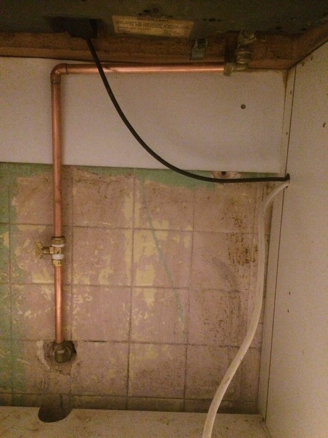

Gas Man Says built in hob should not have a flexible hose?
I'm in London W12. If any one is interested let me know. £100 is fair and reasonable.
I reckon you can do everything as is and without removing the kitchen units. The Oven pops out and the lead appears to be long enough to do so. I'd be happy to assist... with tea/coffee :)
I'll take out the oven tomorrow and get a closer shot of the gas connection to the hob if anyone is interested.

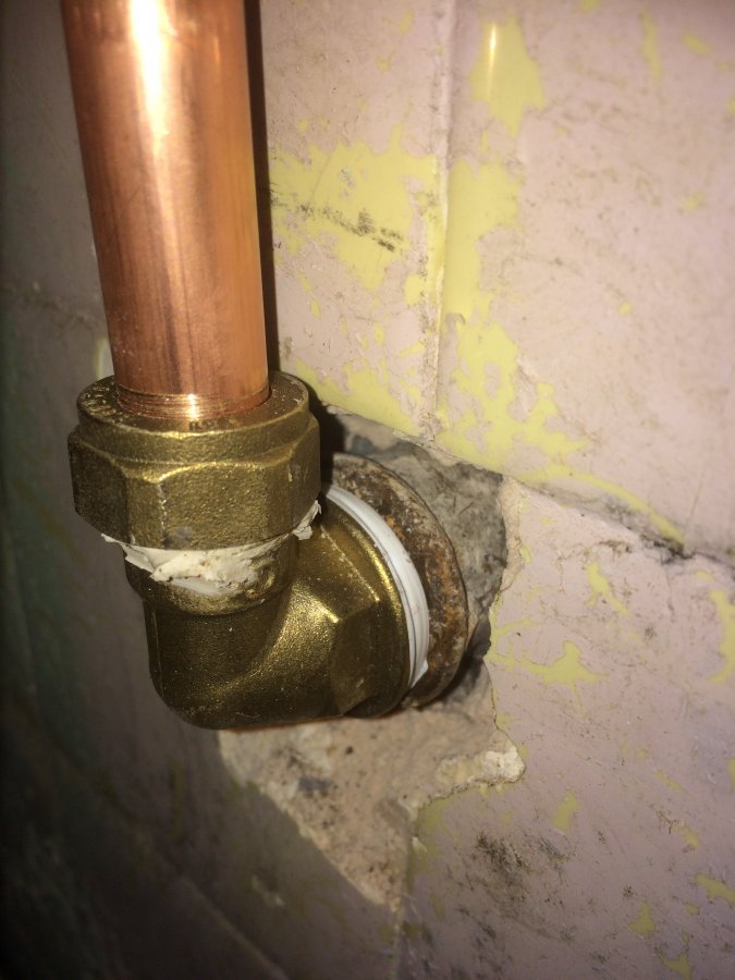

Regardless of whether the instructions allow a hose or not that one needs a repipe, it's not fitted in the way a flexible hose should be and is under strain.
I just hope that the PTFE tape on the threaded end is Gas Rated and not just regular 'Plumbers Tape for Everything'.
Generally it has an Yellow tint to easily identify it.
Patrick
Patrick
never noticed the yellow tint, except when on the roll:)
Just a month ago we had a flexible hose replaced with copper for a gas hob. It cost £65 and it was done done after we got back from work at 6pm.
:sick::sick::sleep::sick:Why do people put PTFE on the thread where the cap nut goes
