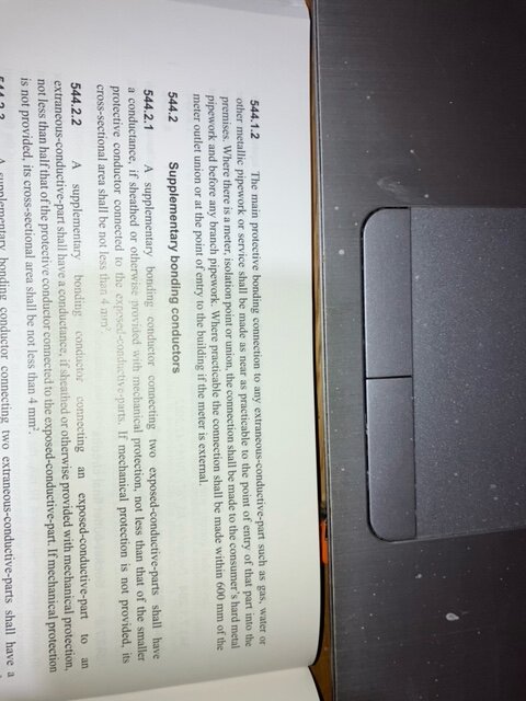

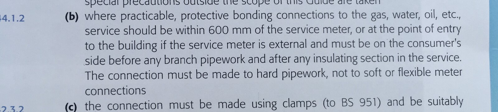

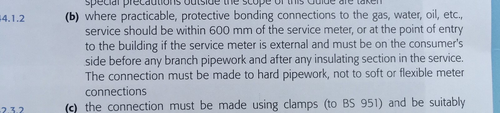

I am in the process of getting a Ohme home charger fitted and they have asked me to do an evaluation of the services to my home. They pointed out my external gas meter fitted 2 years ago is NOT bonded.
Given it was British Gas engineer that installed the meter, surely they should have bonded the gas meter?? He will have been a qualified sparky, so he was NOT following the Regs??
The metal pipe must be bonded where it enters the premises.
External meters do not require bonding.
Well, not according to the installation company. EV chargers are a different story entirely, and the meter requires bonding, external or not. Maybe you are a bit behind with the Regs??
I dont think it makes any difference really. I suppose when they install the Ohme charger they will do it to spec.
I did have to be De-Looped from my neighbours power. But we both now have a 3-phase supply. Cant do anything with it really. We need a smart meter for 3 phase. It would be nice...lol.
From the On Site Guide:
