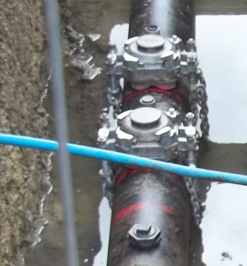

Do you mean you think they can cut into steel pipe?
Yes they can. A complex procedure using strap on gas tight adaptors allows for a hole to be drilled without any loss of gas and a balloon is then inserted into the pipe and inflated to block the pipe. The pipe can then be cut and capped. The balloon is then deflated and removed and its entry hole plugged.
These were taken when a leaky section of the gas main to the village was bypassed.

That strap looks interesting probably expensive but maybe cheaper in the long run?
