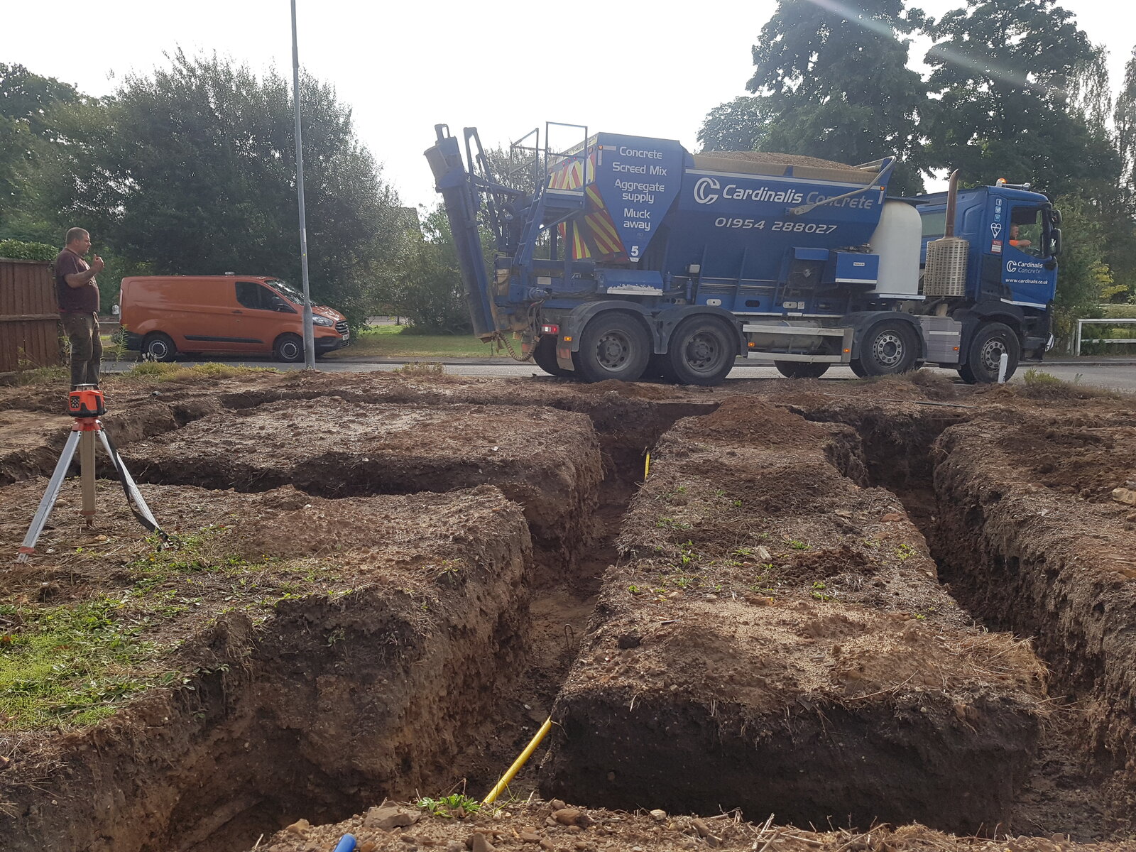

We had a services check on this site which came back clear. The site was the rear garden of another property.
