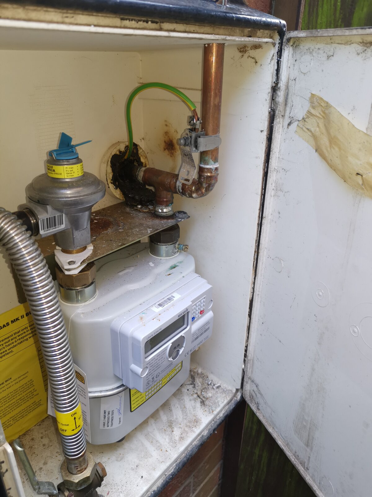

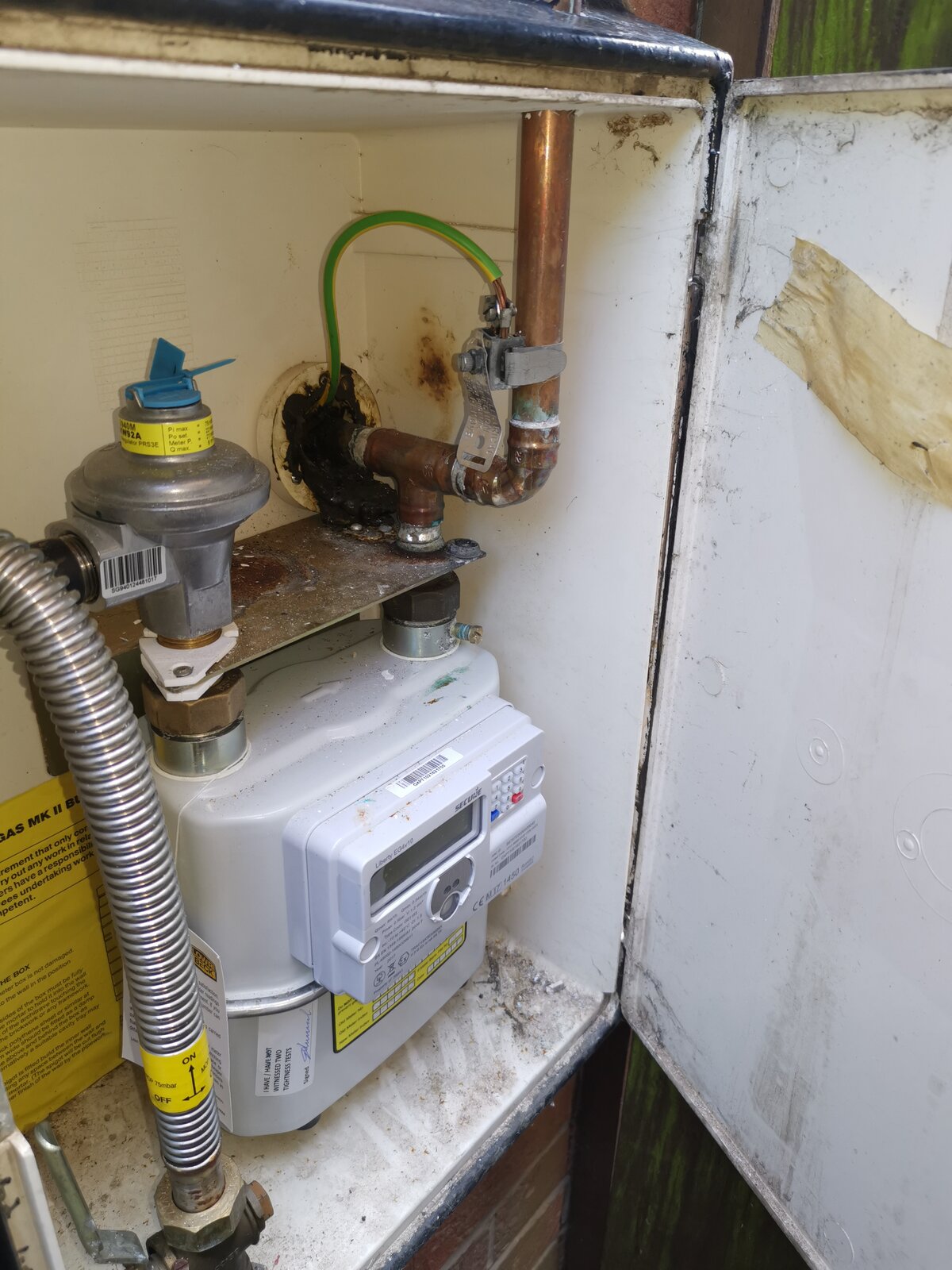

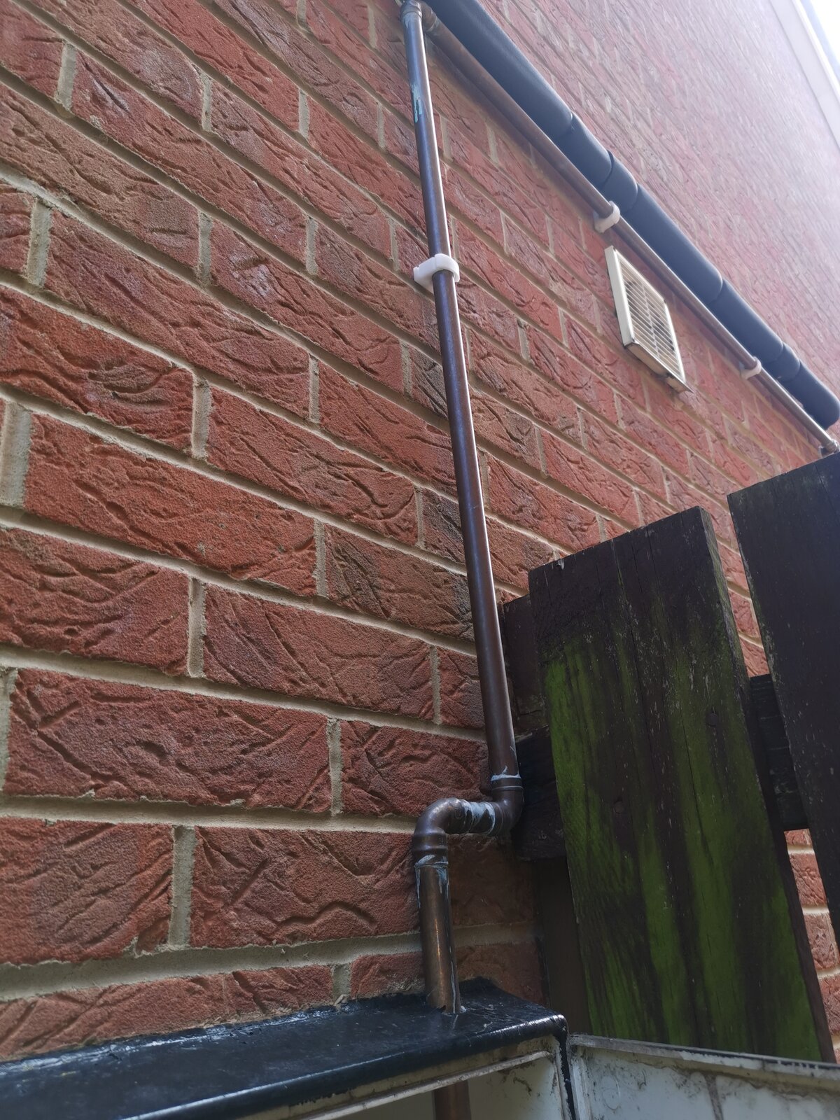

My new boiler has been relocated upstairs from the kitchen and the gas pipe goes up from the meter through the wall on the second floor and under the floorboards to the airing cupboard.
The old boiler was in the kitchen pretty much 1.5 metre or two from the gas meter.
Downstairs i have redundant gas pipes from old boiler, from the gas fire and i currently have a gas oven which im going to remove and get an electric one.
Looking at the pic is it literally a case of disconnecting that pipe going through the circle into the wall into the house from the meter and my whole gas circuit downstairs will be redundant??
I assume only the gas pipe going out the top of the meter is required for the upstairs combi boiler?

If your going to remove the gas cooker anyway, I would leave it till then.
Then you can get an rgi back out to remove that t piece and replace with a 90 degree bend.
You know the gas pipe is where it is, so no need to worry about it
Yeh im just wondering if that will be all they need to do from what you can see there? Only one gas line goes directly to the new boiler doesent it?
