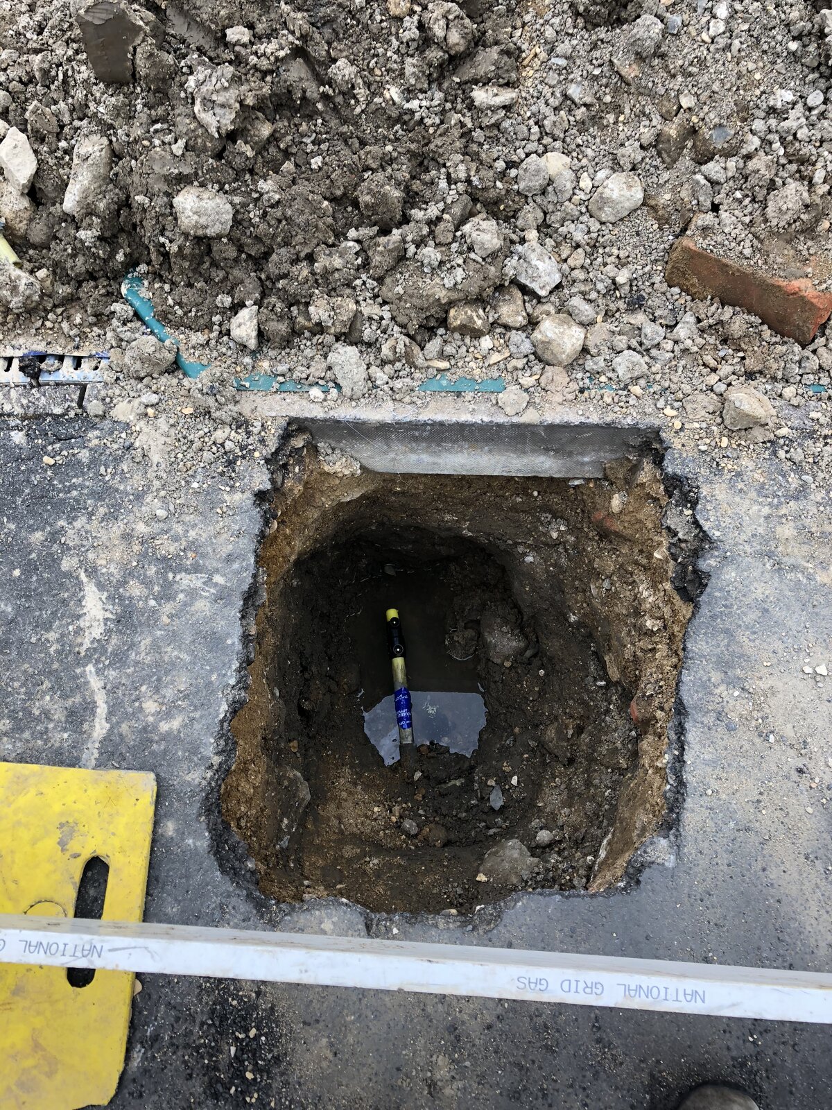

Home owner, and cost is significant , starts around £1500, but can be a lot more expensive , when a GSR repoerts a refusal to disconnect an immediately dangerous appliance, they get a referance number, from the transporter and that is their part finished , the responsibility is now with the transporter
A lot more common than you think, but when the transporter appears and tells them they will have to pay a very high fee to get it back on they suddenly change their mind

Because they then realise it is going off anyway, if they do it voluntary the cost to restore the supply is small , if transporter cuts off , involves a dig up and cap the supply, retoring is very exensive
they dig up the road and cap of the main...you are out of touch with reality...or a fantasist..
OK smart ass, the customer has refused them permission to terminate the supply, they have no legal right to enter the customers property,in this situation, so where do they terminate the supply then
