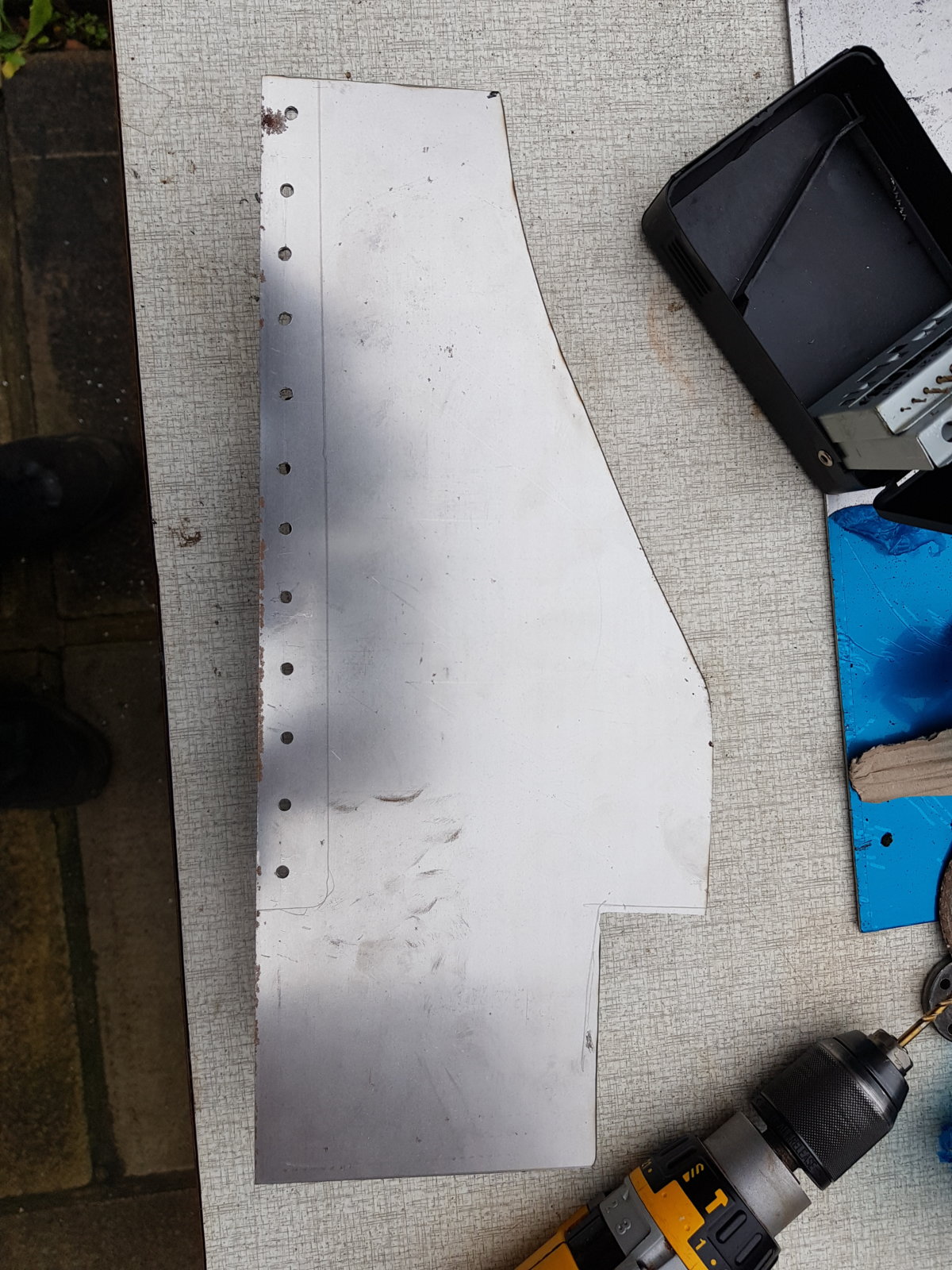

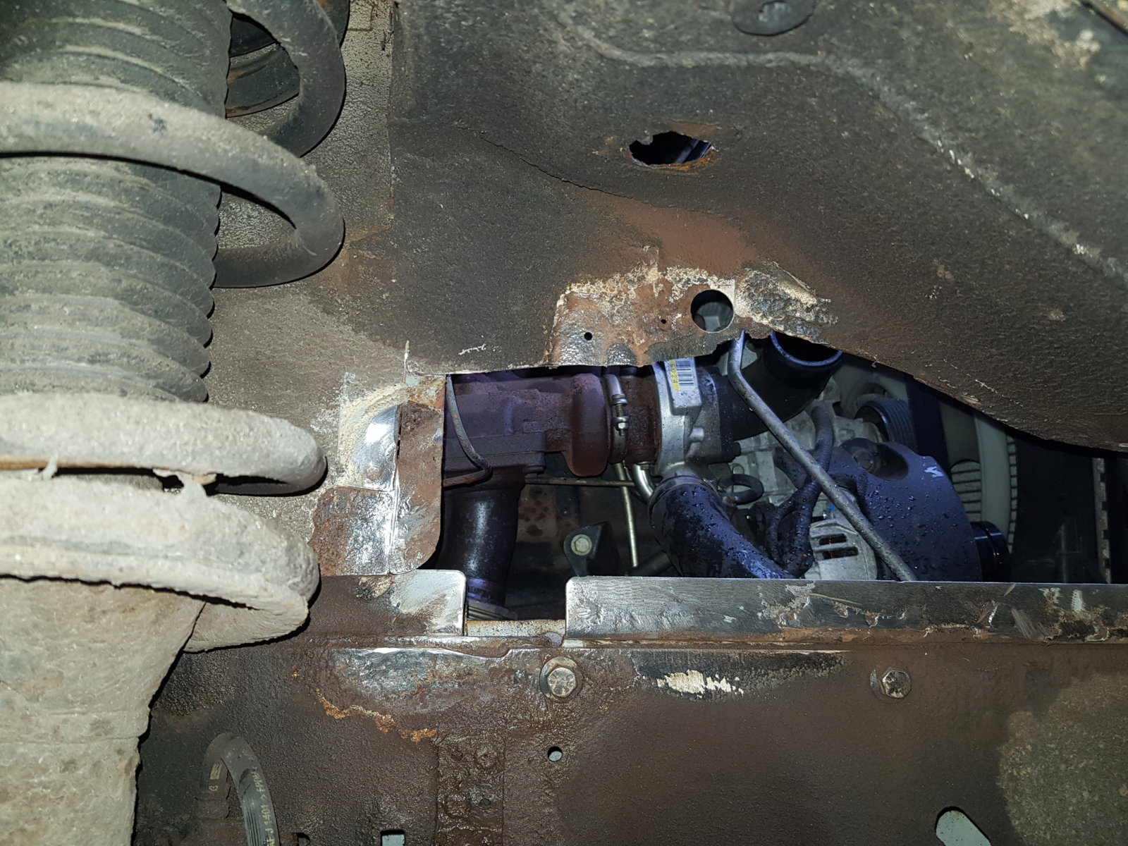

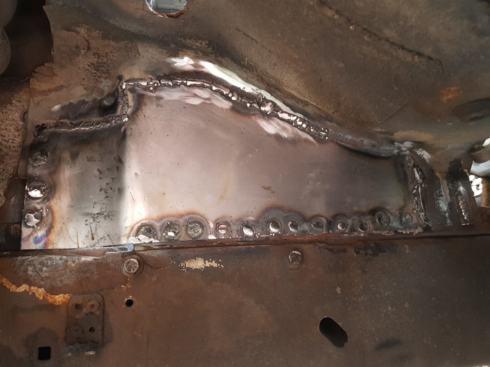

I was asked to help with a Ford Transit so I decided to have a go with a spool of 0.8mm SIP gasless wire.
I didn't change polarity on the welder, I didn't have any 0.8mm tips but I drilled a couple out to 1mm (will buy a pack of these).
The Plug welds were done on High power and went great, good penetration and no spatter to speak of.
The wing above had to be done on medium and low to stop blowing through the wing.
The new metal was 2mm thick, I gave it some grief with the hammer to bend it round and the welds were solid as a rock, very happy with it!.
That seam weld needs more penetration and must be complete all along. Get a bright torch and look through your joint with the lights off - there should be nothing shining through

I couldn't get any more heat in without blowing through the original panel. The seam was finished on the inside.
Will be having a go at the other side soon so will have another look.
Try clamping a chunk of copper somehow, not so easy like this but you could wedge it with a piece of timber from the inside. If you're usign Pub gas, this can be a problem, unstable arc which can be stabilised by turning up the volts then it starts blowing holes. Or are you using argon/co2 mix?

I'm trying out 0.8mm gasless wire, wasn't as bad as I was expecting to be honest. It does like more amps but the panel didn't!.
