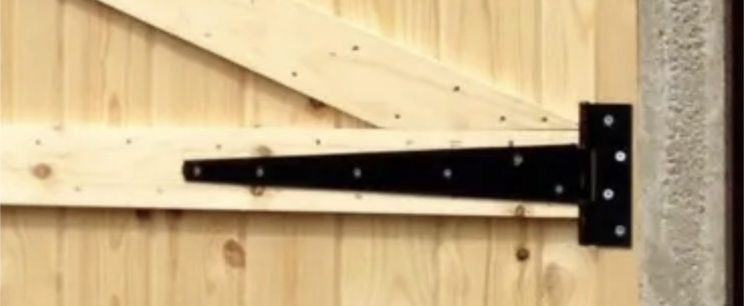

Hi

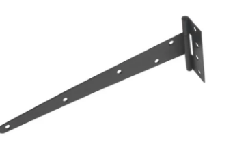

Can I attach gate hinges such as these directly in brickwork, instead of to a post which I need to attach to the brickwork? Is a post necessary, and if so, why (just curious, for better understanding)? This is for a short term thing (the gate will come off in a month or two), if the easier option will hold for that long, I'd prefer that.
Many thanks!
Not advisable. You'd struggle to drill the holes accurately enough in masonry and they would probably pull out in a short period, damaging the masonry (I have seen this tried) - the screws that the hinges are designed to work with are something like 4mm diameter

Reasons against
Gate won't open to start with. Gate will be tight to wall. Gate will need to be 75mm ish away from wall like with a post.
Wooden post is used to spread load and maybe just 3 thunder bolts or 3 resin bolts.
Look how this hinge is below. Will need to be flat not at 45 degrees like your picture.
There are wall mountings hinges though holding gate away from wall.

Thank you both.
I was going to put the hinge at the end of the wall, so the gate when closed would sit flush with the wall, not perpendicular.
Still, I take all your points about the weight distribution, holes in masonry etc., and I can imagine how that many holes at the end of the brick would be even more likely to cause damage. So, wooden post it is :)
Put wood batten down wall edge fixed to mortar joints.
Can fix to that. Easy to make good when removed
