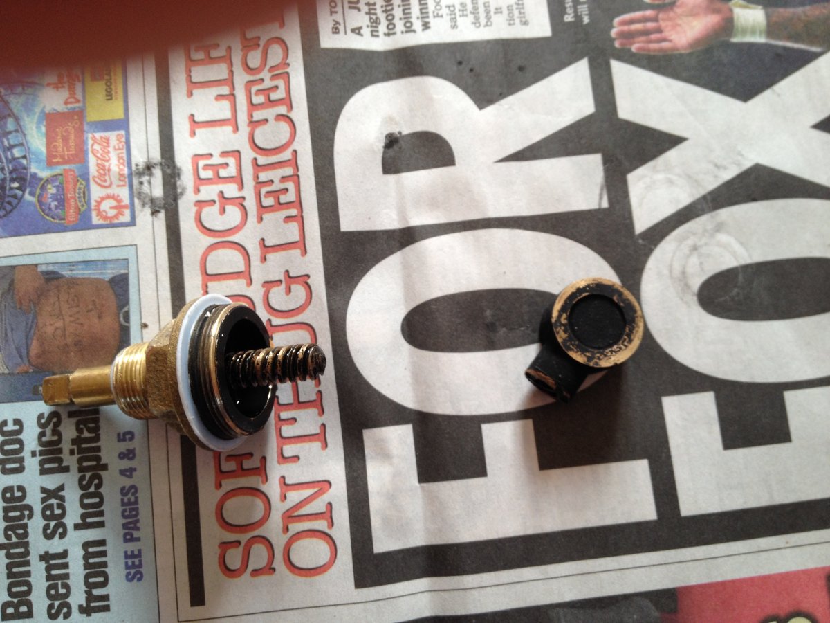

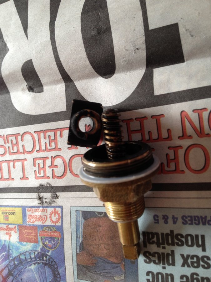

Should the gate screw off the stem completely? No sign of broken parts.

Yes, but what you don't know is if the thread is actually correctly firmly locating in the female part, it could be stripped.
But I still don't think you have any water on the pipework side of the valve.
But you don't want to unscrew the nut to check as we have asked you to do.

it screws all the way in and out (off completely), thread is fine.
what i don't get is how does it open/close the gate because surely all you doing to moving the stem in and out of the gate without it actually turning in the valve?? i assumed the gate would be fixed to the end of the stem, therefore turning when the stem turned?
i definitely have water the pipework side because i drained it all out!
You drained it in drips you said.
It should be coming out at up to 12 li/min.
When you drained it out is the header tank empty?
The male thread "pulls" or "pushes" on the gate as it is turned.

header not empty because i blocked off the feeder outlet. i calculated what i thought would be in the pipework from header outlet to bottom pump valve which was approx. 1.2lt and that's about what i drained out. once it stopped i took the guts out of the valve (leaving valve in place).
i just can't get my head round these gate valves, they don't appear broken to me, yet they're definitely not opening up when in place?

The valve stem should not rise or fall when turning. That means that the "gate" part of the valve moves up and down along the stem when turning. Put it back together and observe the action. If the stem moves up and down, then the valve is broken.

think i understand the gate now, so it's moves up and down the shaft. i was thinking it turned through 90 degrees thereby allowing water to flow either side of it!
so if it moves up and down that must mean the square drive but turns a few times round to fully open/close the gate?
mine was only turning 90 degrees (very small movement) hence why i thought the gate turned the same. i didn't want to force it round for fear of breaking it.
should i force it to get it turning to open it up?
