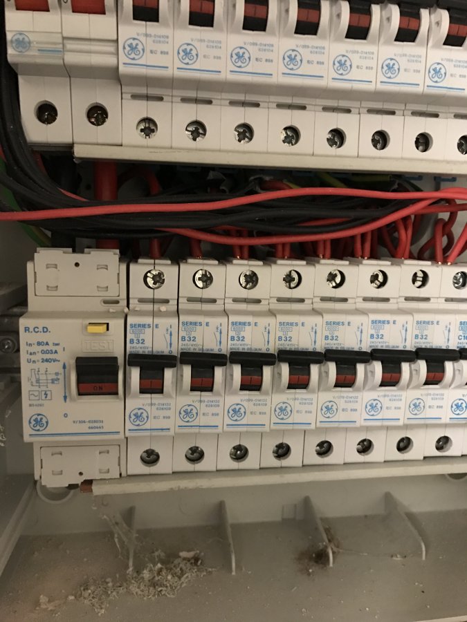

Wholesalers have come up empty, as has the box of dreams and google.
Anybody know where I can find two GE MCBs in >50A or, failing that which MCBs are the same but branded differently? I know the old Steeple range was GE rebadged but they seem just as hard to find.
We need to add a couple of boards where henleys aren't practical and the guy won't go for a board change, so he's gonna end up with 4 consumer units in his cupboard!
OOI one of the boards isn't even a GE board, it's just a dual row enclosure so not sure where you'd stand on 'type testing'

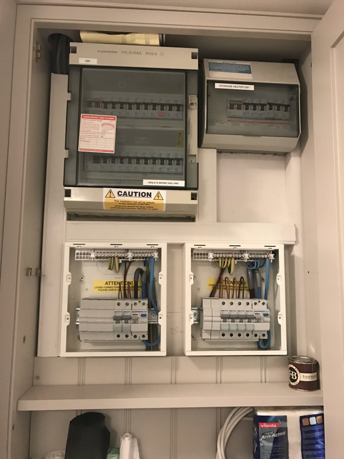

Don't know about the rating, have just looked at my photos again, and it's actually a Vynckier "Fix O Rail" which I understand is a GE brand/rebrand so I suppose is type tested.
We want to keep it GE if at all possible, just running out of time and options. Will post a photo that might make the problem more obvious

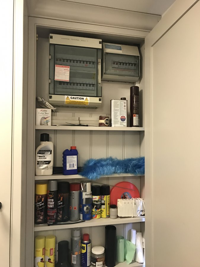

Wall on the right is an external wall with meter cabinet in it, board on the right is E7 left is 24/7.

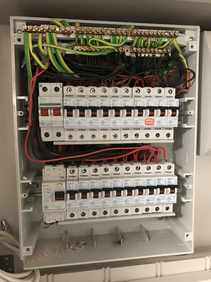

Need to get another 5 or 6 circuits in both boards which are full, so will need another board each, customer won't let us change existing boards but will let us trim the back panel of the cupboard.
Obviously no access to break into the tails.
Any other suggestions?
Is there enough room above the main switches to split the tails inside the boards with some insulated line taps or similar?
Will 40A MCBs be capable of supplying the loads on the two new boards?
If not, maybe some of the existing smaller loads can be moved to the new boards, and the new circuits fed from the old boards.

The 24/7 board has a bunch of lighting circuits and some other stuff on the non rcd side, and then the RCD side is all socket circuits, a cooker, hot tub and a shower. New circuits are 2 x socket radials and a lighting circuit. One socket circuit is for an as yet, unbuilt extension so unknown load but < 20A. Not much point swapping socket radials for radials.
Would possibly be ok on a 40A, but leaves literally no room for expansion - clearly the attitude the first guy took.
Was contemplating adding an RCD to the top row, doubling up some lighting circuits and trying to squeeze the new circuits in there. But an RCD + 3 circuits means I'd have to double up every lighting circuit, and it'd leave all lights on one RCD and all sockets on the other. terrible idea.
It just needs a nice big triple row 24/7 and dual row E7 but the guy isn't interested. He's not short of ££ but doesn't want to spend it on new boards

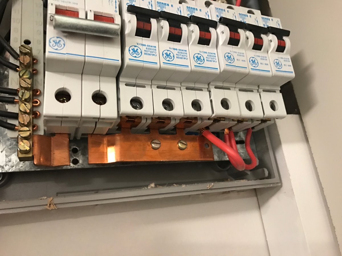

Found this beaut in the process too. Incoming Neutral was loose too, board was a storage heater all by itself, proper warm but seemingly no damage
