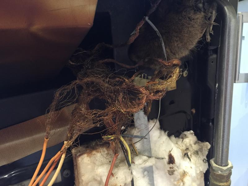

RCD will not stay on
Fair enough - and nothing else which is 'always on' even when all the heating bits of the cooker (oven, grill, hotplates etc.) are turned off? Were all those 'heating bits' turned off when you got the trips, particularly the tripping of the MCB?
Not that I'm aware of. Nothing was on, the two ovens have the usual selector and temperature knobs each (everything off/set to 0).
I was afraid you would say that! That obviously makes it less unlikely that anything within' the cooker is at fault - suggesting that the most likely place for the problem is where the supply enters the cooker or somewhere else in the wiring of the cooker circuit. Whatever, disconnecting the cooker circuit at the CU in the way you propose will get rid of any of those problems, and allow you to get the rest of your electrics working. The first thing for an electrician to do is presumably to get the cooker disconnected from its supply, and then test the cooker and the cooker circuit wiring separately.

Well, thanks to the excellent advice and reassurance received here, I now have electricity back in my house! I was able to disconnect the cooker circuit with no issues -- I was very careful every step of the way, and ended up with a working RCD!
So thank you very much everyone for your input, I really appreciate the help!!
Now I'm off to find an electrician that can diagnose both the circuit and the cooker...
That's good to hear. In fact, it recently occurred to be that you really only needed to disconnect the neutral - since, with the MCB 'off', the live was already effectively 'disconnected'- apologies for not having thought of that before!
So thank you very much everyone for your input, I really appreciate the help!! ... Now I'm off to find an electrician that can diagnose both the circuit and the cooker...
You're welcome. Assuming that it's fairly easy to get at the connection to the cooker, and electrician should be able to ascertain very quickly whether it is the cooker or circuit which is at fault ... and then take it from there. Please do keep us posted, since yours is a rather unusual problem, from which many of us can probably learn!

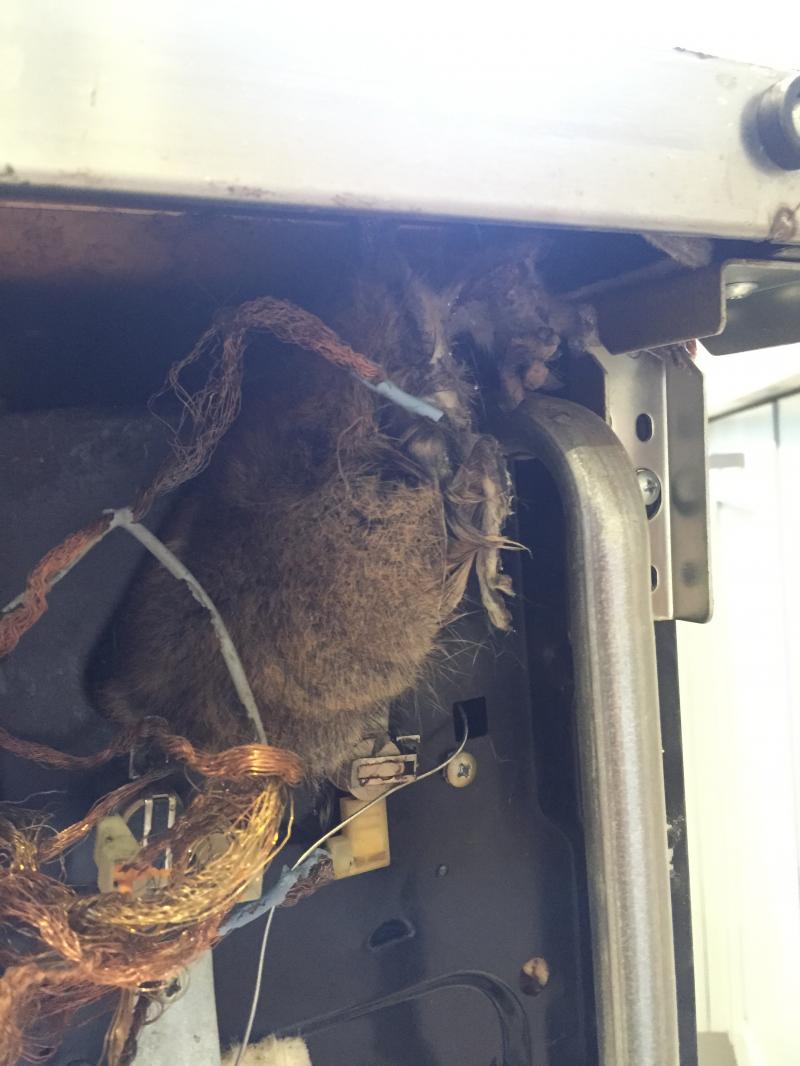

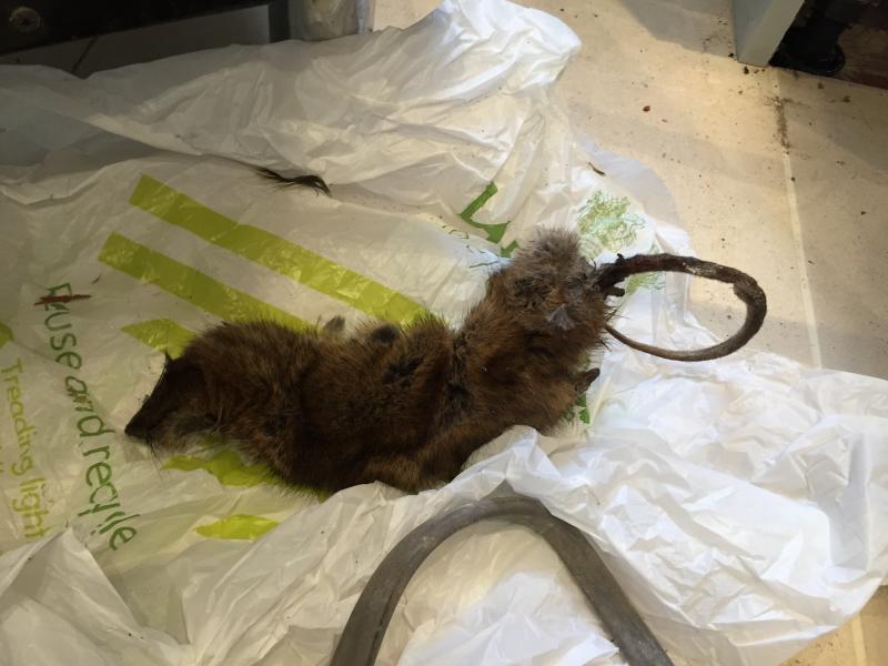

No... just took me 3 months to upload the pics from my phone so I could post them. The smell was horrendous though!
