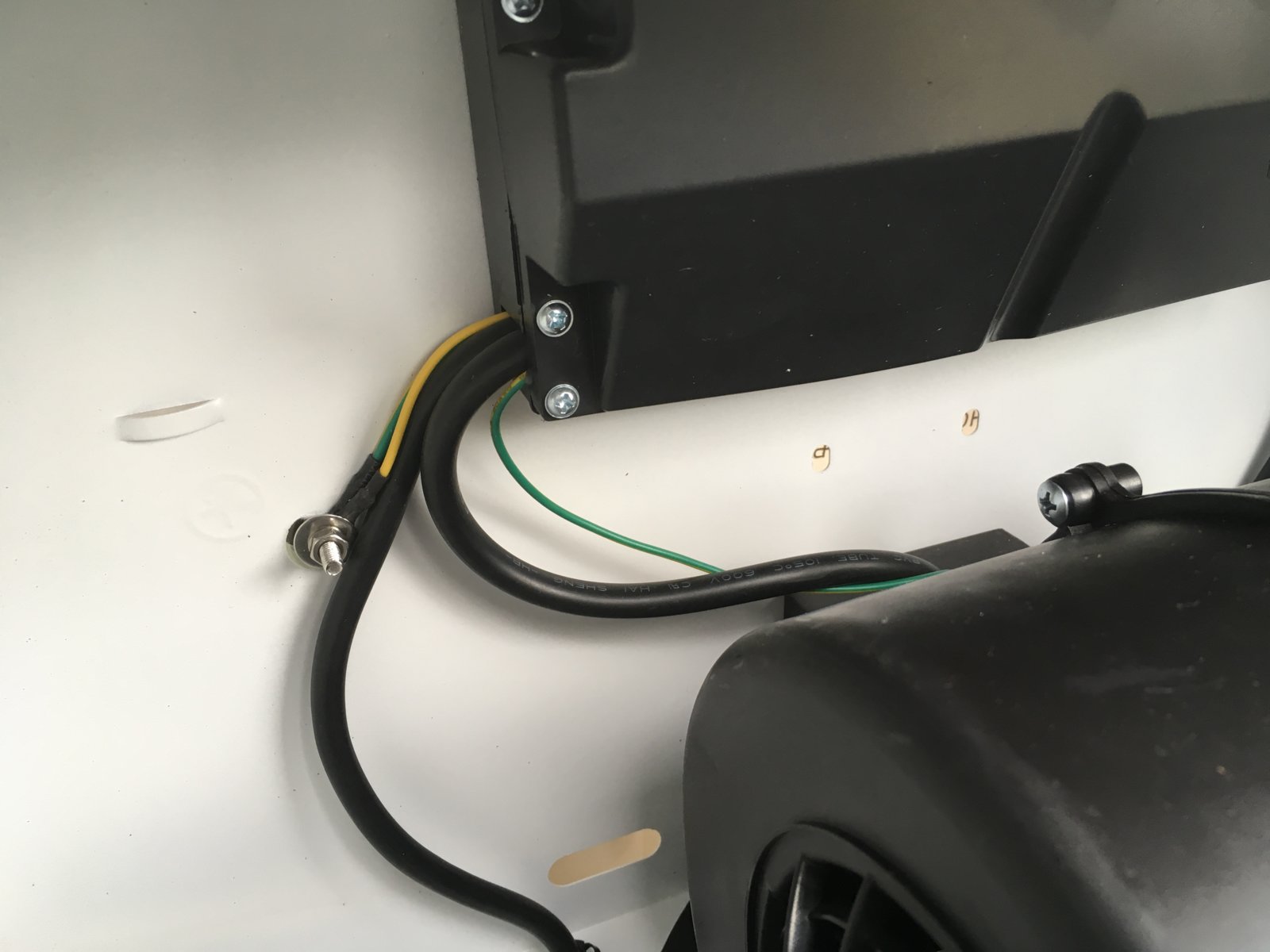

Look inside the hood where the flex enters, you will probably find that it is still a three core flex and completely fine to wire into an FCU or a plug if you already have a 13a socket above the cupboards.

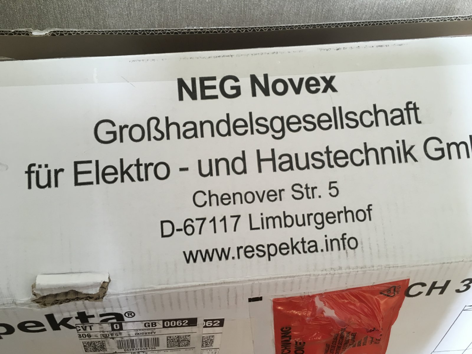

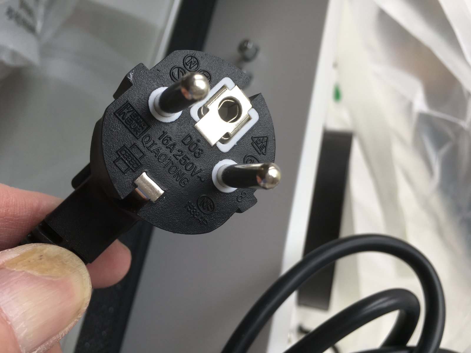

Ok to answer some questions I hope I’ve attached photos ok (not done it for a long time!)
Photo of the actual plug. Photo of how the cable wires into a box inside the hood (that could be a distribution box as there are LED lights as well as the motor). Finally a photo of the box showing the manufacturer.

That is a CEE 7/7 plug, it combines French and German and since the French CEE 7/6 plug is polarised it is permitted in the UK. A CEE 7/5 socket may not be easy to locate and would need a FCU to use it.
You have not answered the question was it from UK or German supplier.
