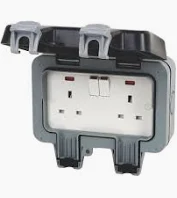

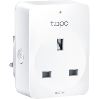

My problem is to find some thing which will plug into a water resistant socket 1700613950809.pngthe normal socket used will not allow the use of controllers. I do use smart adaptors indoors 1700614139833.pngbut outdoors I have used smart bulbs as they fit in the carriage lamps with no problem.
The other option is to supply the socket with a smart adaptor, my outdoor socket is plugged in indoors so easy enough to use the adaptor indoors, but I want the second outlet for other items, so not so easy.

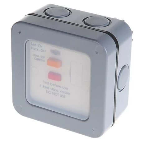

I've decided to take a fused spur off the Socket ring main in the garage.
I've ordered an external Fused Spur with RCD.
Whilst appreciating that is intended as an external unit, I would suggest you mount that indoors, where it is much less likely to suffer water ingress.
Fair point but thought I'd mount it outside so I don't have the chase the internal wall and the CU is against the external wall so and easy drill through.
Ah! Yeah. See you're point.
I guess the only additional reason would be that it trips faster than the one on the house CU... For convenience... But perhaps no safer
You dot need or want that RCD unit at all. You said in post3 that you already had one in the house CU.
Which means a fault in the gazebo could suddenly and without warning plunge the house into darkness. A hazard to people in the house.
Feed the cable to the gazebo from its own RCD and MCB ( or an RCBO ) in the CU in the house to avoid that hazard,
